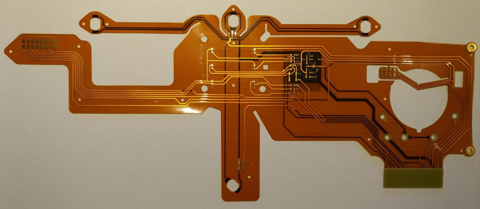

Hello everyone,
I have redesigned the foil for the '86-'91 vanagon. As you are aware, the original VDO blue foils are becoming brittle and the copper has oxidized to the point where connections have become unreliable and even delaminating from the substrate. This new design uses far superior materials such as Kapton for the substrate and all connections are gold plated. All the components are surface mounted so no more of those crimped connections. These are prototypes and we will be testing shortly.

This is great and I appreciate anyone doing something new and helpful to our community. Thank you!
I am curious what made you pursue this project given the current solutions out there?
Cost is the biggest driver. Plus having the tools to design this. In the end, I wanted something that was "drop in" compatible.

now that is fucking rad!
i have the foil fix kit already installed which works fine, but what an ugly mess that thing is with the box and wires.
i really like this solution, and would buy one just to have on hand
Thanks. That is the other reason for doing this. A much cleaner installation.

This is very cool. Thank you for doing the R&D you've done. I'll be interested to read further re: Kapton but it seems (Dupont ?) has improved it over the years.

Very nice work. I like especially the way you have used both sides to keep the electrons from having to wander halfway around the world so they could avoid crossing the other paths of some of their buddies.
And installation has to be far simpler than the "other stuff out there".

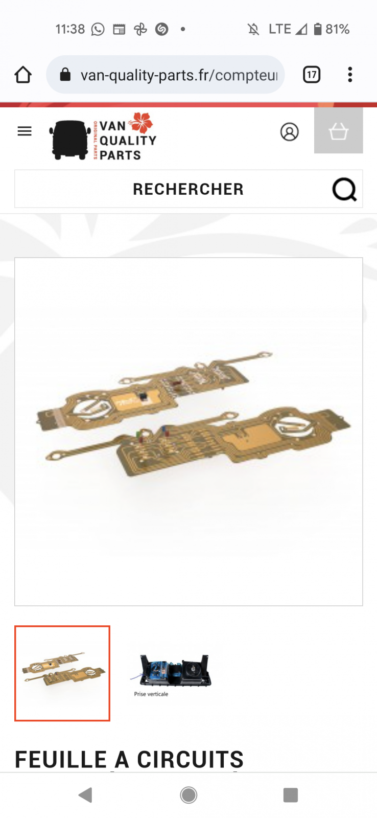

Van Quality Parts in France already has these....
Yours sound better quality though....So many offers these days....
Not quite the same. The French site seems to be offering (199 euro), foils pre 86, diesel and gas.
The new foil version is for 86 and newer, gas.
Neil.
Kapton is just DuPont's trade name for polyimide. And yes, one can call it a miracle material now. (Quoting someone else).
The base is Kapton and there are coverlays of Kapton over the copper and any exposed copper is gold plated

I'm in also and ready for the beta test program or waiting list. I have a small pile of clusters waiting to be repaired. great work. what line of work are you in that puts these tools at your disposal?
I am an electronics systems designer. There will be other products coming but I will focus on this for at the moment

The French version is for 1.6 D and 1.9/2.0 from 1979 to 1985 only.
