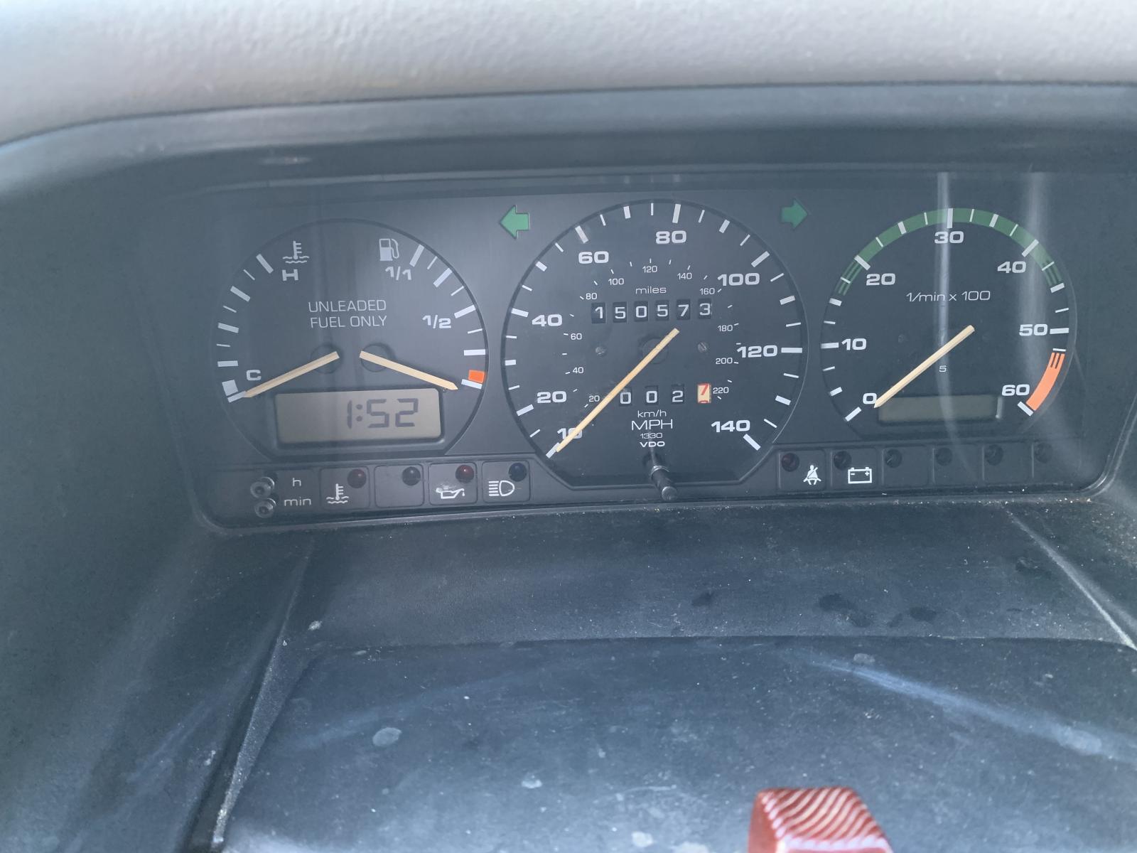

1993 MV - I’ve got the instrument cluster apart and I have removed speedometer gauge that has the odometer and the trip odometer. I’m trying to access the little gears to make sure nothing is loose. Right now, I can’t remove the face plate because of the needle. I’m pretty sure it’s a gear out of joint because the speedometer works. Every once in a blue moon the odometers will work. You can even get it to tick off a couple of tenths of a mile if you tap around it. My guess is a gear is loose or out of place. I feel I’m pretty close. Any advice on how to access the gears?

If it's similar to a vanagon, there are a ton of threads in that forum for odometer repair. Usually, all you have to do is rig a way to put pressure back on the gears, again look in the vanagon forum for a more detailed explanation, I used the paper clip fix shown there successfully for years.
To get the needle off, a fork makes an excellent lever.
So, long way of saying- look in the vanagon forum, see if the photos there match what you are looking at, proceed from there.

Well, it's finally fixed but not without a couple of issues. The issue appeared to be a green gear that had gotten lodged out of place. I pushed it back into position. I didn't see anything that is supposed to hold the gear in place but it seemed to be pretty hard to move. Hopefully it stays in place. If not, and if I have to do it again, I will add something to keep it in place.
As for the issues, the first is a simple issue. I put the steering wheel back on at a bad angle. I figure I will fix that tomorrow. The other issue is that in pulling off the needle, I managed to break the speedometer needle. Ouch! The first thing I tried to do was to superglue it back together but it just wasn't holding. In my attempts to do so, I noticed that the needle didn't look like it was made of plastic but actually looked like it was made of wood. This made me think that it was similar to a toothpick or a wooden skewer that you use for cooking. I pulled out a toothpick from our kitchen and decided, in for a penny, in for a pound. I ripped off the rest of the speedometer needle and glued the toothpick in it's place. I had to cut it down a little bit because it was a little too long but overall, it looks pretty darn good.
Fixing the odometer was actually one of two things I was trying to fix. The other issue is that the horn wasn't working. The problem became very apparent when I got the steering wheel off. There is a brass tab that was bent out of place. I bent the tab back into place and now I also have a horn.
So overall, not too bad. Odometer and horn are now working.
Before and after Pics of my toothpick fix for the speedometer needle.
