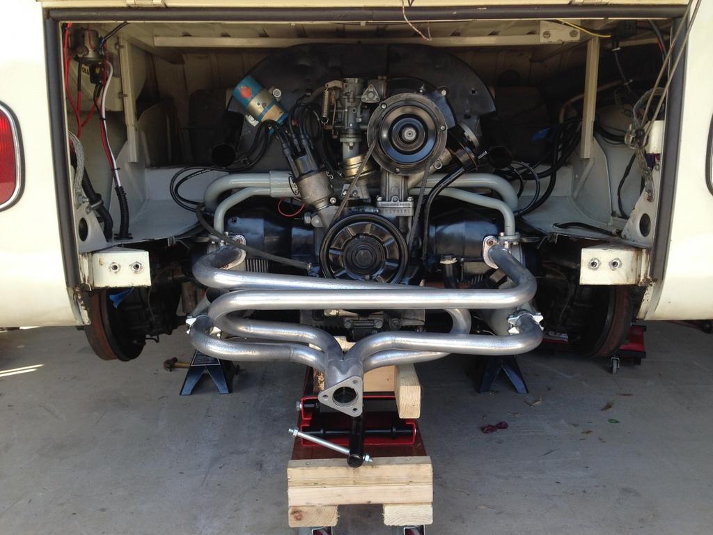

Here's the issue:
The upper / left bolt connecting engine to transmission. I've never seen this and I'm puzzled.
When I try to set a socket on the head of the bolt in this position, the socket only sits about half on the bolt. To my bad eyes it looks like the are a couple little nubs at the bottom of the bolt hole.
First thought was the nubs hold the bolt head from spinning when you nut the other side. That's not right, the bolt goes through the transmission from front of the engine and there is a fixed cap nut that is threads into on the engine case.
I have tried to knock the nubs off with a long screwdriver and mallet. The nubs won't move. I'm taking a dremel tool tomorrow and tru and grind the nubs if I can get up there behind the clutch lever. It's tight.
Last option is go after it with a long extension and short ratchet. Maybe the amount of purchase on the bolt will be sufficient to loosen.
Anyone have an idea on the "nubs"? I shot 20 pictures and didn't get anything that worked. Too confined to get in three for a clean shot. Tomorrows another day.

Carla, is was as you predicted. The nubs were there to hold the bolt on one side but the other was the fixed cap nut. That said, the only way to get the bolt out was to
grind down a socket, use a long extension and be patient.
One ratchet click at at time and I finally got it loose to finger the rest. After that the engine jumped out of the back and the morning was over. Pulled the gas tank and did a bit of tidy up and called it a day by lunch.
There was a washer on the bolt head that was the same size as the nut. I think I'll find a thick washer and see if will stand the head of the bolt off of the nubs. There is more than enough thread to try.
All and all a successful morning.
Tools of extraction.
Picture of the nubs, left ,upper, engine mount.
Engine out, ready for dual carbs
Bas tank out ready for rebuild and paint. Thanks for the advise and insight everyone.
