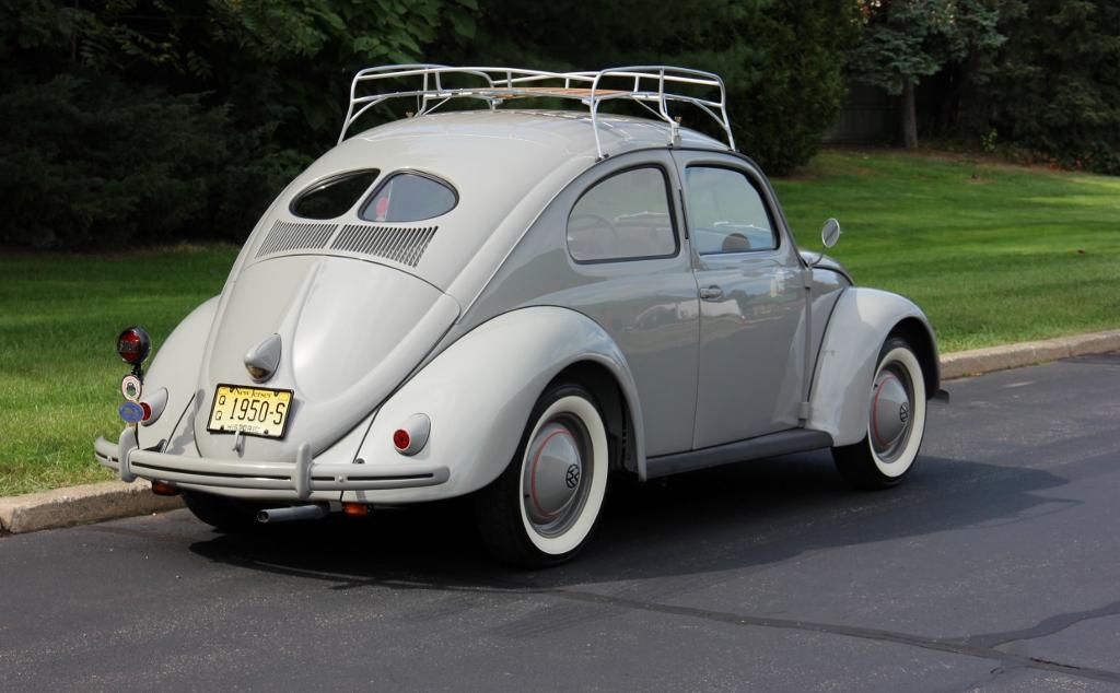

For a muffler with that 1500 engine you can use an EMPI single-tip style. The single pipe goes down below the apron so that there's no cutting the apron needed. I installed this onto my '77 Beetle which also had a replacement apron with NO exhaust cutouts, and it fits well under the body/apron edge.
A friend in New Jersey has a '50 Beetle with a later engine and he used this same muffler also, on his dual-port engine (Bob Cropsey gallery).
