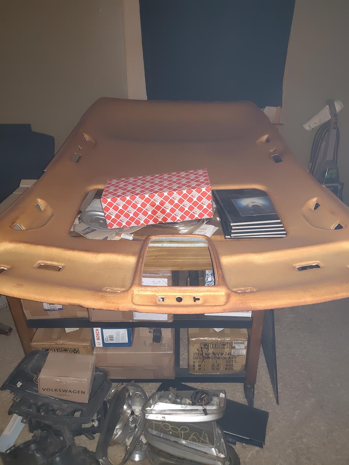

PostPosted: Fri Dec 09, 2022 4:36 pm    Post subject: Re: Saggy headliners Reply with quote
Here's the golf headliner waiting to be recovered
