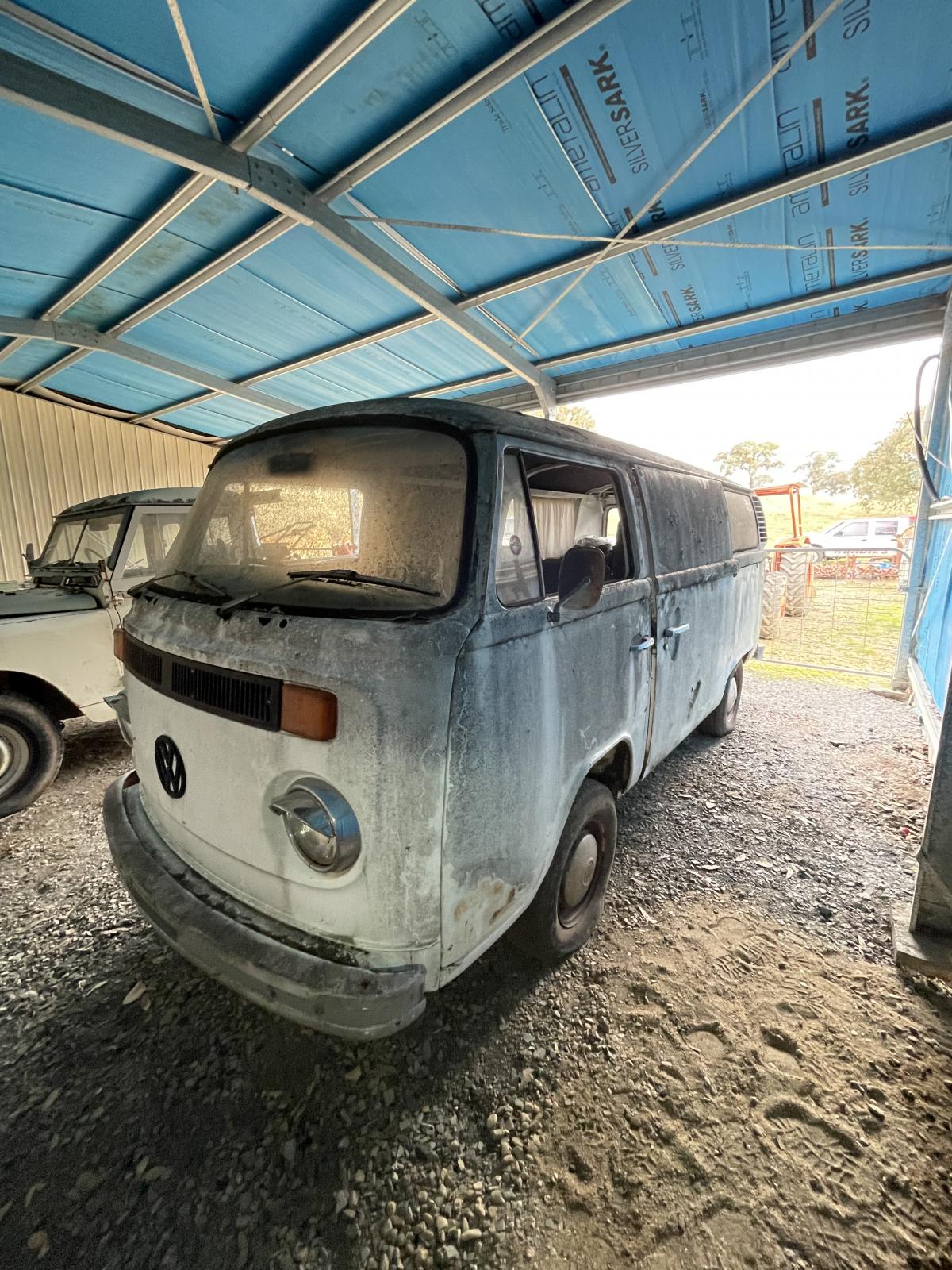

I thought there was a complete vw list here somewhere but couldn’t find it
It looks like a 1600 upright but not sure?

It is possibly a Volkswagen replacement engine. https://www.aircooled.net/vw-engine-codes/

It's a late 73 1600 bus motor according to this: https://www.thesamba.com/vw/archives/info/chassisdating.php

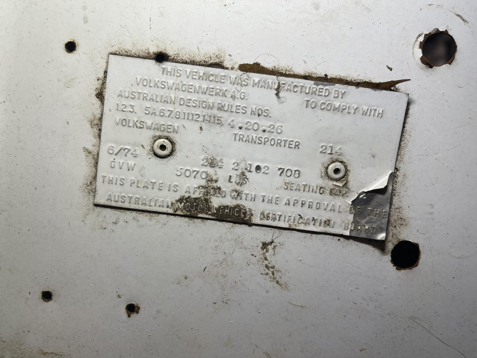

Bus was made in 6/74 for the Australian market. From the list Mark linked, the AS code is 1974. Looks like it was an upright 1600 engine. If you want to know if it is the original engine, search birth certificate. You can pay to have the serial number researched, along with the engine number, and they will give you info on the bus and confirm if that is the original engine number. They will not give you the original engine number, just a yes that is it or no it is not.
