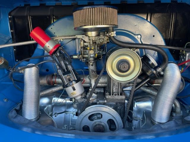

I have a strange problem with the carb on my 69 T2 bus. I have a 30P carb.
It looks like oil is seeping from the oil breather hose that goes from the oil fill tube to air cleaner (I think this is called an oil bath system). It also appears that oil is getting into the carb.
Another possible related sign: The motor bogs and has a "flat spot" when accelerating from a low RPM condition. Even has a backfire-type sound when this happens. Only under load. The idle is fine.
Any thoughts? Need help with this one. Never seen anything like it.

a. Post a picture of your engine setup, that would help.
b. Flat spot? What distributor do you have?

Photos of my engine setup include an EMPI electric fuel pump installed. I followed installation procedures. Hope this is correct since I haven't done one of these before. Placed the fuel filter inside the engine compartment for easier access. Breather hose attached to the air cleaner is shown.
A PerTronix electronic distributor is used as well. I plugged all the vacuum ports on the carb with new plugs. I checked the intake manifold for vacuum leaks as well as other potential problem areas. None were found.

You are dumping your blowby onto the base of the air cleaner where is will settle, pool, and eventually drain down onto the carb. One solution is to dump it into the top, positioned so it will go directly down into the venturi.

And one possible source of that flat spot is that distributor with no vacuum advance. Looks like a 009 clone? And someone soon will chide you about having both an electric fuel pump and having the fuel filter inside the engine compartment.

You might be right about the vacuum advance, since mechanical advance is only based on RPM. It's independent of load/demand, whereas vacuum advance is. I might "change gears" and flip to vacuum advance to try solving the flat spot. But I'll play around with other things first before doing so. When I got the distributor I believe,yes, it is a 009 clone.

One thing I see is the fuel line going through the breast tin without a grommet or other chafe relief. Not trying to trip you up, just had a bad experience once. Once.

I've seen metal lines cut thru by the tin. Another solution is a double nipple that is bolted in.
Also - the danger of a steel braided line is that one cannot see it aging. Be sure to change it at the same schedule as any other line.

Get rid of those toy clamps , too for closed band Norma, ABA, or my favourite (name banned for overuse)

On the stock Bus the oil vents into the air cleaner 60 cm away from the engine. The mist has a chance to accumulate and collect in the air cleaner housing. A paper filter will soak it up and gum up the carb
The 009 , particularly a clone, is a crappy distributor for a Bus and will give it a flat spot.
Solutions...back to stock parts

The vacuum only distributors on the single ports carbs were horrible too. Zero centrifugal advance, so the dizzy didn't adapt to rpms.
I can't tell if that is a stock carb from the pic (on my phone) but the stock ones didn't have enough vacuum to use an svda. (edit: has a shutoff vavle, maybe 30/31?)
Out of the two terrible options, I'd run 009 over vacuum only dizzy.

If you want to keep the air cleaner as is get 3 feet of that same size hose and route it with a loop. It will allow the oil residue to drain back and the air cleaner to breath without oil.

That’s an h30/31pict, so the vaccum-only distributor is a perfect match if you want smooth driving in all weather. The carb uses a combination of vacuum sources and does in fact advance with speed under load. The SVDA is another popular choice, which you can run off of the diagonal port on the rear of your carb.
You’ve got options.
