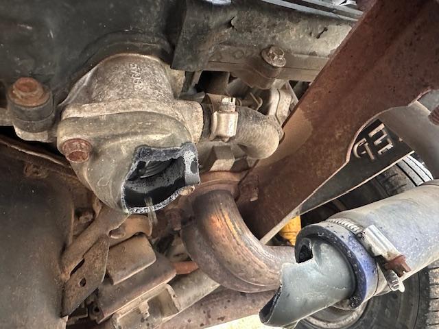

Well I wrecked my thermostat housing turning around on a bumpy road.
Was able to find a replacement at O'Reileys and performed a coolant flush..
But I broke my flimsy plastic South African grille pulling it off to get to the radiator.

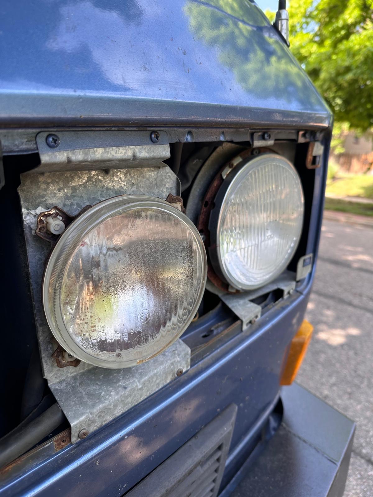

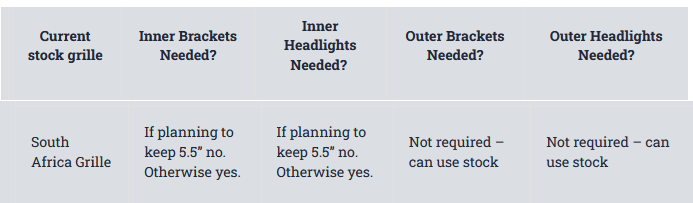

So here is what I'm working with
Does the S Tacoma grille fasten the same way as all the other grills? Through the clips?
It looks like for the S Tacoma setup I will need to replace my bright lights with 5.5" lights instead of my 5.75" ones.
For the 80-85 stock grille setup I would ditch the hella highbeams and replace my outer hellas with some H4 E-code lamps and different wiring?
My current brackets would work with either setup right? Just need some clips and radiator clip? (that broke too)
Looking like 4-500 vs 7-800 with tax and shipping potentially?
Thanks for the help guys
mojavmusic.com
View user's profile Send private message Twitter Instagram YouTube Gallery Classifieds Feedback

PostPosted: Wed May 28, 2025 11:00 am    Post subject: Re: Broke my South African Grille Reply with quote
No wiring change, you just keep your outer lights, they're common to both set up, replace the clips if needed for the grille. Done.
These inner lights, even made in Germany were so bad, it's unreal.
I adapted some cheap inner lights I found to get rid of them.
I grease the pins on the grille to avoid ripping it out.
The Tacoma grille has stainless pins and is much beefier in itself.

PostPosted: Wed May 28, 2025 12:20 pm    Post subject: Re: Broke my South African Grille Reply with quote
so according to this bit I'm fine with my current lights, just get some clips? This seems the most straightforward as far as the durability I was looking for
