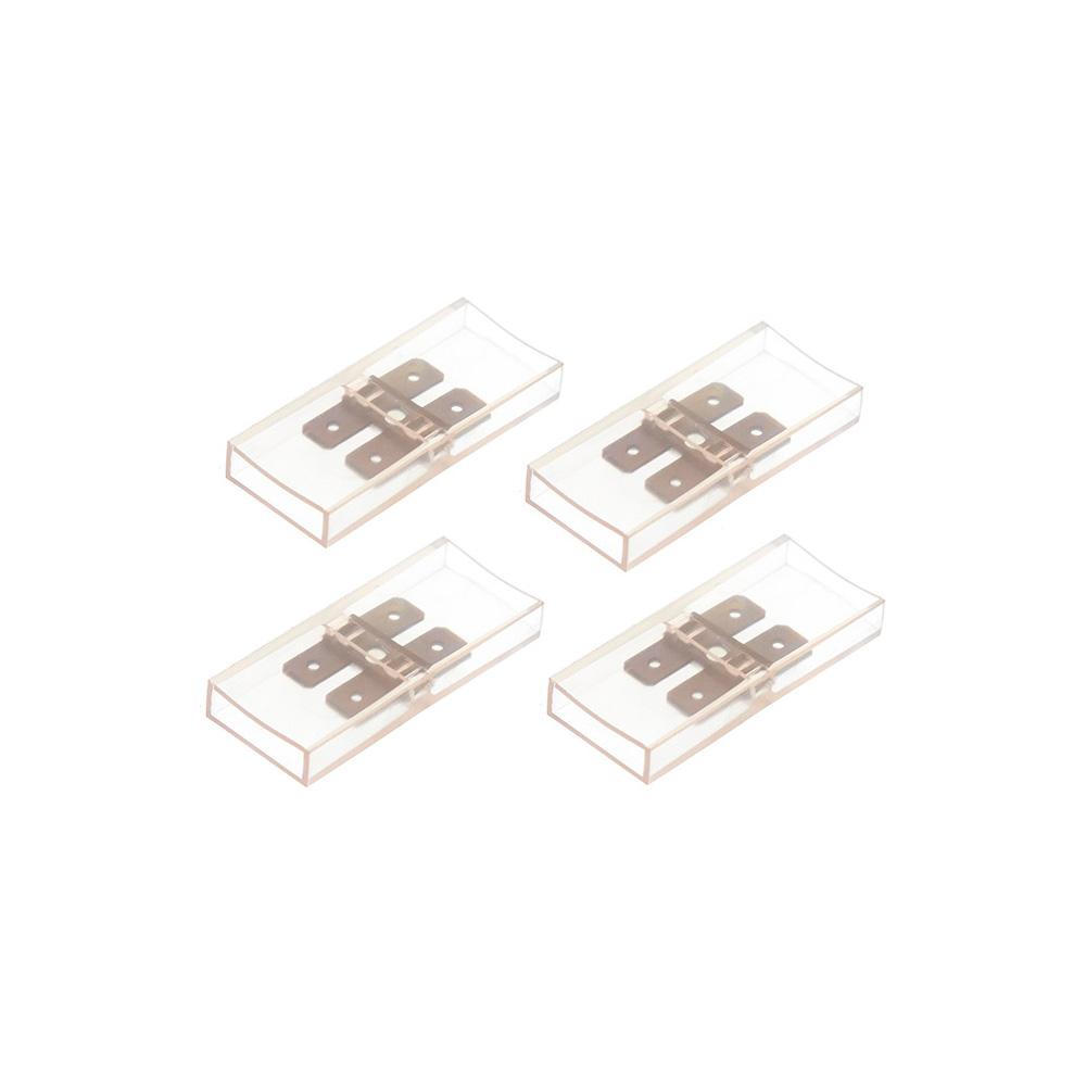

One key step in installing an alternator to replace the VWDub generator is joining the three (red) 10 GA wires together in the rear under-seat space. I am having a dickens of a time trying to find out what this plastic, butt-splice connector is called! And as you all know, the 'Rosetta stone' key to finding just about any Type 1 VW part is knowing what the proper designation is for the part.
Will one of you VW electrical geniuses please help me 'properly' identify this connector, so that I can obtain and keep a few around as spares? Thanks (see attached image below).

They're referred to as terminal connectors

Ah! Thanks, Mike. Yep, looks as if the 'terminal connector' that my #10 ga. alternator wires are joined with has some melt damage and for that reason one of thse big red wires has an uncertain, tenuous connection. I need a new one. As always, when one discovers more intimate details about Dubs' small parts, it helps to keep a few spares around, also! I managed to snag on a few minutes ago on eBay but I'd also like to find a source for buying some new ones (if they're still made by some clever Chinese company, LoL). The original (the melted one) has a VW logo embossed on it but the part number is undecipherable.

PS: Just found that JBugs sells these (could have predicted that, I guess). They can be found here: https://www.jbugs.com/product/WW-QUAD.html
They refer to them as 1/4"inch, 4-post, SHROUDED terminal connectors. Eureka!

And here's another seller (in Deutschland) of the same shrouded connector terminal, if anyone should in future be searching for this, as I was: https://vwkaeferersatzteile.de/Electrical/Wiring-S...:3980.html

Whoops! Looks as if, upon closer look, that shrouded terminal connector I mentioned available in Germany is not 1-4 joined, but is for 2-2 wire joins. Ah well, they probably have other bug goodies there worth checking out. Rolling Eyes

1/4" connectors will not work for the junction you are looking for. A 1/4" 4-way junction will likely melt over time.
The heavy gauge wires that come together under the left rear seat should be terminated with 3/8" (9.5mm) terminals to handle the higher amps that flow over those thicker gauge wires. These wires need a special terminal connector to match the larger terminal sizes on the wires. I think this is what you are looking for:
https://www.wolfsburgwest.com/cart/DetailsList.cfm?ID=111937078
This terminal connector is specifically for bringing together the charging system wires.
If you are not interested in using a VW OE/replica part, you may consider a 12v power distribution block like this to bring the wires together.
https://www.parts-express.com/4-8-AWG-Distribution-Block-265-800
Functionally it is the same, but you will need to clip off the terminals at the end of the wires and strip off the insulation to install the wires into the distribution block. This block is also useful if you plan on powering more devices (like a stereo amp) directly from the battery. You can neatly connect them here instead.

You da man, Ashman! Once again, peerless advice and suggestions! You're absolutely right and you just answered my next question about these connectors in advance (being able to handle the current loads of a charging system)! Applause

I see that Goodspeedmotoring has them too. Labeled, insulated tab terminal strip.
