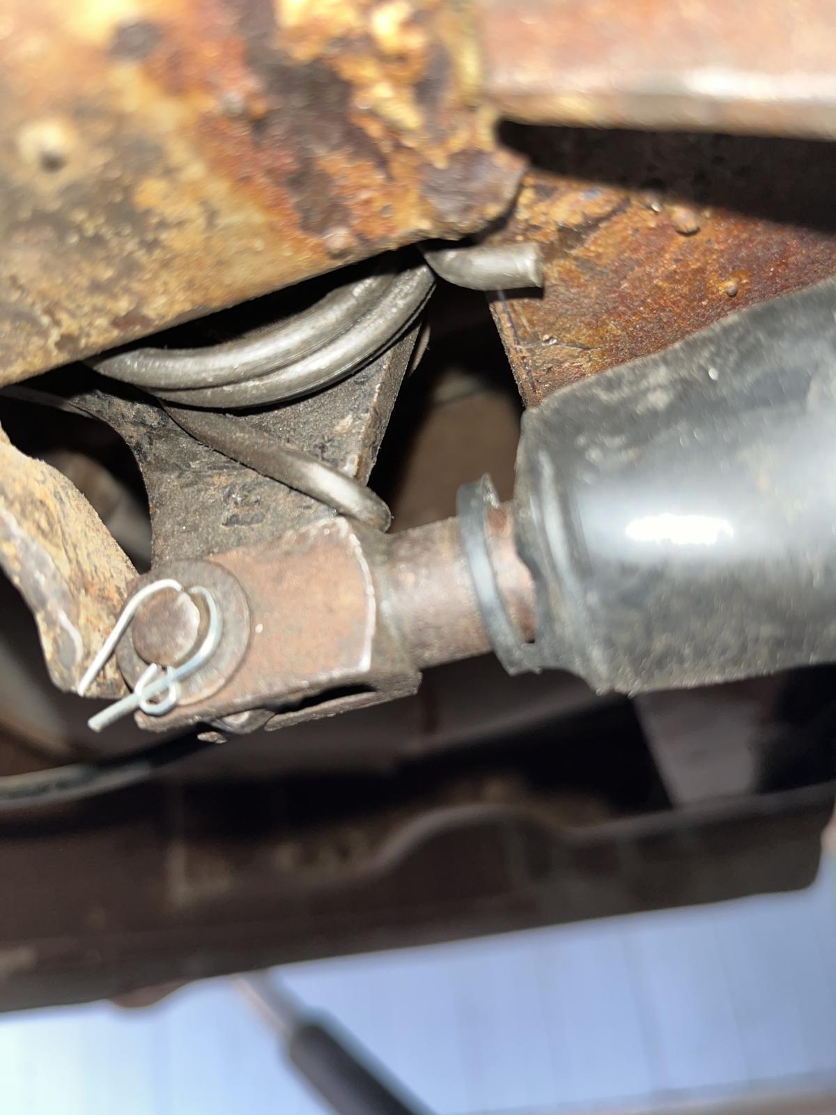

Do you have the 1mm play on your pushrod?
If not it will not refill the master cylinder properly on its return pedal stroke.
Quick check is grab the pushrod going into the M/C - can you clack it back and forwards everso slightly?

Yes, I do have play in the pushrod. When I push the brake pedal I can see bubbles coming up. Which I’m assuming is brake fluid going into the master.
I did however notice that the rubber boot just ripped :/ huge bummer. Do I have that on wrong somehow? Is that easily replaceable?
I still have yet to check every one of my connections, but the only leaks I saw on the ground were from the master cylinder.

the boot is a dust cover.
