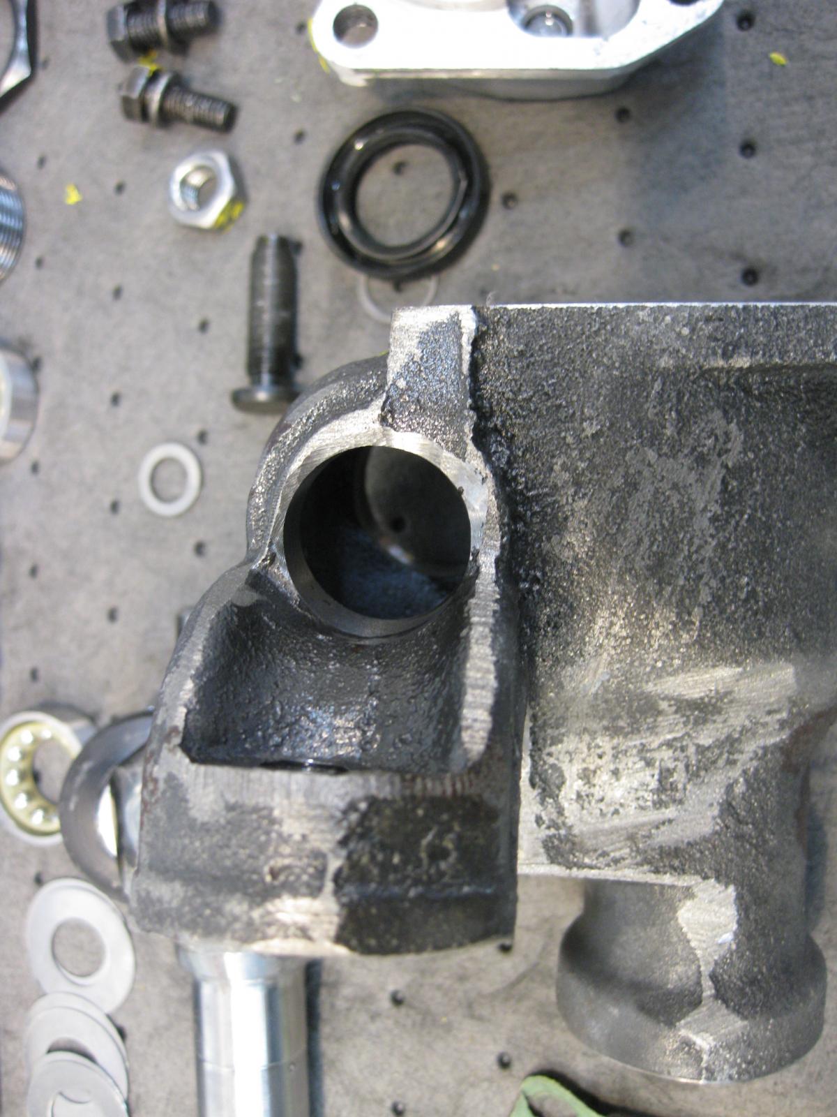

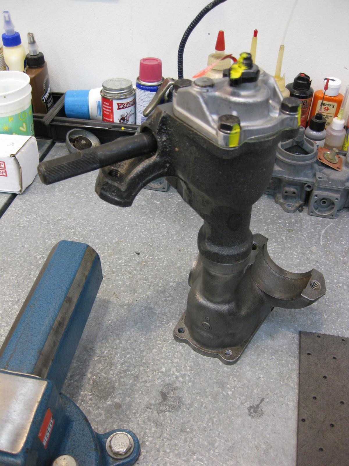

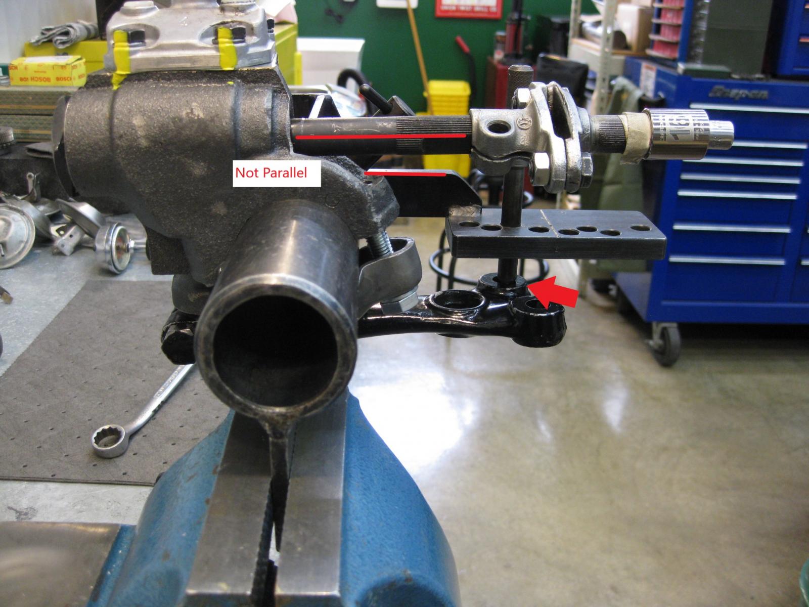

When I went to mount the unit on my alignment/work fixture, something just wasn’t correct. I needed longer bolts since the mounting holes/threads are counter sunk.
And then it still just didn’t seem right.
Something about the machining of the mounting pocket, in conjunction with the shaft alignments is off. I cannot get the alignment tool to properly fit this unit.
The main machining of the main casting is off!

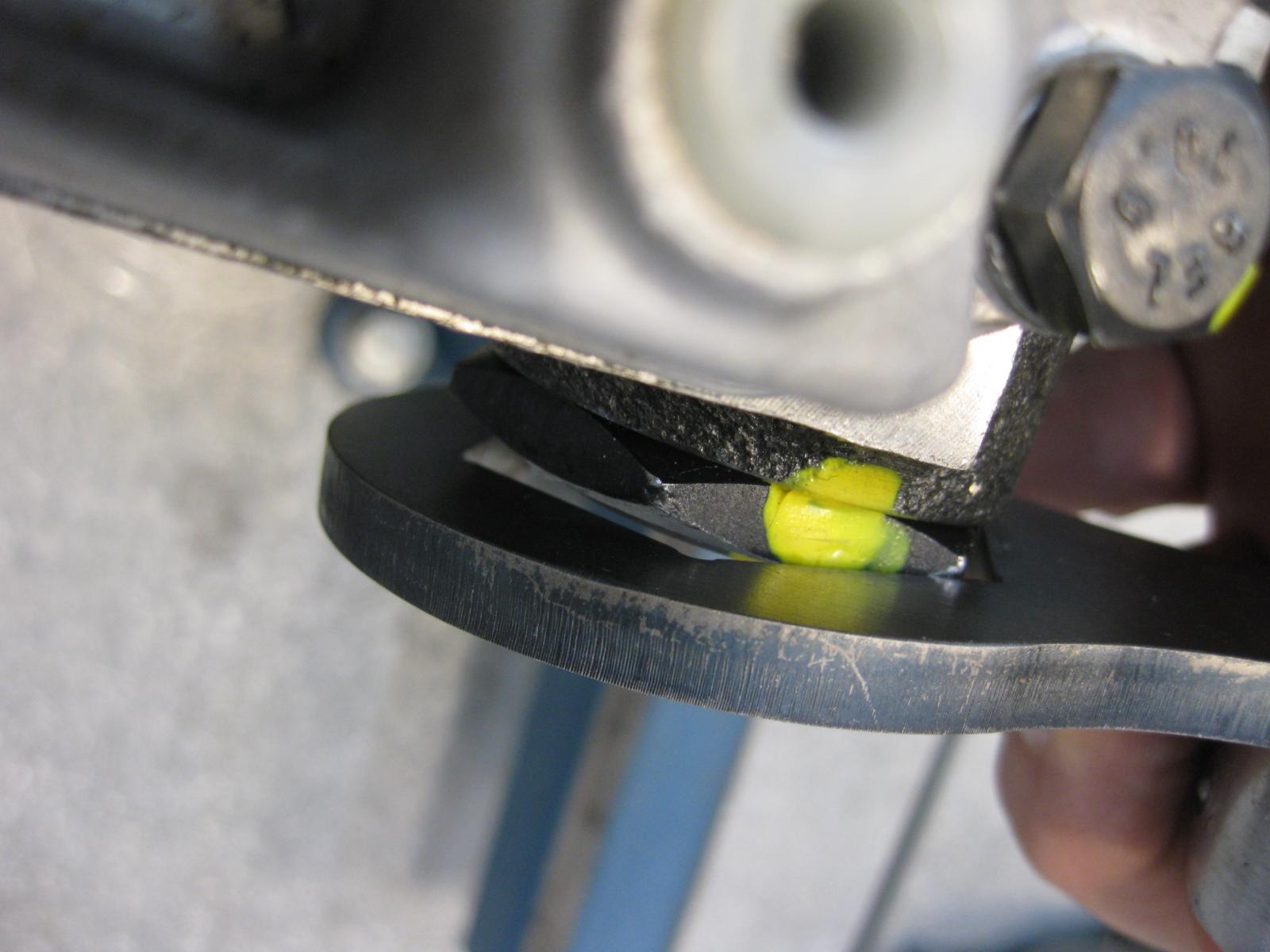

Next step was to remove the big lock nut, but it is oversized. The standard tool will not fit.

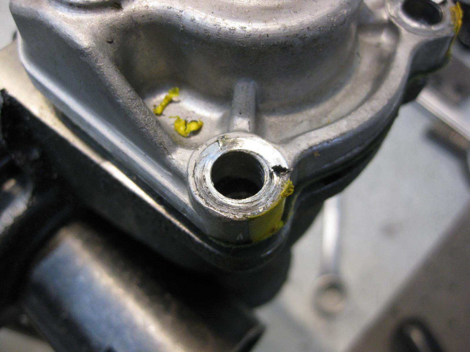

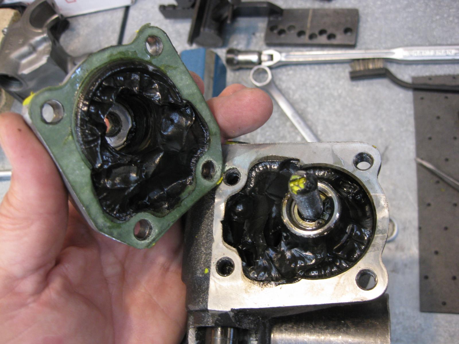

Then I removed the top cover. (Overtightened split style lock washers damage the aluminum.)
The gasket is firmly attached to the cop cover, but no attachment/sealant to the main housing. [Note, I use Gasgacinch on both surfaces when I do a rebuild.]

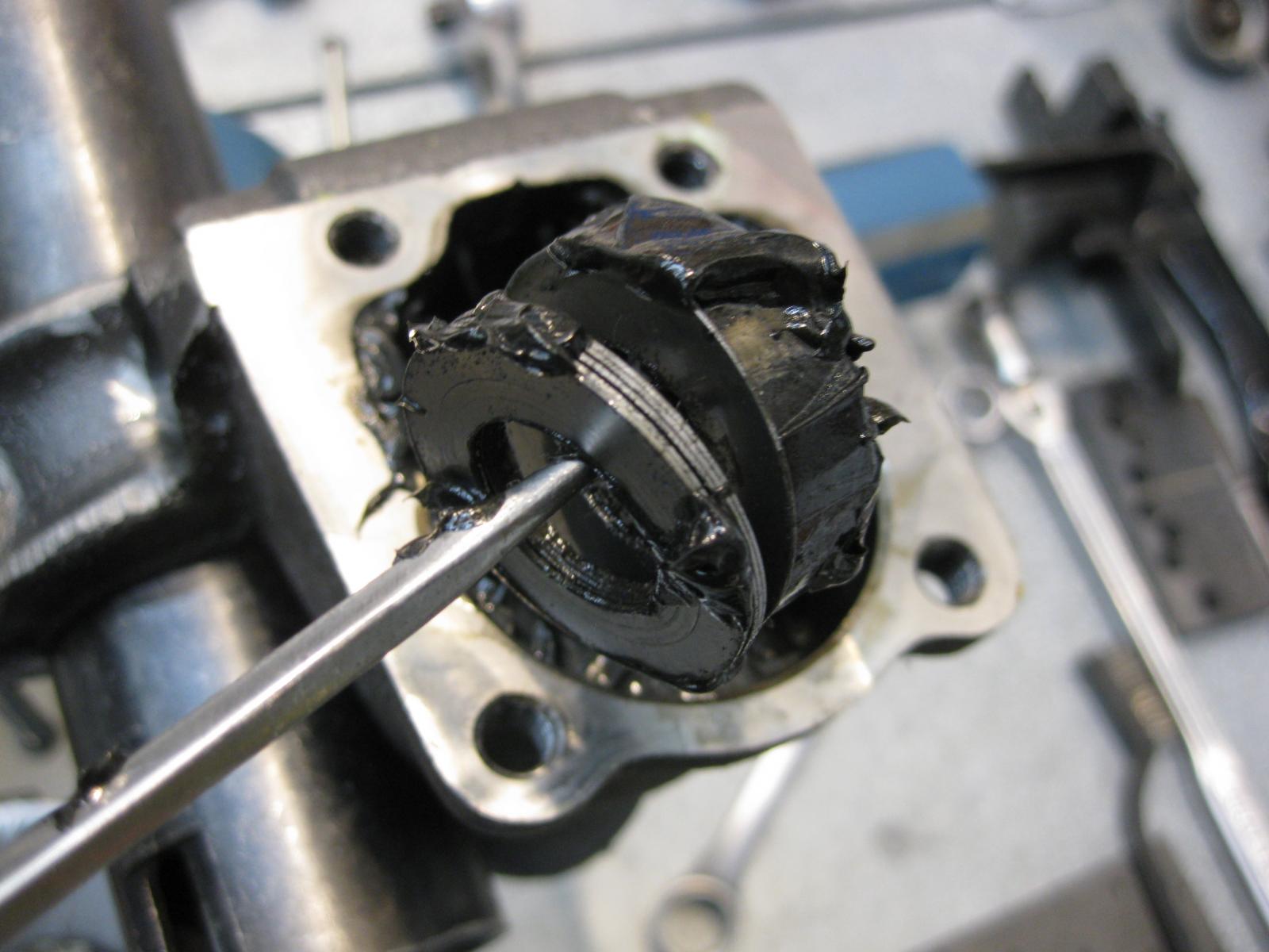

The unit was completely filled with a grease, which, from my experience, I think is CV joint grease. In any case it is a grease that needs some velocity to move it about. I.E. it definitely is not thixotropic. There isn’t any velocity on the ball bearings in a steering box, thus the lower bearing was only partially filled with grease when I disassembled.
The top adjusting screw was only marginally lubricated.

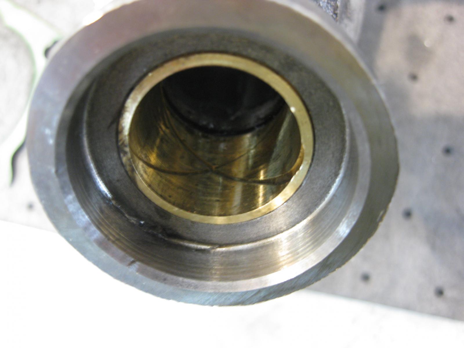

The lower bushing is a pressed bushing and interestingly, they machined a spiral groove to let grease get into the bushing/shaft interface. (But, the grease isn't thixotropic, so I don't know if it is going to flow down that groove.)

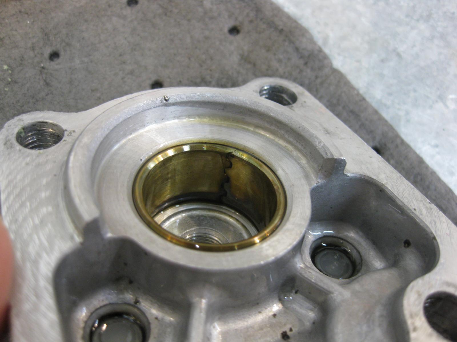

The upper bushing in the top cover is a split ring bushing.
Note the logo on the inside of the cover.

You can see that the hole for the worm shaft is not properly centered/located on the casting. More evidence of the poor machining. This is also going to affect the ability to line up the steering column with the steering box input/worm shaft.

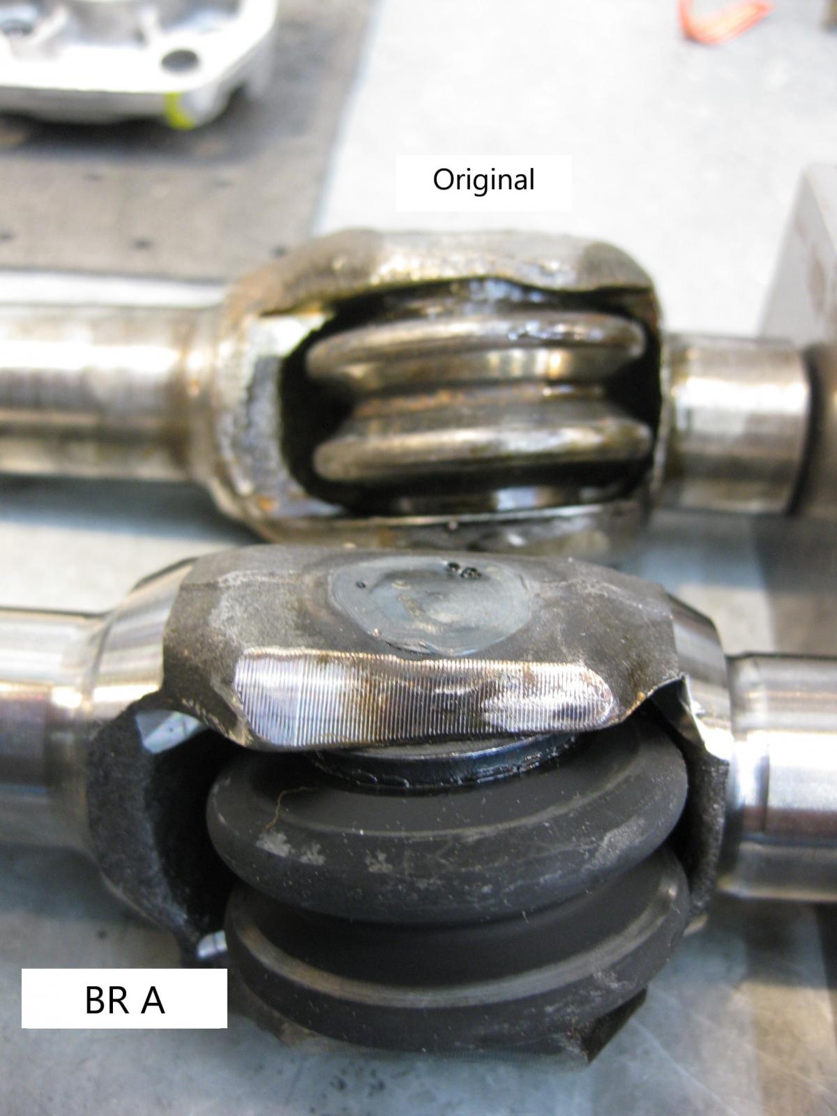

Roller Shaft: Examining the roller shaft, poor quality! A decision to “weld” the needle bearing in place. The roller has a loose spot and a tight spot. Possibly, a result of the welding heat distortion.
And compare the roller to an original. Very “blocky/boxy/unfinished” looking. Note the damage to the roller from just the few turns I put on it prior to opening the unit. Why did they have to grind off the corners of the casting?

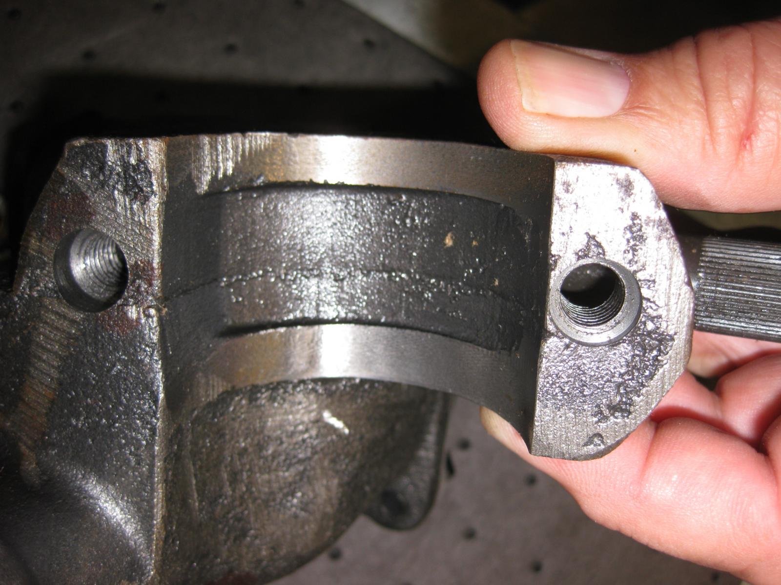

Worm Shaft: Comparing this unit to an original, it almost looks like a different design. Squared off.
See that shiny spot at the red arrow? That is where the ball bearing is riding. It should be riding (and creating a shiny spot) down in the center of the race, where the green arrow is. So, the race has not been machined properly.
