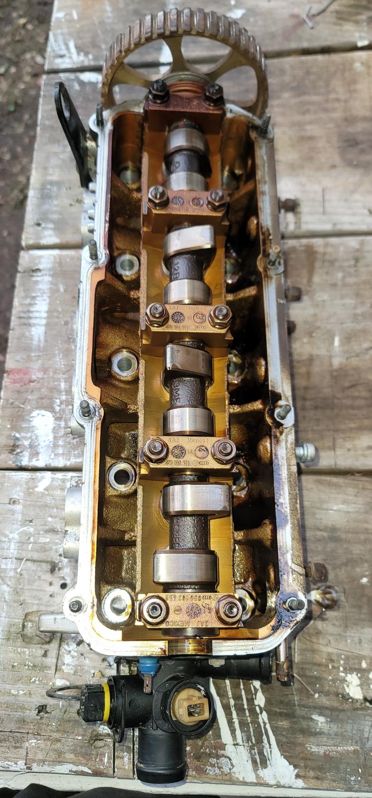

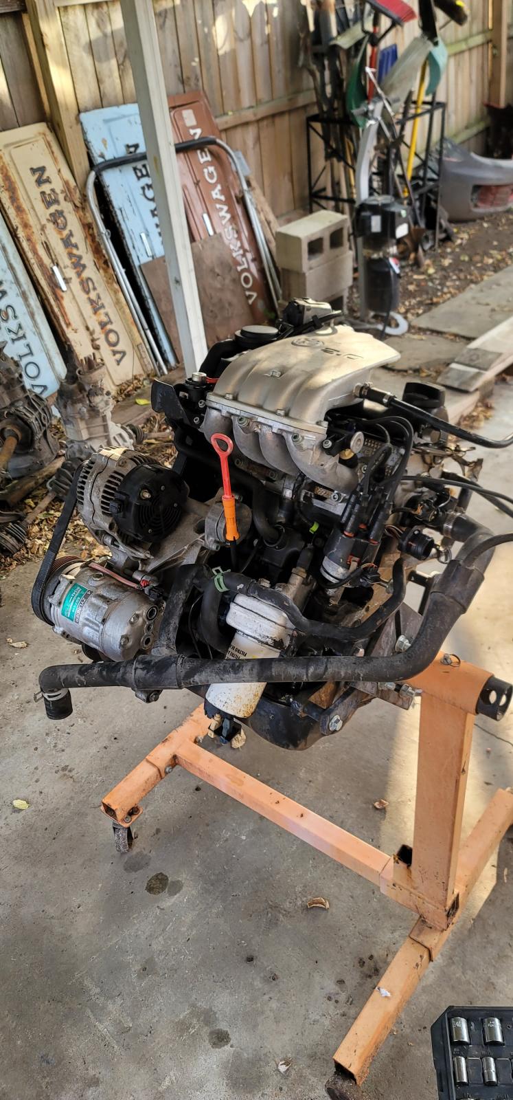

I've decided to take on the task of converting my 2.1 WBX in my 1990 tin-top to a 2.0L ABA out of a 97 Jetta. The ole waterboxer started giving me low oil pressure issues. I've put a ton of money into this motor and then it failed internally. I've been wanting to convert to an aba so it's just all the more reason to take on the job!
Here it is at the beginning. Cleaned it up, and removed the head. I have planned to attack the head first. Im going to rebuild the head with a TT 266 (aka 270) cam, HD valve springs, new lifters, and all the seals in between.

Right on! Simple robust motor. In for more pics
Installing at 15deg or 50?

Is it just me or does that ABA look like it was kept in pretty good shape and - or has relatively low miles? i.e. I bet the engine portion of harness won't have too many wear-tear (heat etc) related faults.
Keep us posted. It'll run like a top when you're done!

You are right! This engine has less than 100k miles on it if I remember correctly. I probably could've got away with just throwing it in and calling it a day. I just wanted to rip it apart to put better parts in and for peace of mind. Very Happy

Found a little bit of time during the evening to get some work done on the ABA. Got further on the head. Next is to remove the valves, clean the head, lap the valves, and then send it off to a machine shop before rebuilding it.

What's the machine shop doing to the head?
At the bare minimum they're going to mill the head gasket surface, test for cracks, warpage, and hot tank wash it. I'll have to give them a call to see what other services they offer.
