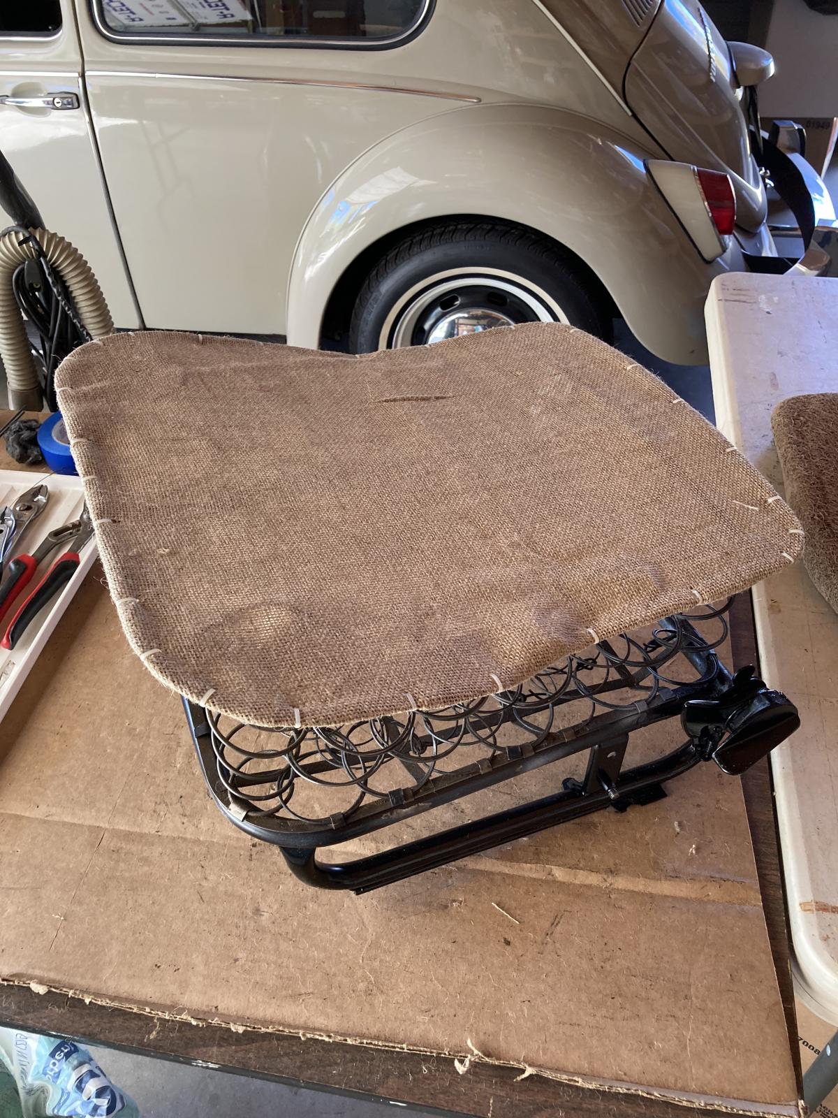

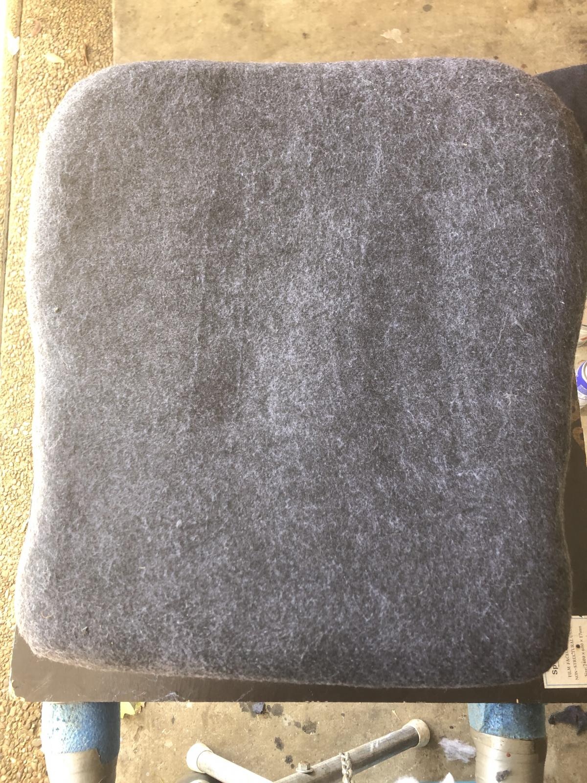

I covered my springs with burlap and secured it to the perimeter of the frame with zip ties. I too was concerned that the hog rings might poke through the cover at some point. Zip ties worked great.
WW's felt has a smooth fabric cover. I put the felt on because it made for nicely rounded edges and pretty much eliminated any lumps/bumps under the cover.

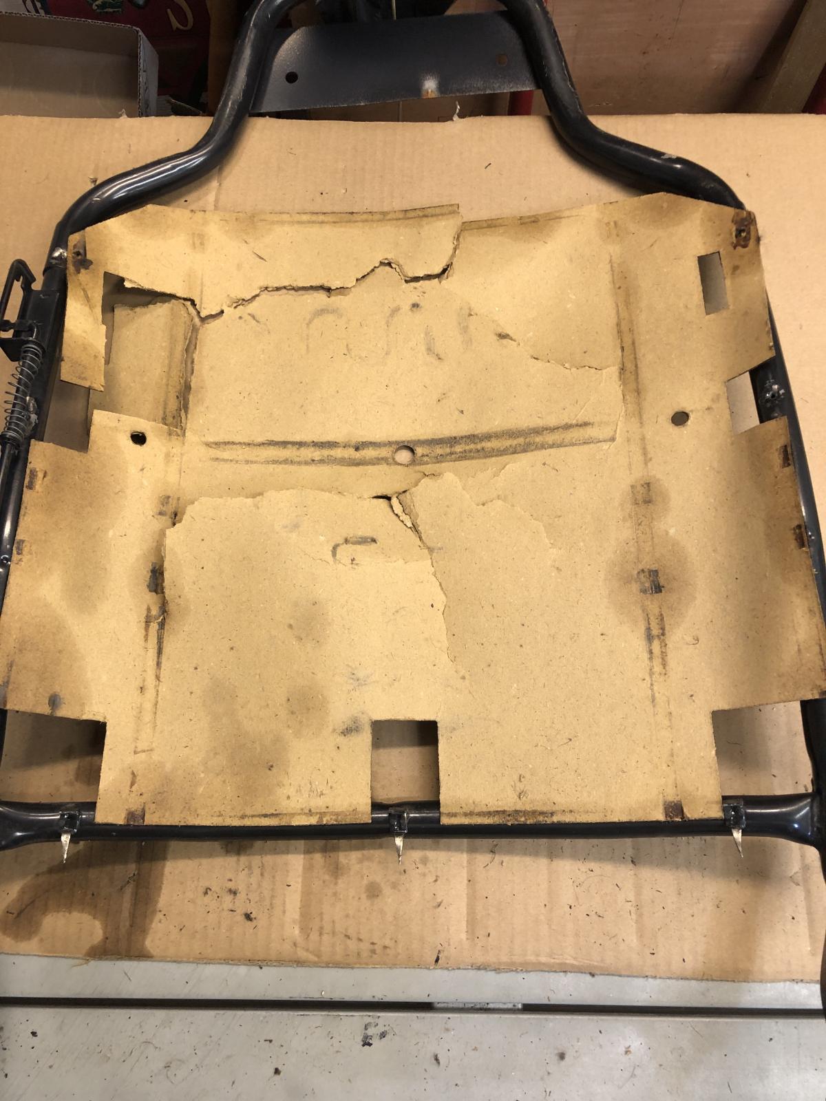

I started with disassembly of the front passenger seat. Getting the seat release knob off did not go well, and I ended up breaking it. I have a better plan to get the driver's side off, as it's on there good. The rest of the tear down went well, but I hadn't planned on the seat back paperboard being toast. I can feel that the driver's seat is the same way. I was able to tape it back together for a template, in case I can find something suitable to make new ones, otherwise I'll have to order a couple.
The coconut fibre pads were in better shape than I could have imagined.
I was also able to salvage the buttons and wire that go through the seat back.

I just ordered the paperboard backing from WW (I'm sure cip1 has them too). Since they were made to measure they just slipped in ... done. Didn't have to hassle with getting suitable material and making new ones. Pre-made one's are pretty inexpensive.

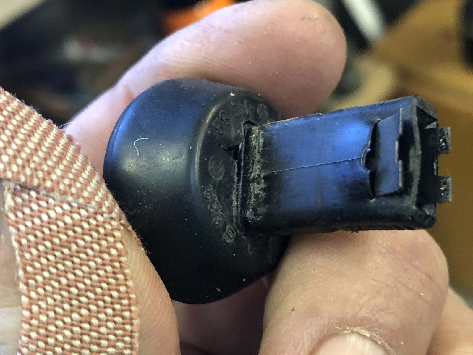

Great that you were able to salvage the buttons! They are very hard to find and are pretty pricey when you do find them.

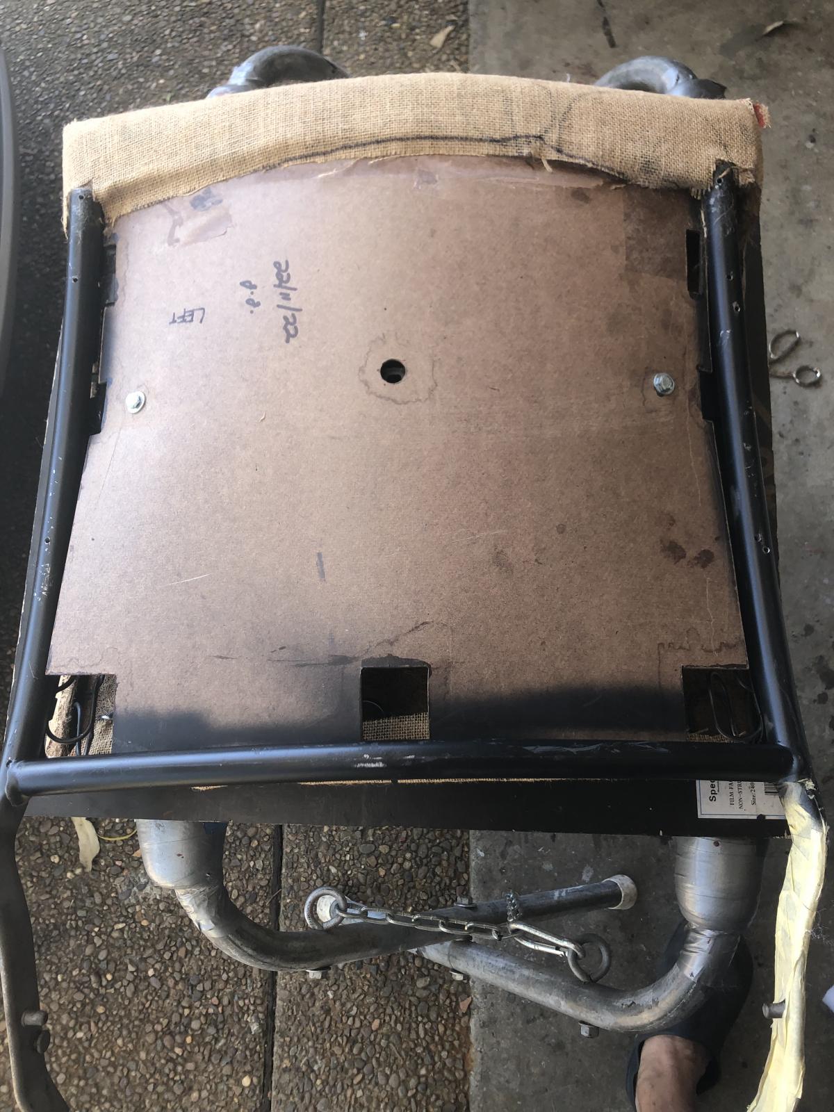

Definitely make your own seat backing. The paper/cardboard is just too flimsy. I used 3mm masonite which I guess is 1/8" in the non-metric world.
I used the cardboard to make a pattern on the masonite and then just cut it out with a jigsaw. Holes have to line up as do the screw holes.
I then clamped the cut piece on the OUTSIDE of the frame to give it its curvilinear shape. I then wet the masonite very well a half dozen times over a couple of days and then repeated. When the clamps were released it was the correct shape.
It was then installed on the INSIDE of the frame and fitted perfectly.
Here's some shots I took during the refurb.
First photo of finished masonite backer. Forget it is a low back. We still had low backs in Australia in 68.
Second photo is the sewn hessian. It had a pattern and was cheap.
Third photo showed felt which was spray glued on
Fourth photo with some polyester Dacron to soften the back of the seat where the masonite was.
While I wait for the WW paperboards to arrive, I'm going to try and make some out of masonite, and yes it is 3mm. The masonite will definitely need water to make it retain that curve. I like the idea of the Dacron on the back!

So I've been puttering away on the seats, and got the back seat bottom as well as the passenger seat bottom done. They turned out really well, but I've run into a glitch with the driver's seat back spring assembly. There are 3 broken welds, and one broken spring. I'm going to try and find a replacement on nearby FaceBook groups, rather than have 4 repairs on it. I thought that I could get the other seat release knob off without damage, but failed. I'm sure I could get it the third time! They sure weren't meant to come off!
I'm hoping to get the backing and more sisal this week to move forward.
