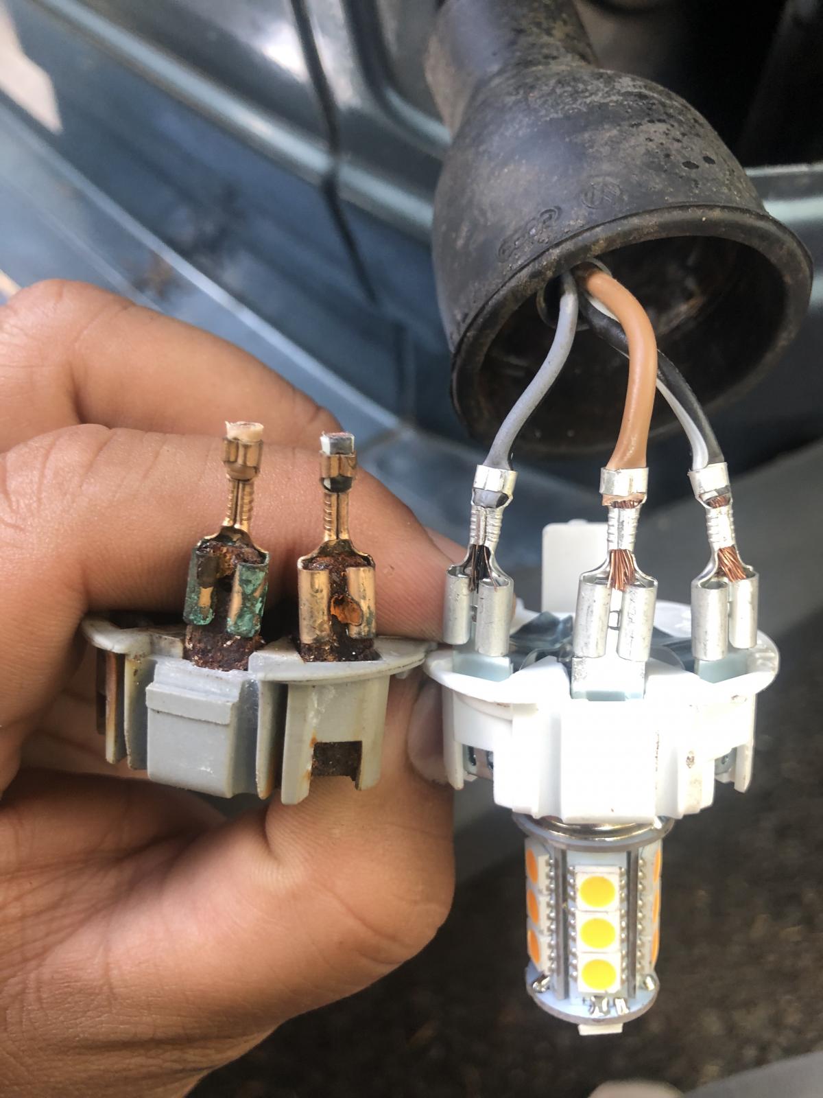

I would also be checking all the connector pins for corrosion and ground wires, check the bulb holders for corrosion and clean them up. Also check the voltage at each bulb holder.
I just replaced all my rear bulbs and found slight corrosion at each bulb holder, and a slight voltage drop. Cleaning them up helped Thumbs Up

Do this first before you start replacing everything. Clean and inspect wiring and connections real good before you make the assumption it all needs to be replaced.

Had the same problem with my front corner. Then I saw this and i didn’t bother thinking about it and just replaced it. My tail light had some corrosion but I was able to clean it and replaced some of the connectors.
