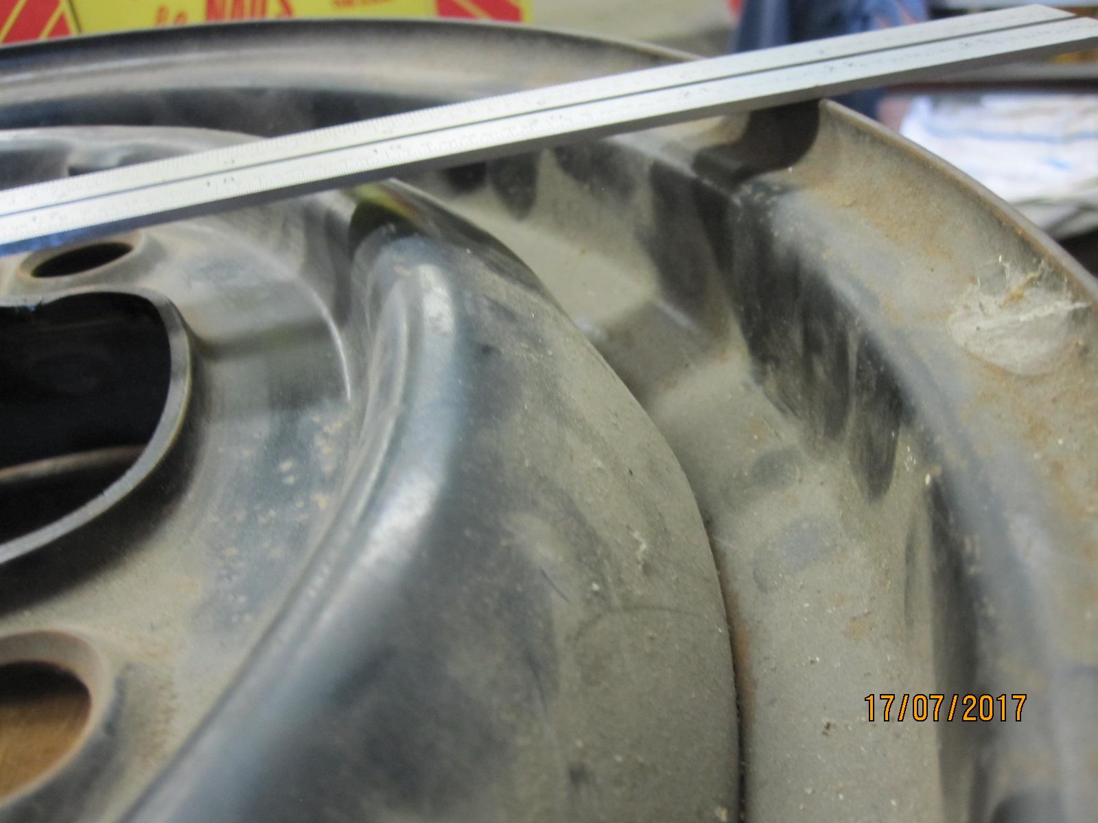

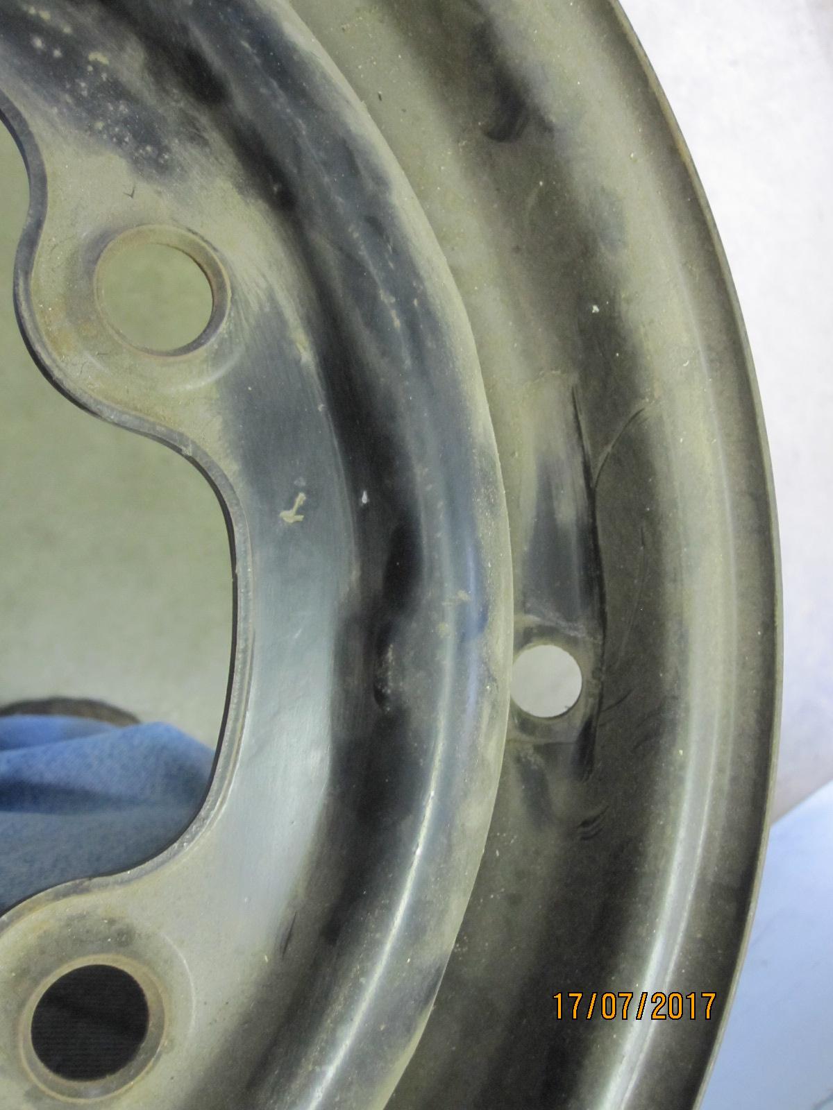

Can Anyone Tell Me More About this Wheel?
RETROVW
Joined: May 10, 2006
Posts: 10
RETROVW is offline
PostPosted: Tue Oct 25, 2022 2:06 pm    Post subject: Can Anyone Tell Me More About this Wheel? Reply with quote
sled
Joined: February 16, 2005
Posts: 6298
sled is offline
PostPosted: Tue Oct 25, 2022 2:28 pm    Post subject: Re: Can Anyone Tell Me More About this Wheel? Reply with quote
its round, has five holes in it, and has rubber around it.
drive your split.
mandraks
Joined: November 28, 2004
Posts: 7124
Location: Lawrenceville, Ga
mandraks is offline
PostPosted: Tue Oct 25, 2022 3:08 pm    Post subject: Re: Can Anyone Tell Me More About this Wheel? Reply with quote
looks mostly black from here. 14 inch?
regards
Uli
crofty
Judas of the North
Joined: August 09, 2000
Posts: 19883
crofty is offline
PostPosted: Tue Oct 25, 2022 3:30 pm    Post subject: Re: Can Anyone Tell Me More About this Wheel? Reply with quote
no slots so it cant be bus or thing. Maybe just a weird angle of a bug smoothie?
HamburgerBrad wrote:
Brian_e Premium Member
Joined: July 28, 2009
Posts: 4174
Location: Rapid City, South Dakota
Brian_e is offline
PostPosted: Tue Oct 25, 2022 4:01 pm    Post subject: Re: Can Anyone Tell Me More About this Wheel? Reply with quote
6 holes. One is just bigger and is kinda funny shaped.
So more or less the lazier and stupider you want to be, the nicer quality parts you need to buy.
-Modok
Narrowed beams, Drop adjustable spring plates, Bus disk brake and IRS kits.
www.type-emotorsports.com
Type E Engine Parts and Supplies
https://type-emotorsports.com/collections/engine-parts
RETROVW
Posts: 10
RETROVW is offline
PostPosted: Tue Oct 25, 2022 4:33 pm    Post subject: Re: Can Anyone Tell Me More About this Wheel? Reply with quote
It is a 15-inch rim, and the valve stem lines up with the bolt hole. I was told that means it is a Bus rim. It looks like a bug smoothie rim, but the valve stem is in different spot.
YellowSplittie
Joined: September 30, 2003
Posts: 1170
YellowSplittie is offline
PostPosted: Tue Oct 25, 2022 5:53 pm    Post subject: Re: Can Anyone Tell Me More About this Wheel? Reply with quote
I have one also and asked here:
https://www.thesamba.com/vw/forum/viewtopic.php?p=9497536&highlight=#9497536
RETROVW
Posts: 10
RETROVW is offline
PostPosted: Tue Oct 25, 2022 6:24 pm    Post subject: Re: Can Anyone Tell Me More About this Wheel? Reply with quote
I have not checked to see if I can read the date stamp, but believe I have two of these. I have several 14 and 15 inch bus wheels, just trying to figure out what this wheel was made to fit.
RWK
Joined: June 24, 2009
Posts: 1645
Location: S.W. MI
RWK is offline
PostPosted: Wed Oct 26, 2022 5:43 am    Post subject: Re: Can Anyone Tell Me More About this Wheel? Reply with quote
Possibly a thing rim? they are solid, but 14 in.
73 Type 181
63 Type 113
63 Type 261- 428 071
62 Type 241-378 025 178 530
Stocknazi
Joined: June 18, 2004
Posts: 5539
Stocknazi is offline
PostPosted: Wed Oct 26, 2022 7:39 am    Post subject: Re: Can Anyone Tell Me More About this Wheel? Reply with quote
Looks like a Thing wheel (14 inch/no cooling slots).
WANTED:
Thomas Jefferson
'64cal lookdub
1200 Deluxe
Joined: May 29, 2004
Posts: 1725
Location: TX
'64cal lookdub is offline
PostPosted: Wed Oct 26, 2022 9:26 am    Post subject: Re: Can Anyone Tell Me More About this Wheel? Reply with quote
Agreed, they have a different offset and deeper dish like the wheel pictured.
RETROVW
Posts: 10
RETROVW is offline
PostPosted: Wed Oct 26, 2022 10:16 am    Post subject: Re: Can Anyone Tell Me More About this Wheel? Reply with quote
The tire mounted to this wheel is 15 inch. I have a few thing rims also and this is different for the thing wheels are 14 and this is 15
RWK
Posts: 1645
Location: S.W. MI
RWK is offline
PostPosted: Wed Oct 26, 2022 11:04 am    Post subject: Re: Can Anyone Tell Me More About this Wheel? Reply with quote
Type 3 wheels are solid also, and 15, but the ones I have use different hub cap mounts, maybe early T3? These are pics of NOS rims. They have similar offset to thing and bus.
73 Type 181
63 Type 113
qwerty
Joined: March 18, 2004
Posts: 345
qwerty is offline
PostPosted: Wed Oct 26, 2022 1:49 pm    Post subject: Re: Can Anyone Tell Me More About this Wheel? Reply with quote
go here and scroll down?
https://vwispwest.com/type3/wheels-brakes/wheels-backing-plates-brake-shoes-cables/
RETROVW
Posts: 10
RETROVW is offline
PostPosted: Wed Oct 26, 2022 3:07 pm    Post subject: Re: Can Anyone Tell Me More About this Wheel? Reply with quote
Those look close but the valve stem hole is between the mounting bolt holes, the wheel I have the valve hole lines up with the bolt hole. Crazy....Thanks for the info though.
busdaddy
Joined: February 12, 2004
Posts: 53130
busdaddy is offline
PostPosted: Wed Oct 26, 2022 3:21 pm    Post subject: Re: Can Anyone Tell Me More About this Wheel? Reply with quote
I hate to break it to you, but stem location is a random thing, just like a roulette wheel, it ends up wherever the outer band landed before welding.
Слава Україні!
Posts: 71807
PostPosted: Wed Oct 26, 2022 4:51 pm    Post subject: Re: Can Anyone Tell Me More About this Wheel? Reply with quote
Early Type 3 (61 - very early '64) still have those same nubs but they are slotted like Bus wheels.
