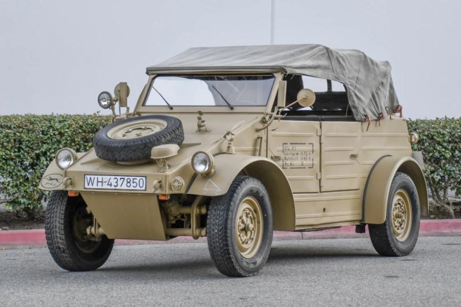

Original Kubelwagen
Engine: 1,100cc 24hp
Transaxle: Swing axle with wheel side reduction gears (transporter style) rotated down for higher clearance, limited slip differential.
Turn signals: none or semaphores
Pan: flat panels with early upright seats

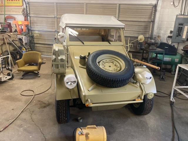

PostPosted: Thu Oct 13, 2022 2:13 pm    Post subject: Re: Kubelwagen Project Reply with quote
Thanks for the comments. I totally agree the vintage 181's are hard to find without rust. This drove my decision to start with new pans and new metal. Granted it will also rust, but I am starting out with fresh metal.
The soft top keeps the weight down and there is basically no interior to worry about except the seats. The floors drain. The side windows (future post) are not totally weather proof but easily removable. For my application as a sight seeing vehicle, the open cab (with fold down front windshield) was a plus.

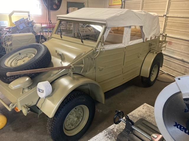

Regarding the fuel range, one of the requirements was to get me back should my RV break. The Sprinter carries 54 gallons giving it a ~600 mile range. I wanted the towed vehicle to have the same range. it was solved easily, Kubelwagens had "jerry can" mounts on the fenders. Two 5 gal (20 ltr) cans plus the 14.5 gal (54 ltr) main tank give me well over a 500 mile (800 km) range.
Kubelwagen replica (Older Kubelkraft build) similar to what I ordered. Note Jerry can mount.

PostPosted: Fri Oct 14, 2022 11:42 am    Post subject: Re: Kubelwagen Project Reply with quote

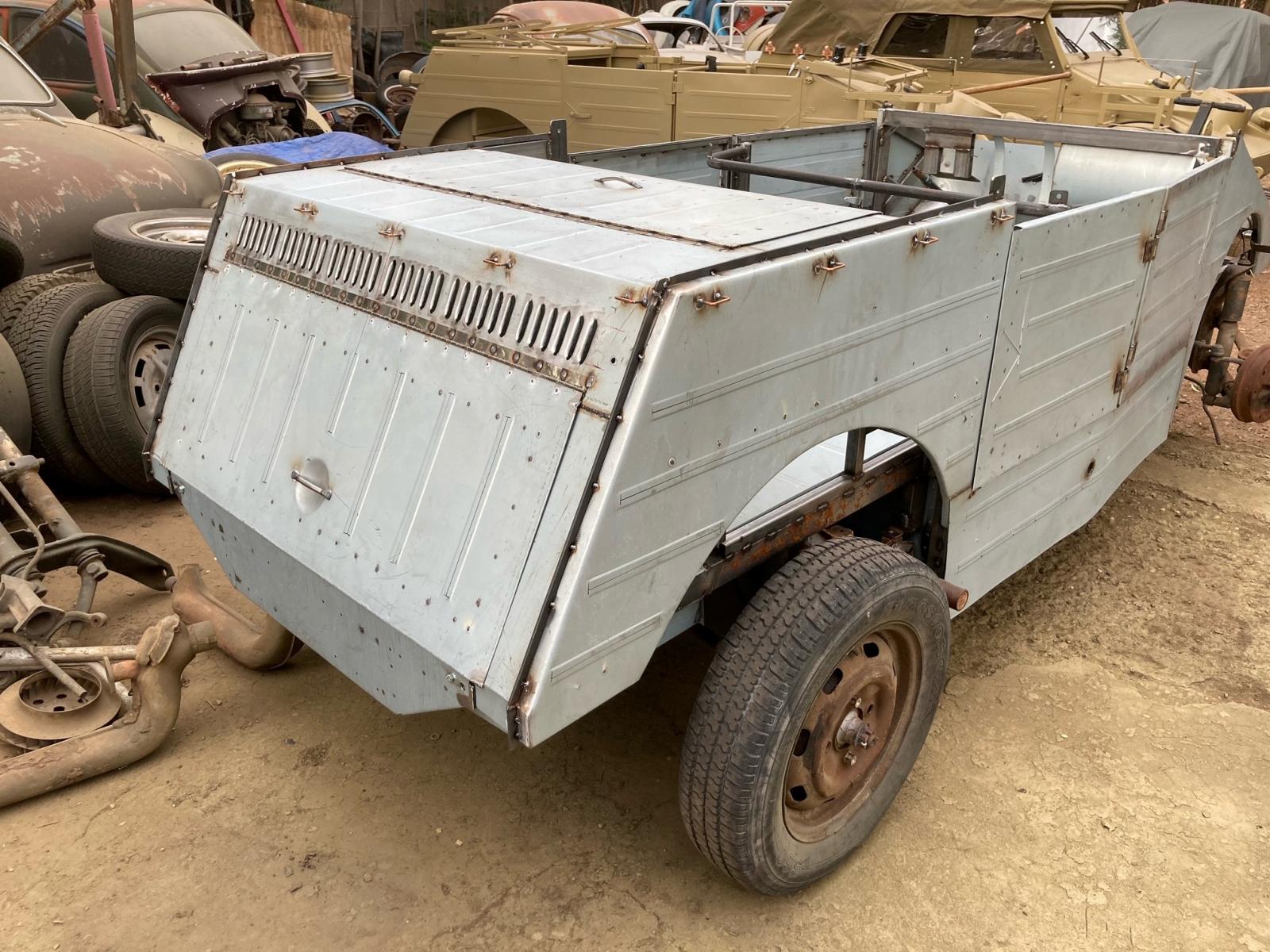

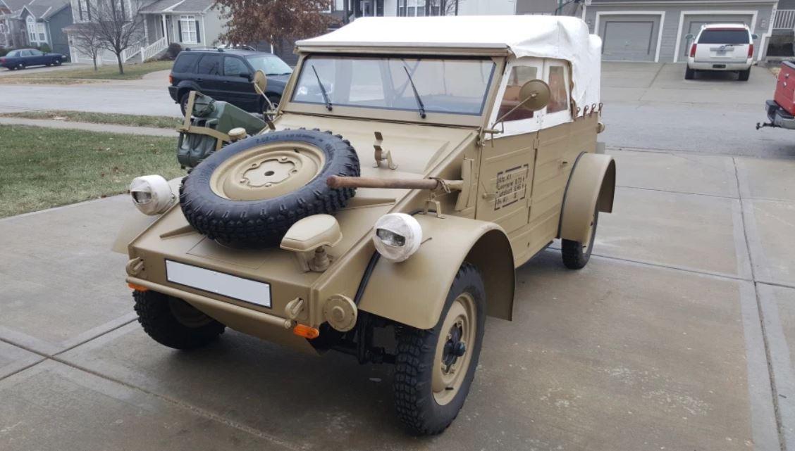

What are the rectangular things just in front of the mirrors in picture 2 and 6 ?
Thank you.
74 Thing 1600DP
76 Westfalia 2.0L FI
69 Beetle 1500SP sold
88 Goldwing GL1500/6 sold
RinTinTin in Waldorf Astoria 1956
BNMike
Joined: November 12, 2009
Posts: 334
Location: Hot Springs, SD
BNMike is offline
PostPosted: Fri Oct 14, 2022 12:26 pm    Post subject: Re: Kubelwagen Project Reply with quote
Thank you.
Turn signals., semaphore style. I have a pair for my type 181 'faux Kubel'.

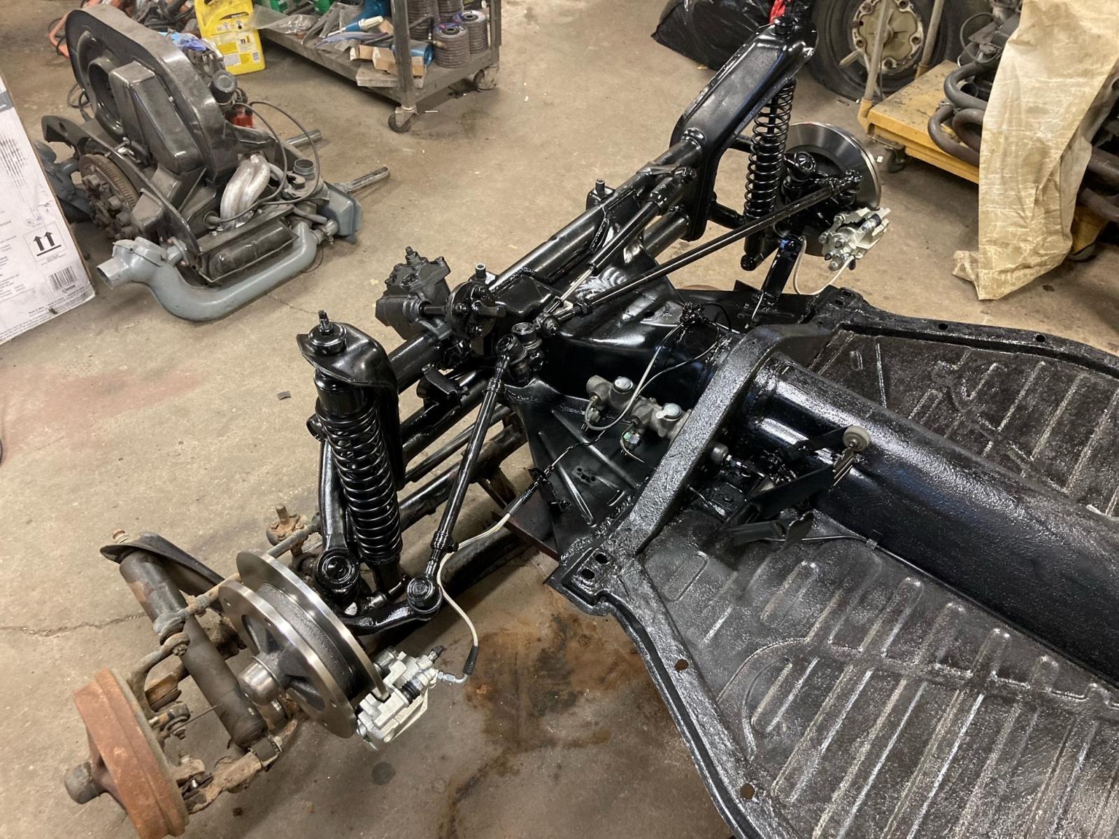

PostPosted: Fri Oct 14, 2022 1:28 pm    Post subject: Re: Kubelwagen Project Reply with quote

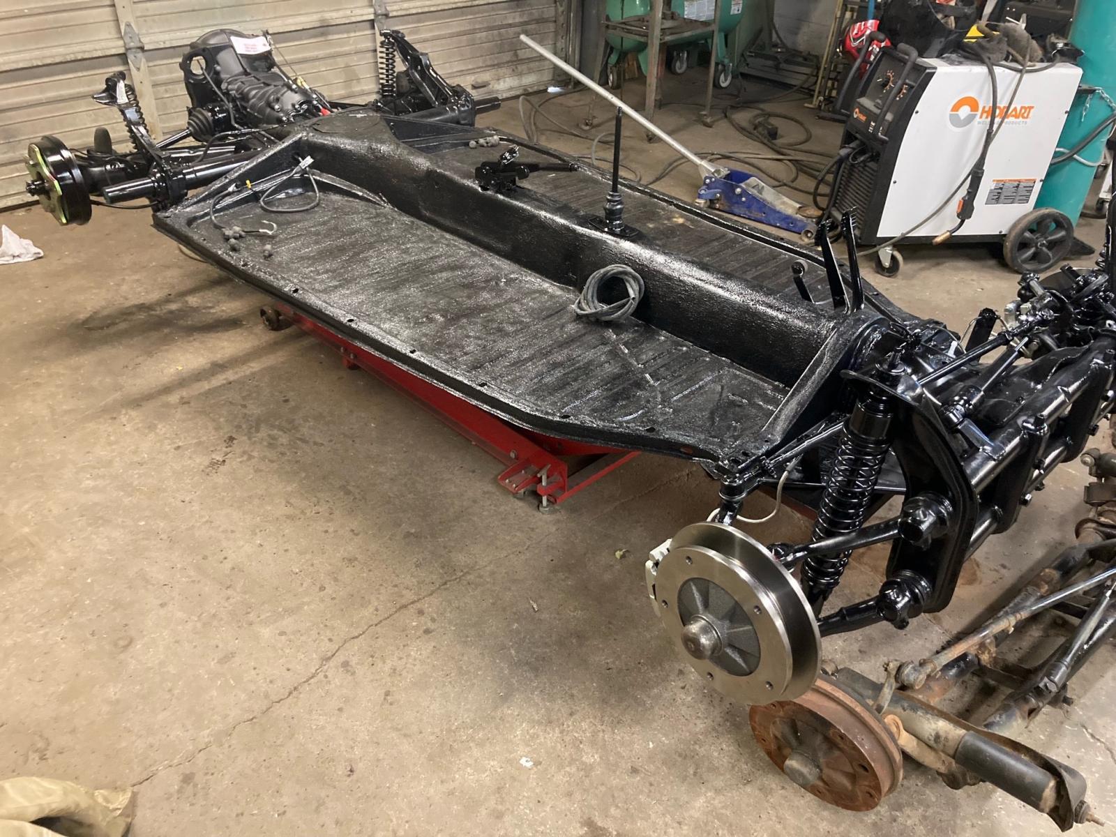

Chassis
Originally all VW's had swing axle transaxles. The advent of independent rear suspension ("IRS") was a 1960's innovation. In talking with Steven, the IRS Kubels are far more stable and maneuverable along with the fact that raising the rear suspension to make them look authentic is much easier without the high camber swing axle setups.
Steven had a 1972 chassis donor in the shop, it became mine although not much original is left as the front beam and both pans were replaced. The sunken seat wells were cut out and straight pans (similar to original Kubel) are installed. The front beam mount, tunnel, and rear torsion bar suspension are all that remain original from this 1972 chassis.
Original Kubel chassis
Note flat pans and reduction gear rear swing axles.
My 1972 swing axle Kubel chassis
Note: IRS transaxle and front disk brakes for drivability while retaining the five wide wheels of the original Kubelwagen

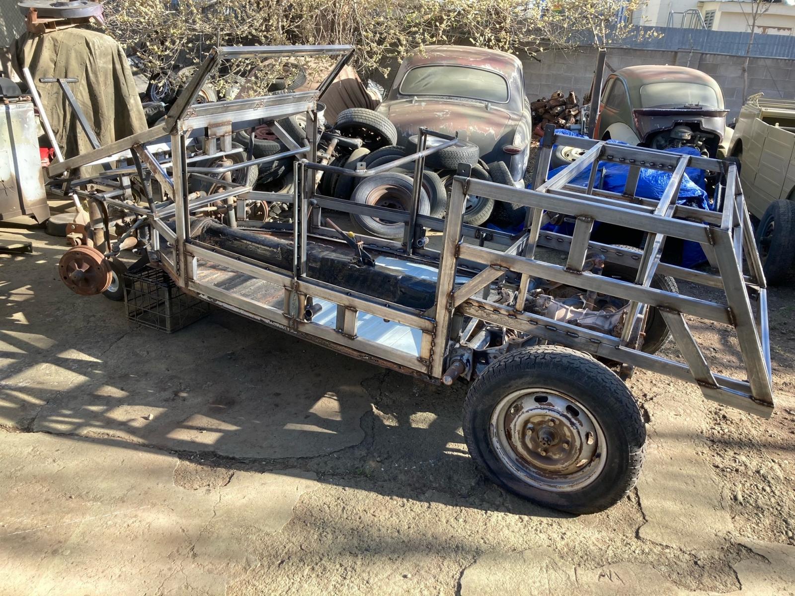

The body is hand crafted out of tube and stamped steel, a surprising amount of steel.

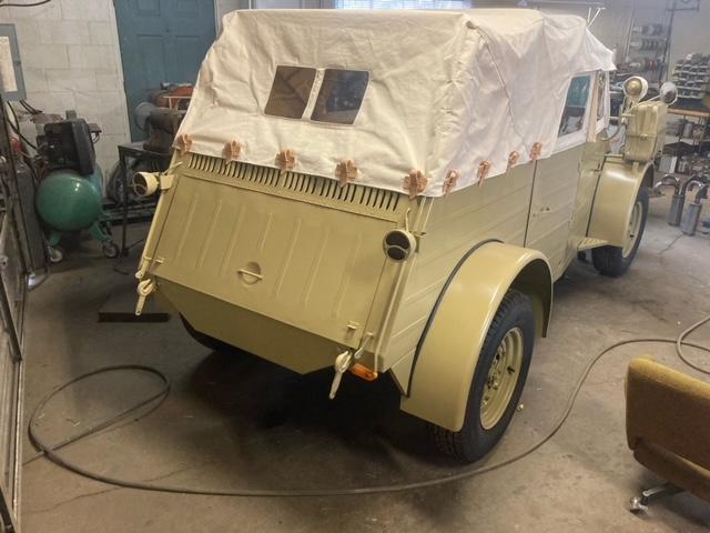

Body complete, paint is "Special Yellow" a green/tan combination seen for the German North Africa campaign.

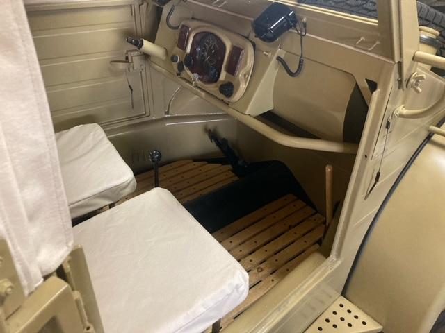

PostPosted: Tue Oct 18, 2022 1:00 pm    Post subject: Re: Kubelwagen Project Reply with quote
Interior
Chose light colored top and seats. Very basic interior easily removable.

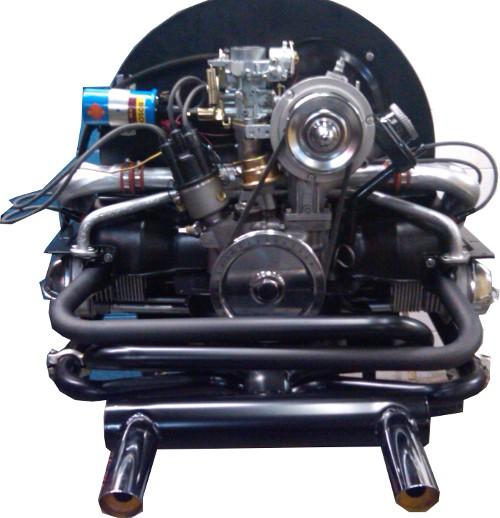

Engine selection
My goal for the vehicle is to be very reliable remote location vehicle with fewest things that can go wrong. Excluding the engine, there is almost nothing on a Type 1 that needs much care with the exception of the tires. Dirt simple.
For the engine I selected a crate engine from MOFOCO. MOFOCO has a distinct reputation for quality engines in addition to their own hi-performance heads and proprietary hydraulic lifters. While I am not looking for a street sleeper, I do want enough HP to perform on the highway and have enough torque for low speed crawling in the boonies.
Selection
- 1,600 dual port (biggest stock VW displacement)
- counter weighted crank (for smoothness and vibration)
- MOFOCO 041 heads (better cooling and slight performance increase)
- hydraulic lifters (never adjust them)
- Alternator upgrade (90 amp)
- Dual pulley serpentine belt (modern belt system)
- Remote filter (easy decision)
- Electronic ignition (no mechanical points or condenser)
- Weber progressive single carb (Extra 10-15 HP and higher RPM)
Now if I can just get it (been on order for over a year, Sept 2021)
