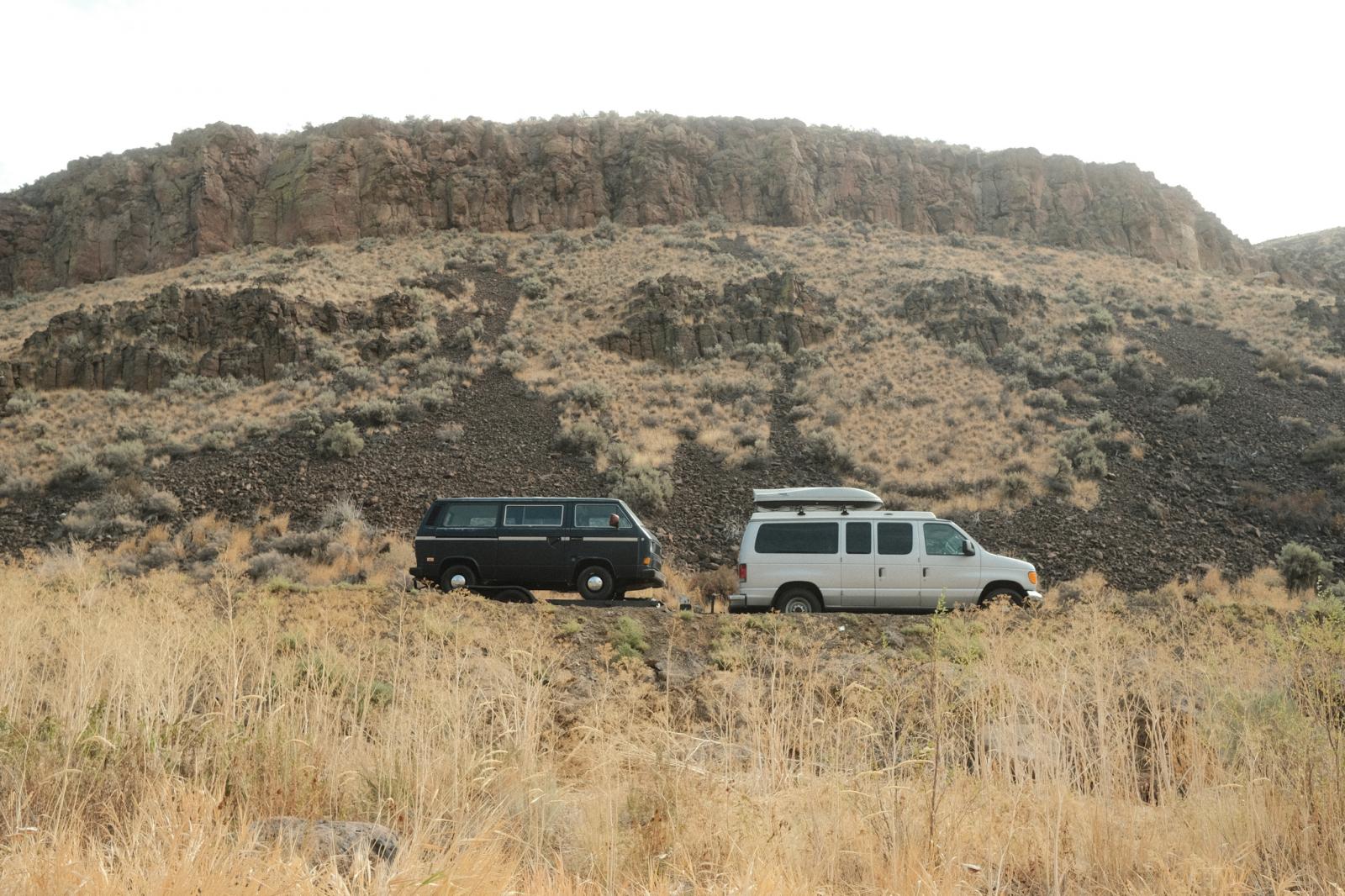

At the end of last month I made a trip out to the Idaho/Oregon border and bought me a manual 1984 Vanagon Wolfsburg Edition with 125,000 original miles on the 1.9L for $4,000 and 4 hours each way.
Trailered it all but the last last 20 miles home for my piece of mind.
My goal is to build this into as reliable a camper van as I can while maintaining that VW charm. This rig will also be my test mule for some custom projects I have in mind. I am starting off by going through all the suspension stuff and installing a zero-mile rebuilt EJ22 engine. Phase 2 is a unique camper/interior layout that I've been working on.
I'm feeling super stoked and inspiring to get to work!

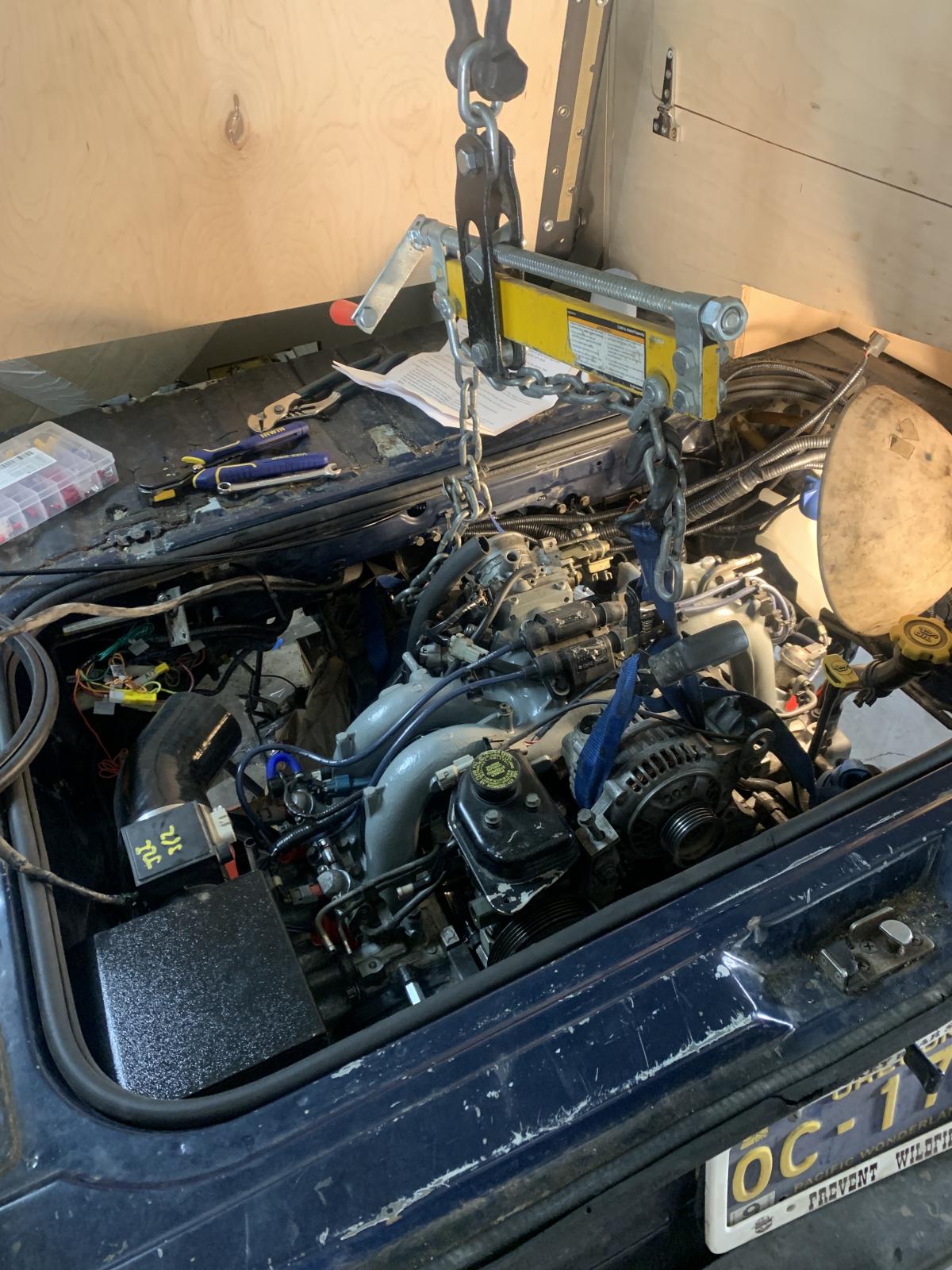

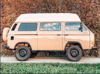

-EJ22 Subaru swap (block is being sent off for rebuild on Monday and the harness if already sent for modification).
-Burley suspension revamp (Radflo shocks, Shwenk springs, all new bushings etc...)
-Reimo smalltop.
-Custom interior.
-RMW rear side window-deletes w/ CRL 12" portholes.

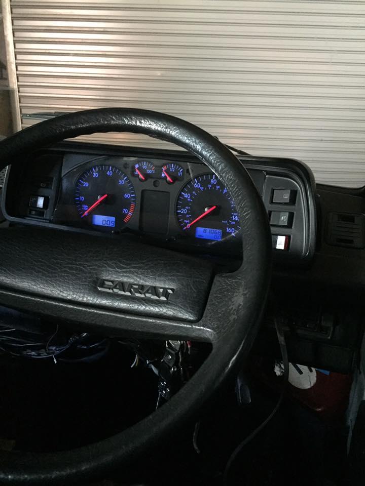

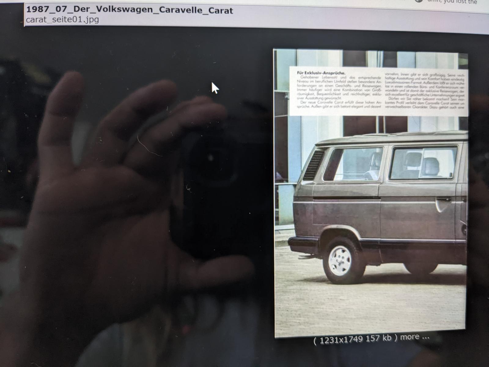

These brochures were filled with recycled pictures, they're in no way an empirical proof: you can see on later years brochures some pics of the early sliding doors van:
compare the brochures below from 1984 and 1987 for the Carat (EU version), the 87 shows clearly an early door, which changed in 1985.
Notice the "Photoshop" job as well, same vans and building in the background Laughing So don't believe what you see printed...
I owned two 84 Wolfsburg , one Westy and one tin top, they both came with the 420mm steering wheel, as expected.

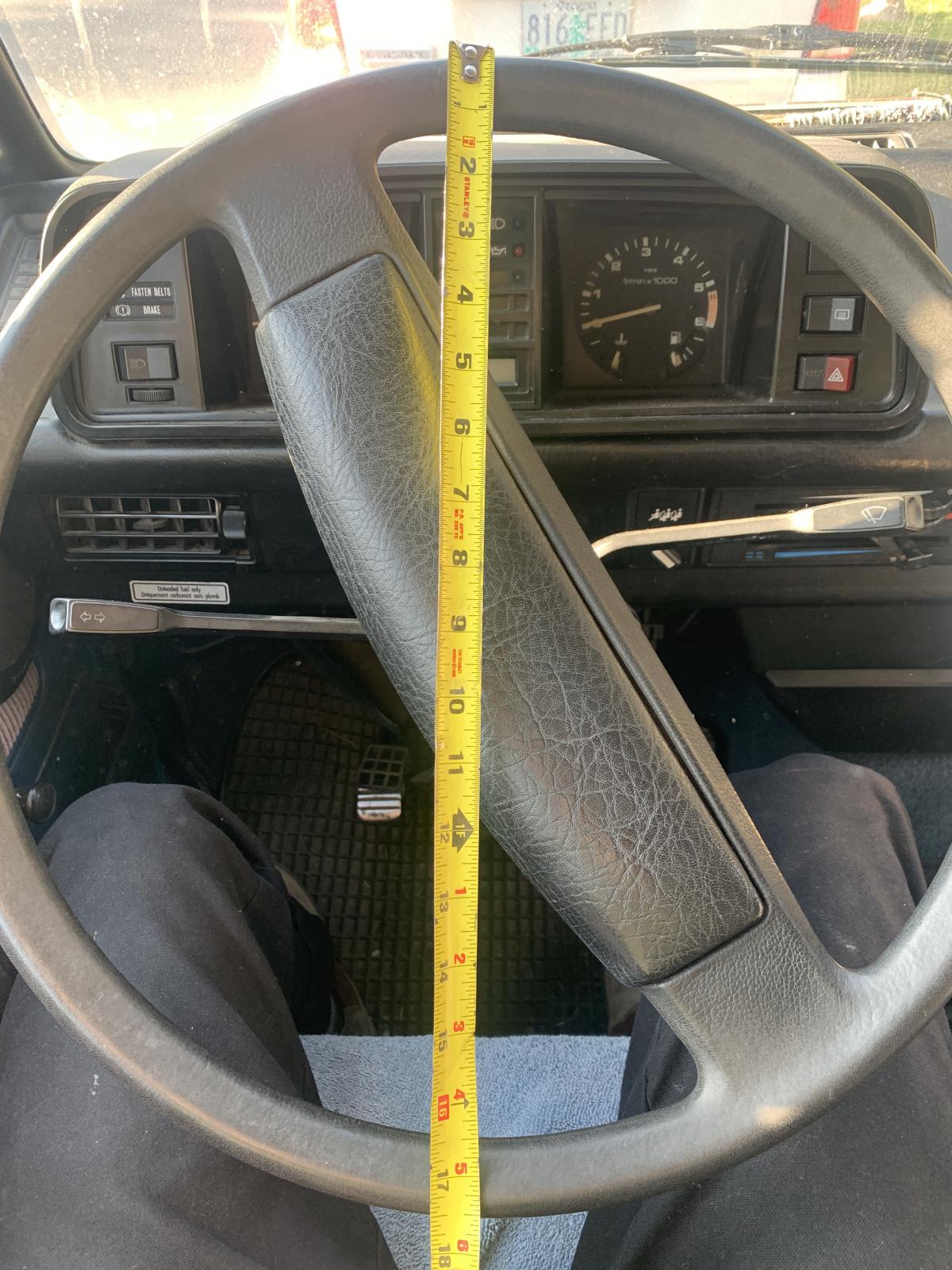

Ok, here’s the actual wheel in my van. It’s fully covered and 17.5” in diameter. This feels like such an wild goose chase. It’s kind of funny how much weird stuff went on while the Vanagon was in production.

Inches? What's that??
It's definitely a non power steering wheel indeed.
It must have been replaced, and they kept the horn pad.
Look in the aluminum hub, the production year is in there, but being an 84 van, it's entirely possible you'll see an 83 stamp, which won't be helpful.
If you see an 82 stamp or older or after 84 stamp ( less likely in the US), then you'll know for sure it got swapped.
Have fun tinkering on the van though!

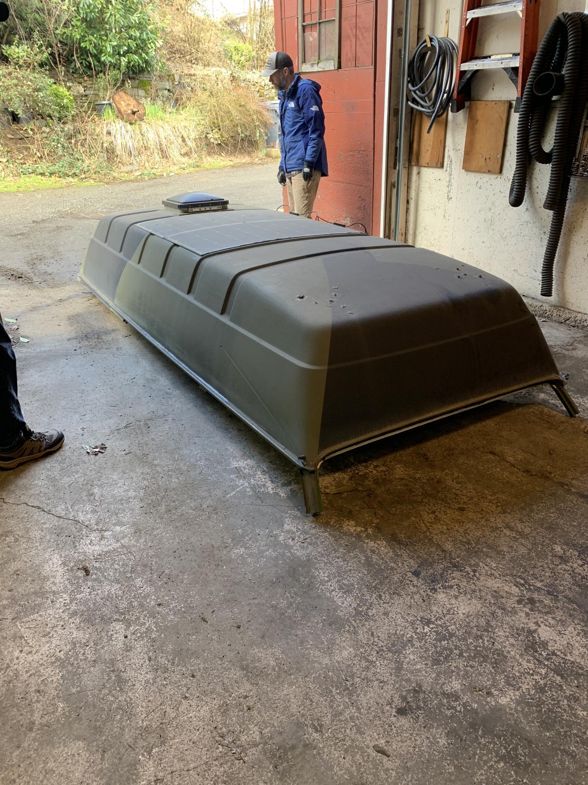

I noticed you plan on putting on a Reimo hightop. Do you have a line on one? Santa Cruz Campers had one in stock when we picked up ours in January. Not sure if it's still there.
nate
1987 Westy
Insta: @Thatbaldwinlife
Vanagon Adventure and DIY videos:
That Baldwin Life YouTube Channel
10degnorth
Joined: March 07, 2018
Posts: 484
Location: Bend, Oregon
10degnorth is offline
PostPosted: Tue Oct 18, 2022 7:05 pm    Post subject: Re: (My) Perfect '84 Wolfsburg Build Reply with quote
nate
The Reimo Smalltop is the little mushroom poptop https://vanagonwestfaliaparts.com/products/reimo-smalltop?_pos=1&_sid=435db0486&_ss=r .
Bjorn's Auto in BC carries them, they also have the Reimo high tops as well.
I am between the Reimo Smalltop and Coast Mountain Hightop's Getaway Van reproduction. The only bummer is that the latter is almost double the price of the Reimo. https://www.coastmountainhightops.com/
I have a lot of work before I start worrying about the top admittedly. I won't get serious about that for another 6 months probably.

Wildthings wrote:
Things get changed. I have the larger wheel on my 91 multivan because I couldn't see the high beam indicator with the smaller wheel because I am pretty tall.
Wheel choice seems to be something different for everyone. There are tons of photos of swaps people have made. Many go with newer smaller ones. Personally, I prefer large with a small grip diameter. Grew up with wheels like that and so........ My first bus was a 23 window when it was only 4 years old and I've never been without a T something since then. Liked the big wheel the early T1s had as it made me feel like a cool municipal bus driver. Walter Mitty here. So my most recent changes to my '91 was to make the wheel heated.
DuncanS wrote:
After several years of not getting around to it, finally just finished sewing my Wheelskins cover on---OMG 11 plus hours. I used a two needle double thread baseball stitch which caused huge amounts of tangling, but still!!!! Also took some time to figure out how to tighten the stitches and seize the leather close to the spokes so the leather wouldn't show a triangular hole at that point. Even though I ground a fair amount away from the urethane grip, reducing its diameter, it wound up being fatter than I like.
Was about to throw out the old "test" wheel I did all the experiments on and then said to myself. "Wait a minute, here's a chance to solve another problem that doesn't need solving." Used to have a heavily modified 181 with a wooden wheel, which I loved, and so thought--Since the leather wheel is my winter wheel and I don't want to get boat paint and epoxy from summer boat projects on the leather, why not have a "Summer" wheel?
Duncan
So I then did this. A larger non power steering reworked wheel.
I like this so much better, I never got the winter wheel back on last year. But the grip is still factory and fatter than I'd like. If there were no other projects, I'd start from scratch and go to 18 plus in diameter, heat, small grip diameter and wood.
Keep going and have fun. I like what you are doing.
Duncan

I am working through figuring out the suspension setup I want to use. My old van has Syncro springs in the back, Westy springs in the front and Bilstein HD shocks all around.
For this one I'm thinking about using the following:
-Shwenk 2wd springs.
-T3 Technique lifted-adjustable shocks.
-T3 shim lift.
-T3 CV spacers.
-Burley upper and lower ball joints.
-Gowesty ball joint spacers.
Based on the Prerunner thread I'd expect this setup to get me around 18.5" hub to fender height. On my current stock setup the van is sitting at 16.5" hub to fender. While the van is a tin top, I am working on putting together a camper interior for it and will be putting either a hightop or Reimo Smalltop on in the future which will add weight. I may omit the shim lift until I do that.
Any input or thoughts on that suspension setup?

PostPosted: Mon Mar 06, 2023 1:08 pm    Post subject: Re: (My) Perfect '84 Wolfsburg Build Reply with quote
Its been a busy 3 months!
The '84 now has about 300 miles on a freshly rebuilt EJ22.
Runs great! Only had a couple of issues with the install.
1. One of my rebuild injectors was stuck open from the rebuilder.
2. The clutch slave cylinder pushrod was too short to fully actuate and so it wouldn't shift. That issue can be seen in this thread:
https://www.thesamba.com/vw/forum/viewtopic.php?t=777010&highlight=
3. My factory coolant temp gauge has a short somewhere and reads at max most of the time, unless I hit a bump just right and then it reads correctly. I have an extra VDO gauge setup that is reading accurately to keep an eye on temps.
https://www.thesamba.com/vw/forum/viewtopic.php?t=777403&highlight=
A buddy of mine had a SA grill that he didn't like so I traded him straight across for my early round grill.
I have been working on figuring out the interior setup for a bit, trying lots of ideas and I think I have settled on a raised bed. I was able to accomplish this by mounting a piece of steel angle to the body of the van that the bed platform rides on when it gets pulled out.
I found a hightop on the Samba classifieds that I am picking up next weekend too. Its a Bundepost top that was used on German postal vans and on military vans. I haven't seen a lot of them state-side. It's not my favorite top, but when looking for high tops you take what you can get! The more I look at it, the more I like it.
I went on a little adventure in the van yesterday and definitely pushed the limits. I think I have just rationalized a locking diff and a winch to myself. Luckily, a Jeep came along and they always love an excuse to use their winch Very Happy .
Anyway, there's the last couple months worth of updates on the van! Lots of good stuff happening. I haven't found the time to do the suspension stuff, but I have the parts sitting there.
Cheers!

Hightop acquired!!!
Now to separate it from the cut off roof.

DuncanS
Joined: October 17, 2013
Posts: 4583
Location: New Hampshire
DuncanS is offline
PostPosted: Sat Mar 11, 2023 9:00 pm    Post subject: Re: (My) Perfect '84 Wolfsburg Build Reply with quote
Show us a pic of it turned over so we can see the underside.
Duncan
