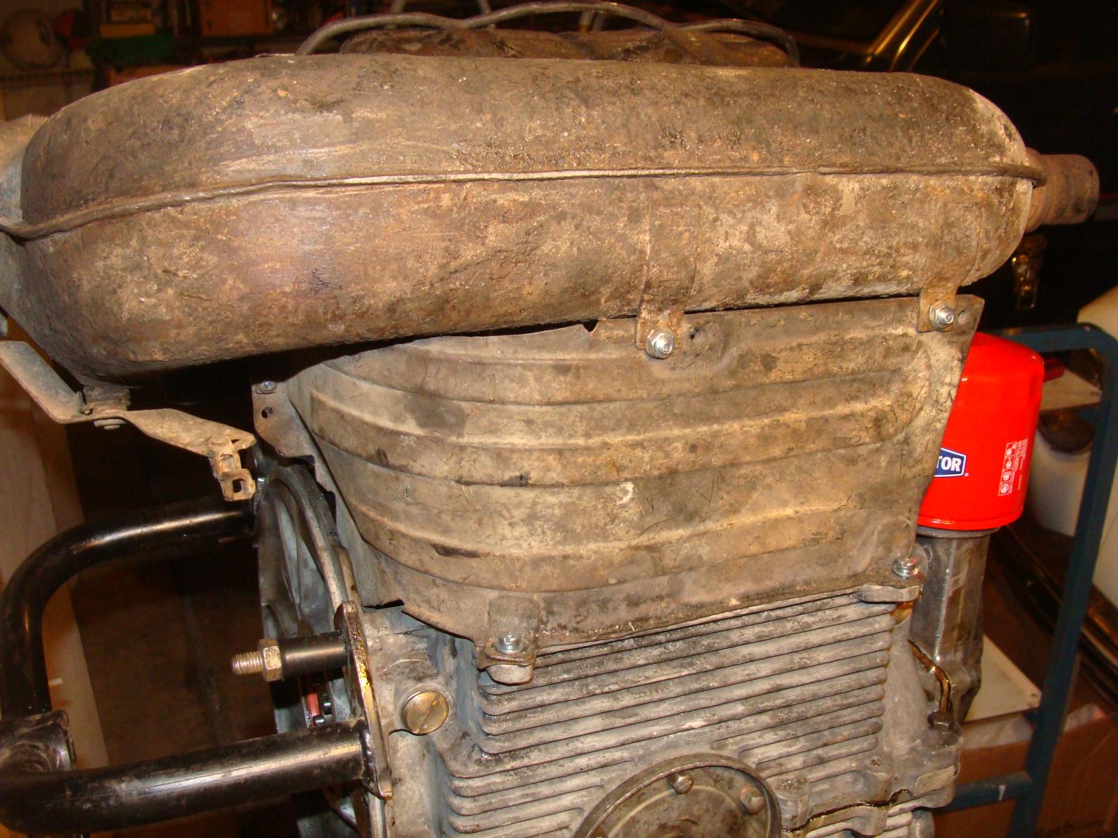

I have CB Performance Maxi2 oil pump/filters on both my VWs, one is 1835cc DP (installed 40+ years ago) and the other is 1600cc DP (installed 2016-2017). You really don't need to drop the engine to install these, but the pump cover needs to have a fin ground off so the pulley tin doesn't rub the crankshaft pulley.
They have versions for "flat" camshaft gears and for "dished" camshaft gears.
