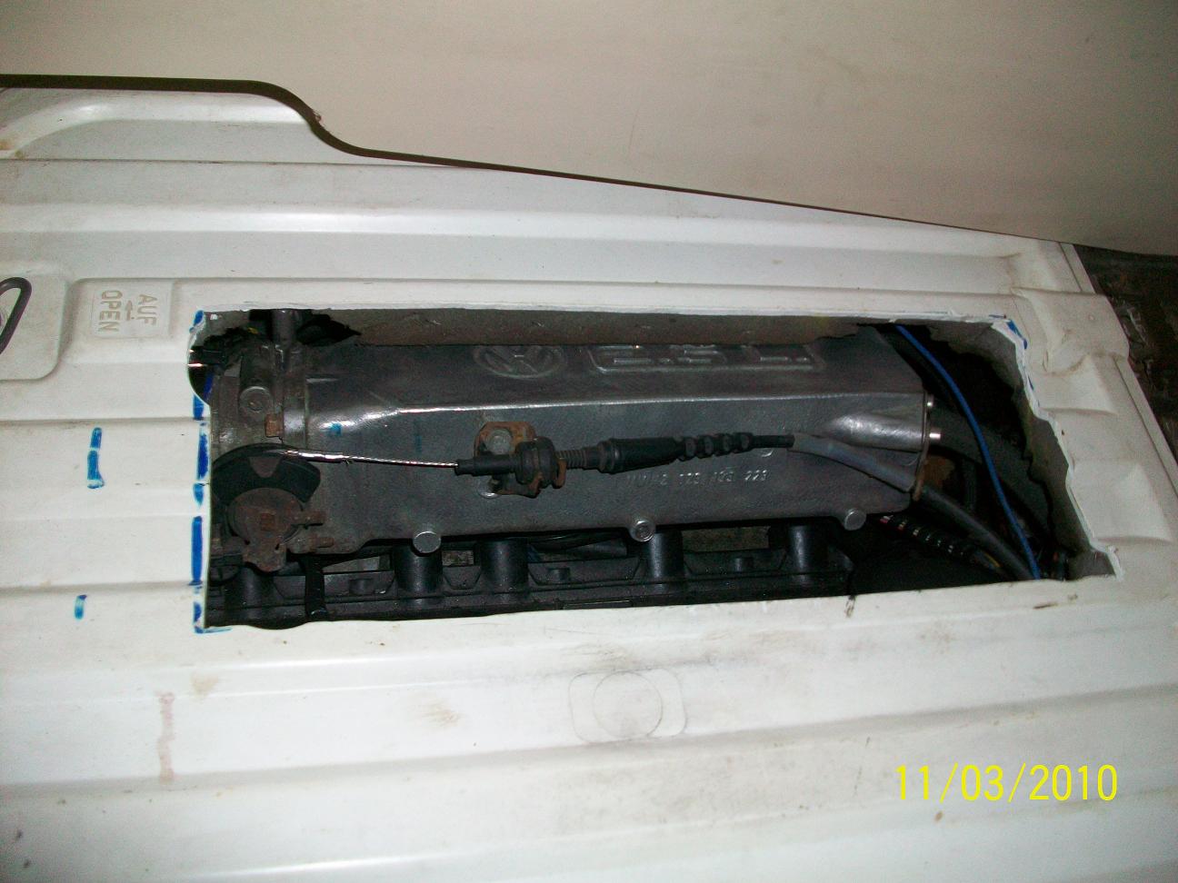

Yes the RSA engine lid is raised. Engine is slightly slanted but the intake and exhaust don't look close to the 07K anymore.

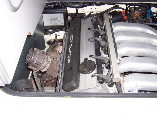

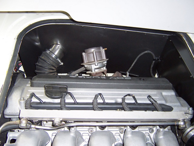

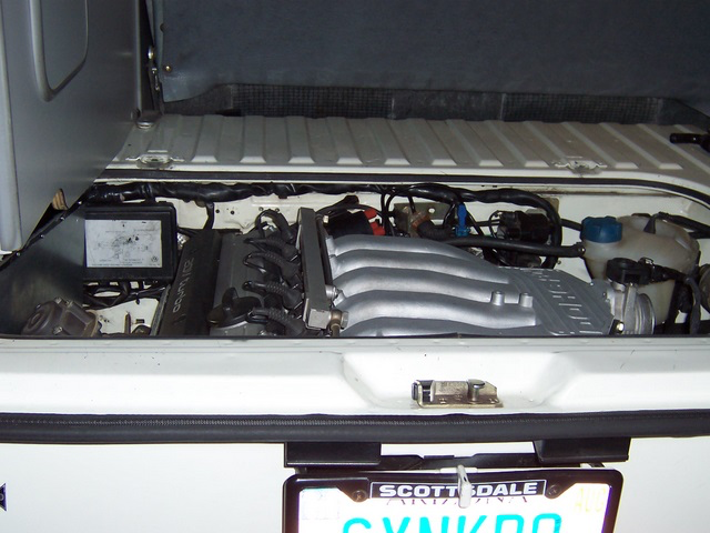

Coming from a long list of older Audis, I've come to love the 5 cyl, especially that sound!
ChillZombie, it looks like you've got a 3B 20vt pictured there with a 7a intake. In order to bolt one of those (7a/3b/Aan) you would need to find the elusive SA Bell housing. Great motors that pull like a freight train and no doubt an excellent match for a Vanagon but not really what this topic is about. An 07k shares very little with the older gen 5cyl aside from the number of cylinders.
That's quite the clean install in a Vanagon though and after seeing those pics it really makes me wish I still had my old '91 Avants!
I'd be curious to see what it would take to bolt an 07k up to a stock 6 rib 4spd. Any word from FAS if they can accommodate with the adapter and clutch/flywheel? After that, it's the same as any other motor swap, hanging the motor with a compromise between decklid and ground clearance.

TDC shop is run by a buddy of mine actually, Dave’s a good dude.
The 07k shares the same bell housing bolt pattern as a vw inline 4 cylinder, so the fast kit should work
Fine for that, engine mounts are the issue more than anything.

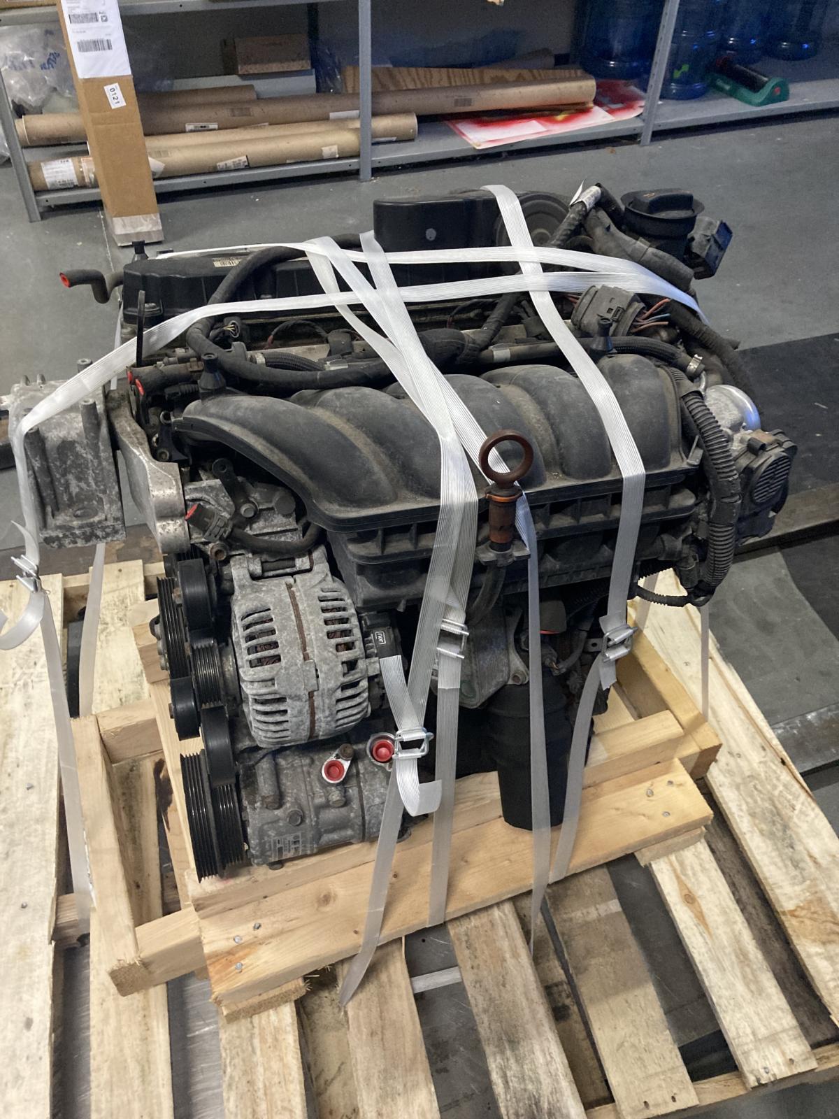

I have also been thinking of an 07K swap.
Thought about it so much that I even picked up a donor car.
This thing was pretty abused but it runs and drives.
The plan is to attempt a full Colorado emission legal swap by using all of the emission stuff from the stock car.
Anyway, that's a whole other topic.
Few things to note:
Yes, this technically will bolt up to all the VW inline 4cyl transmissions but you have to clearance the upper portion of the bell housing (or in van swap instances, the adapter) for the timing cover which is located on the rear of these engines.
As you can see the intake is pretty low on these engines so if one was feeling ambitious and wanted to fab an oil pan and pick up so you could do a 50-degree swap I would bet you could get really close to getting it under the deck lid.
other than the 50-degree arrangement you will definitely either need to drop the engine or raise the deck or some combo of both.
My 07K is part of a larger 4x4 swap so a lot of the things I am doing will not really apply to stock vanagons but I am thinking about a faster, lower, 2wd version that will use the same engine and be a relatively regular van.
All I need to do now is finish the 5 other projects I have going on an get started on a van.

PostPosted: Fri Nov 08, 2024 7:20 am    Post subject: Re: VW/Audi 2.5 5 cylinder 07k swap Reply with quote
I’m moving forward on 07k swap. Sourced a low mileage 2010. Still have some details to sort out but should keep me busy over the winter!
