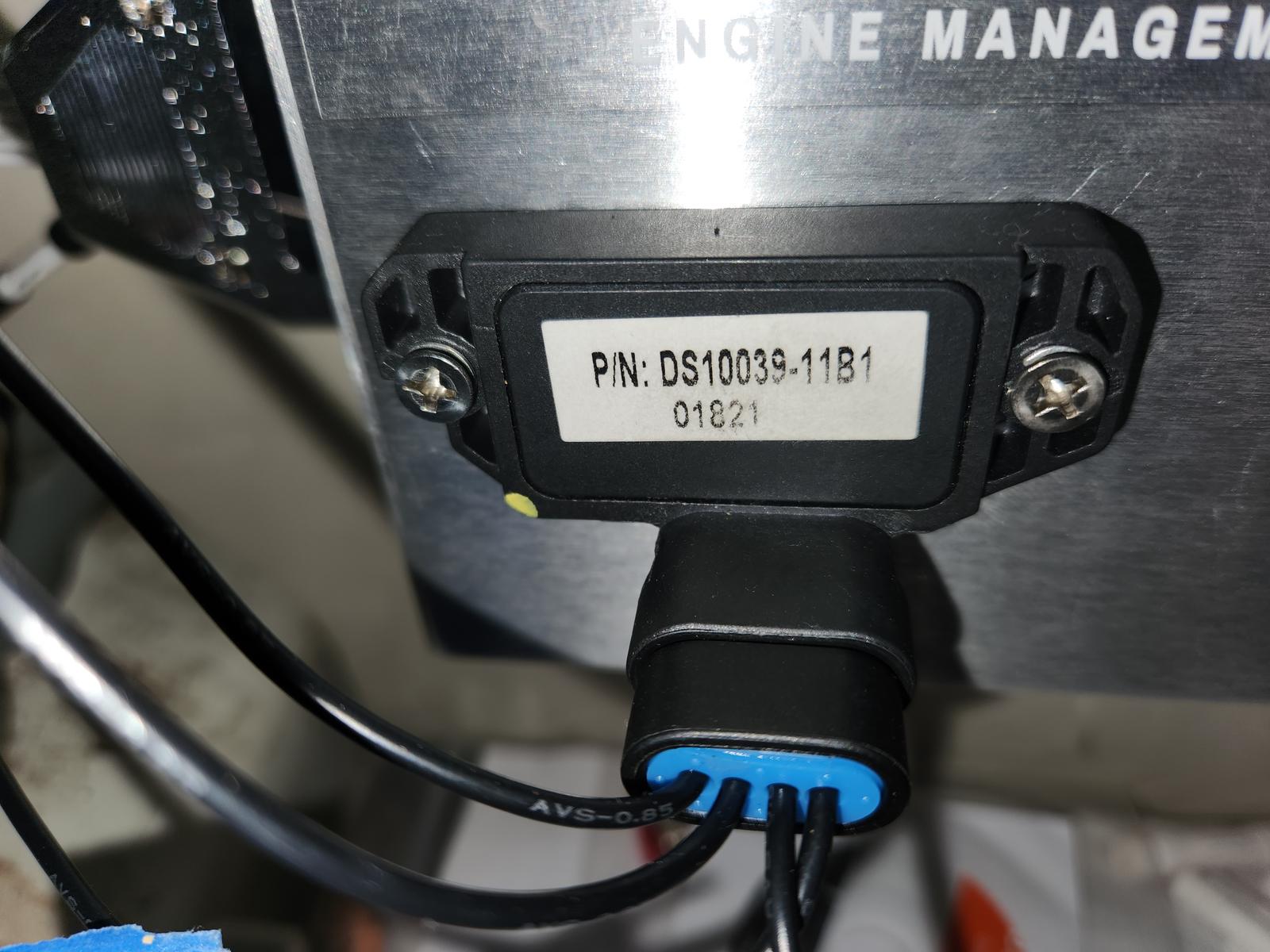

The black thingy I have screwed to the MSII case is an Ignitor, needed to fire the coil. The MSII can be configured to drive a coil, however, it requires some electronics work internally that I'm not comfortable doing, so another option is to use the existing ignition logic-output to drive an ignitor which fires the coil. This is a common ignitor unit and seems to work well with my van's coil:
The ignitor and the plug\pigtail for it were easily acquired at my local FLAPS. The ignitor normally mounts onto a heat-sink using heat-grease similar to how a CPU mounts. Not having a heat-sink, I simply mounted it to the MSII case using the heat-grease supplied with the ignitor, and it's running just fine, doesn't even seem to get noticeably warm at all.

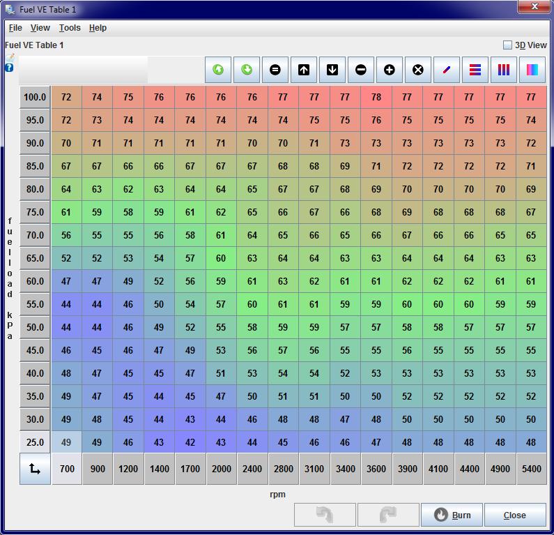

PostPosted: Mon Nov 20, 2023 2:07 pm    Post subject: Re: "Digi-John" Megasquirt-2 Project Reply with quote
Below is my current VE table; this table decides how much fuel gets squirted at any given RPM\MAP. This table was originally auto-generated using TunerStudioMS with values appropriate for a stock 2.1 WBX motor, and has been adjusted from there using the auto-tune feature. It is far from ideal at this point, but not too bad.
I'm only using the existing narrowband O2 sensor for EGO correction, and I have the MSII configured to use EGO correction below 70 MAP and above 1000rpm. Using EGO correction during idle causes my idle to get a bit touchy; these motors (or at least mine) don't seem to like to idle near stoich 14.7; it idles so much more smoothly a bit richer at what I figure is about 13.5.
I have this table intentionally richer than stoich so that above 70 MAP, EGO disables and the engine gets a richer mixture for higher-throttle applications.
My Butt Dyno indicates the engine runs as well as it did on Digifant, if not a bit better. I'll need to take a longer road-trip to get my fuel mileage values; at normal cruise, the O2 sensor is trimming the mixture towards stoich, so it should be just as good as the Digifant was.
The next step would be to install a Wideband O2 Sensor with its corresponding controller, and then I'd be able to more finely tune the VE table for different mixtures. But for now, Narrowband will do.
John G. - 1987 Westy GW 2.2 5-Speed
