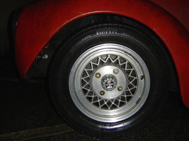

SHELBY INDUSTRIES : "DIAMONDBACK" Wheels
-4 Lug, Volkswagen / Porsche 914 Bolt Pattern 4 x 130
-15" x 5.5"width
-Backspace 4.25"
-Center Hole Bore 3.25"
-Solid one piece aluminum wheel
-36 Spokes

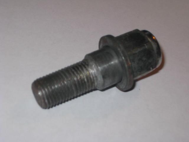

-Require Special Mag Lug Bolts with Washers

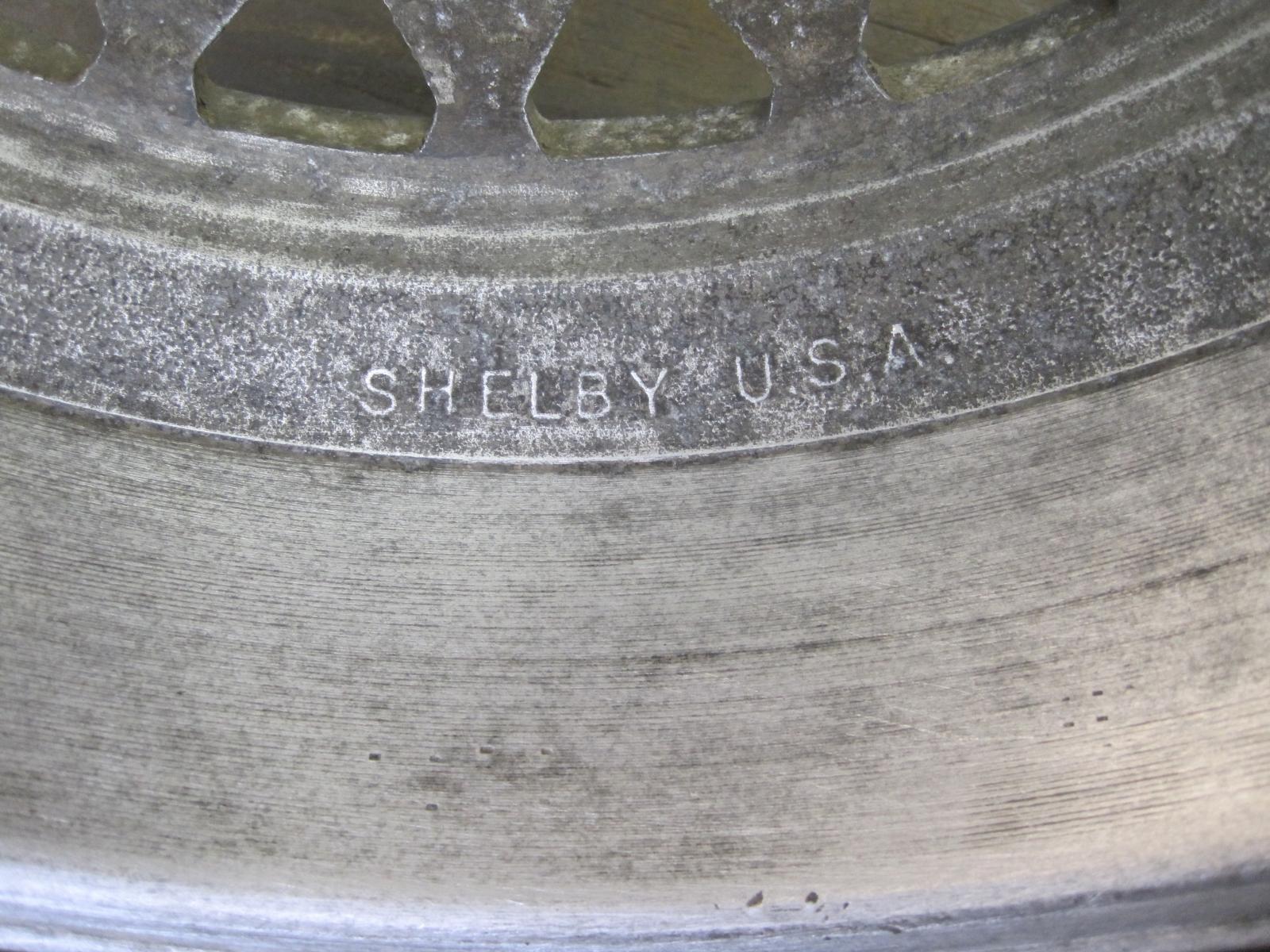

*These are embossed on backside with SHELBY U.S.A. 15 x 5.5
Fit: VW Beetle, Type 3, Type 4, Karmann Ghia & Porsche 914

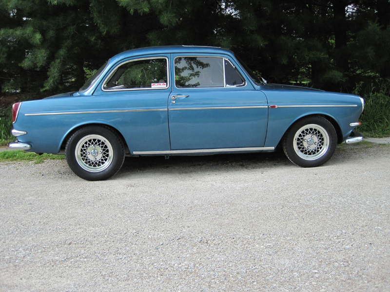

My first sighting of these wheels was over 15 years ago when I met theSamba member, Bobnotch at a VW Event and he had these wheels on his Notchback.
Bob's wheels are true Shelby Diamondback Mag Wheels that are embossed on the back inside.

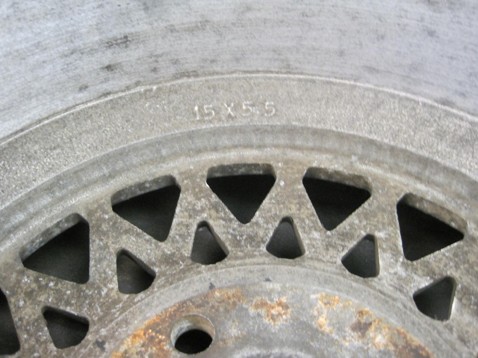

These were NOT embossed with SHELBY U.S.A. on the back inside but have the same 15 x 5.5 embossed "only", no maker or manufacture markings.
The measurements and appearance to the SHELBY Wheels are identical.

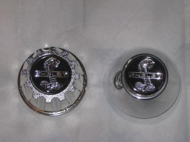

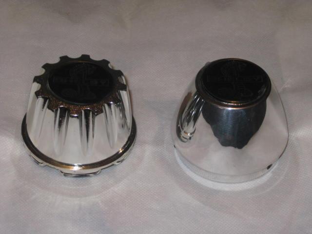

Here is what I have come up with for the replacement center caps that fit the 3.25 Center Hole Bore.
Left one is an eBay purchase, Chromed plastic push-in style and the ones on right are the ISP Aluminum Carrera IP with set screws. SHELBY center cap emblems were an eBay purchase, 1.75" across.

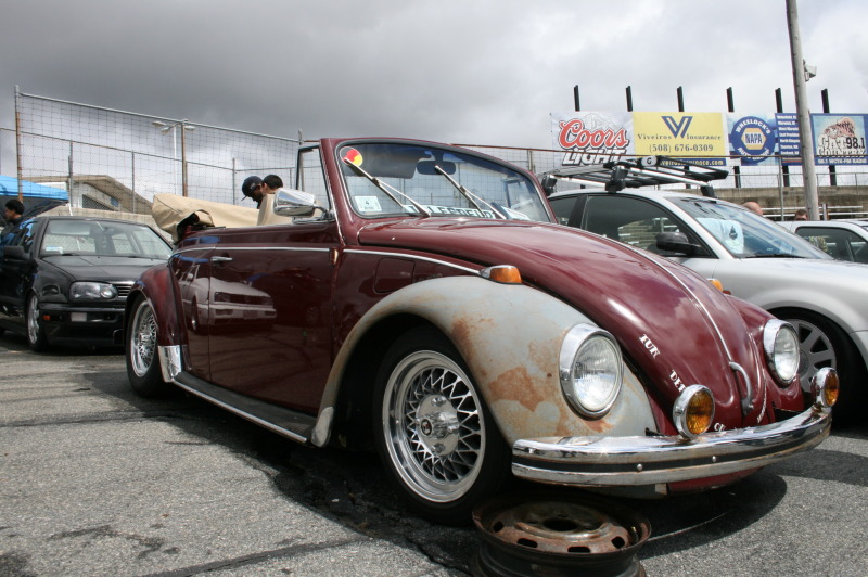

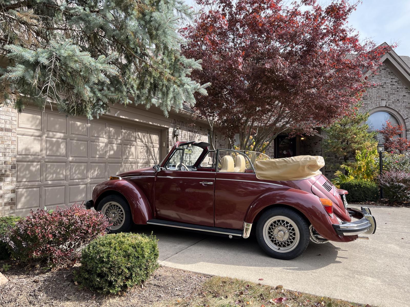

Here's a Beetle Convertible with wheels and they look sweet !

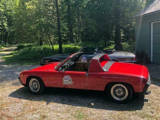

Here's a photo of the Porsche 914 mine were on. Good looking wheels.

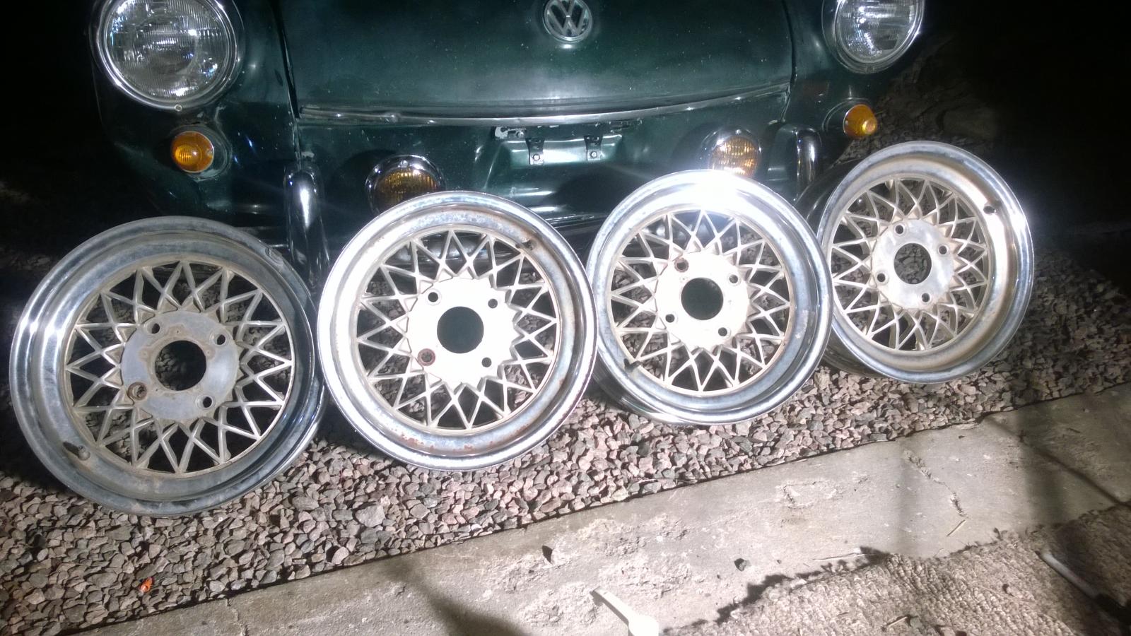

Here's a similar set of wheels ... 15 x 5.5, 4 x 130
Aluminum Center with Chrome Steel Rim, has 32 Spokes NOT 36 like the All Aluminum, valve stem lines up with spoke. Unknown Manufacture.
Any one with additional info?
Found out today that these are Trans-American Products Wheels which is the company to where this style originated. 32 spoke, RADER Mag... but looks like a Wire Spoke, "Spider" 1964

Mine look exactly like the Shelby wheels as far as valve stem placement and spoke count, but not a single mark on the back-side.

Yep, Then there like mine. I'm thinking their SUPERIOR "Diamondback" Wheels. I've looked at many other photos of wheel companies that made the "wire mag" wheel design and no others come close to looking so similar.

Any idea where to buy the washer lug bolts for these wheels?
superstarvw
Joined: July 23, 2015
Posts: 26
Location: Indianapolis
superstarvw is offline
PostPosted: Sun Nov 27, 2022 7:28 am    Post subject: Re: 4 Lug VW SHELBY Diamondback Mag Wheels Reply with quote
I bought EMPI 9511 (EMPI 9511 CHRME NUT/STUD KIT W/FLAT WASHERS M14-1.5 TO 1/2-20 MAG WHEELS) lugs/studs on eBay, and they worked for me. My seats were a bit torn up when I bought them, but I think these fit and didn't do further damage.
