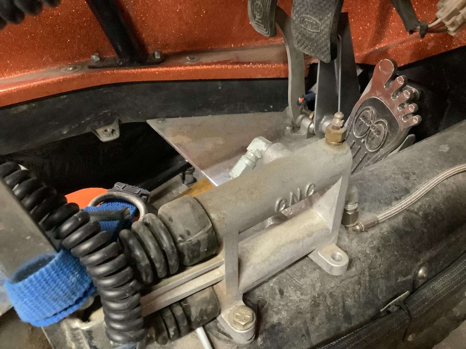

Is there any source for rebuild parts for my Neal turning brake cylinder?
It has CNC dust boots so I was wondering if there was a CNC kit that would work

Thanks, I have given up on the master cylinders and am replacing all three with Wilwood, they are not visible unless the hood is removed so not a big issue with the restoration.
If the turning brake leaks I may just by-pass it, not like this FAV is ever going to run any Baja races, well maybe after the estate sale but that will be someone else's problem.
Are there any tricks to bleed a system with turning brakes?
ALSO is there a "standard" way to hook up a single handle cutting brake?
I wish I took more pictures, I thought mine was set up for pull left, push right but now looking at the fittings I am not sure....l...

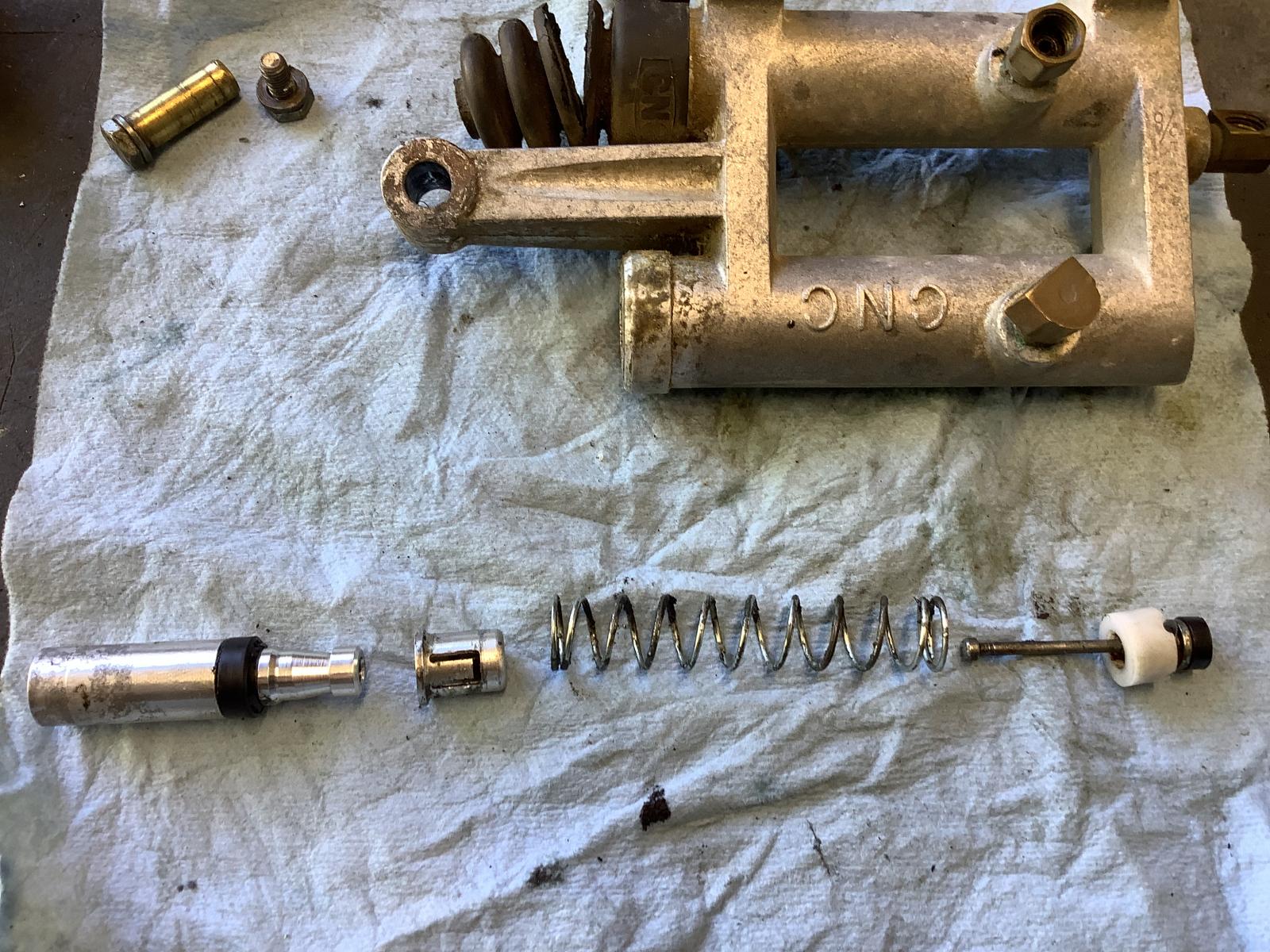

PostPosted: Tue Nov 29, 2022 11:33 am    Post subject: Re: rebuild kit Neal turning brake Reply with quote
This what it looks like inside a CNC 5/8” single handle steering brake. The cup seals look the same as a picture of a Girling master cylinder rebuild kits I have found online.
This a Neal steering brake in my Wampuskitty
Later CNC steering brakes added a bleed valve on the top to help
What I use is a vacuum bleeder but have to make sure wheel cylinders are above steering brake to get all the air out of the system with the ones without the bleed valve on steering brake
