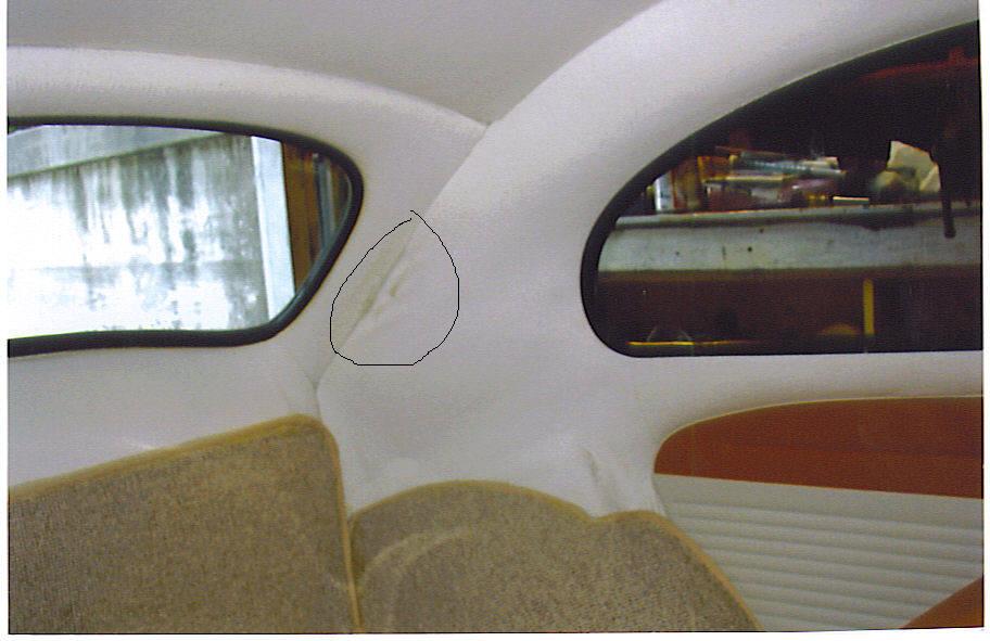

Here is a cutting mistake on my first one. Leave plenty of material so the panels cover the liner. Note my patch.
Another mistake on the first one was not getting the prongs down tight on the plastic strip holding this section in. There is no fix for this after it's done.
The entire liner was redone a few years ago, but there is a body or two buried in it too. Just not as obvious.
This is the redo and the last. I don't want to ever do another one, but you really should do at least one. You can do it well if you "take your time"
