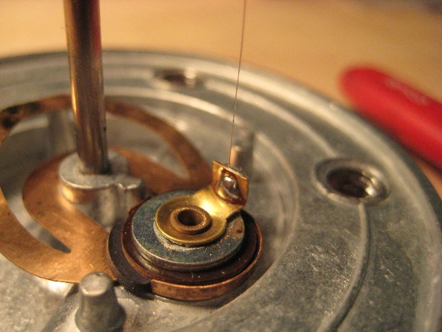

OK. here you go. I went to Jacobs Online and bought the 40 gauge nichrome.
Then came the hard part. This stuff is very thin and hard to work with. You have to run one continuous strand from the top (bottom in this picture) around the bottom (top in picture) and back to the top again.
Along the way it has to go through the metal tabs of the float like this...
It has to contact the wire on both sides. As the float moves up and down it effectively changes the length or wire as so the resistance and that gauge moves accordingly.
The hard part is soldering the wires while keeping them tight. The good thing is that the minimum order from Jacobs gives you enough wire to practice with.
The trick was to put something under the springy part (on the left side in the photo) while you solder it.
It still didn't give me a full sweep on my gauge but it gave me a full to just under half sweep. It is enough so that I know where I stand fuel wise. on of these days I will mess with changing the input voltage to give me a full sweep, but for now, this works.

I've looked so long for this mountain minstrel, hopfully this helps a few more people wanting to save a few bucks. you've basically covered the whole procedure with pictures. Can't thank you enough now I can get my beautiful bus back on the road agin Very Happy
