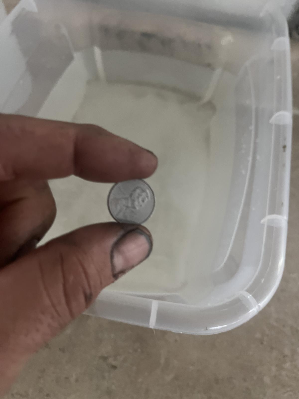

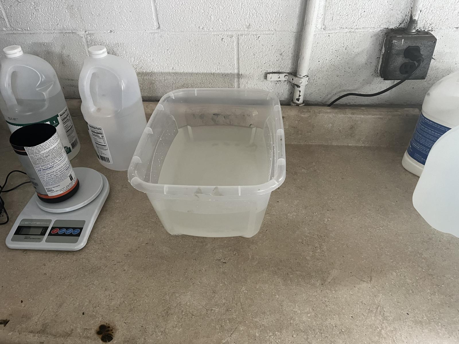

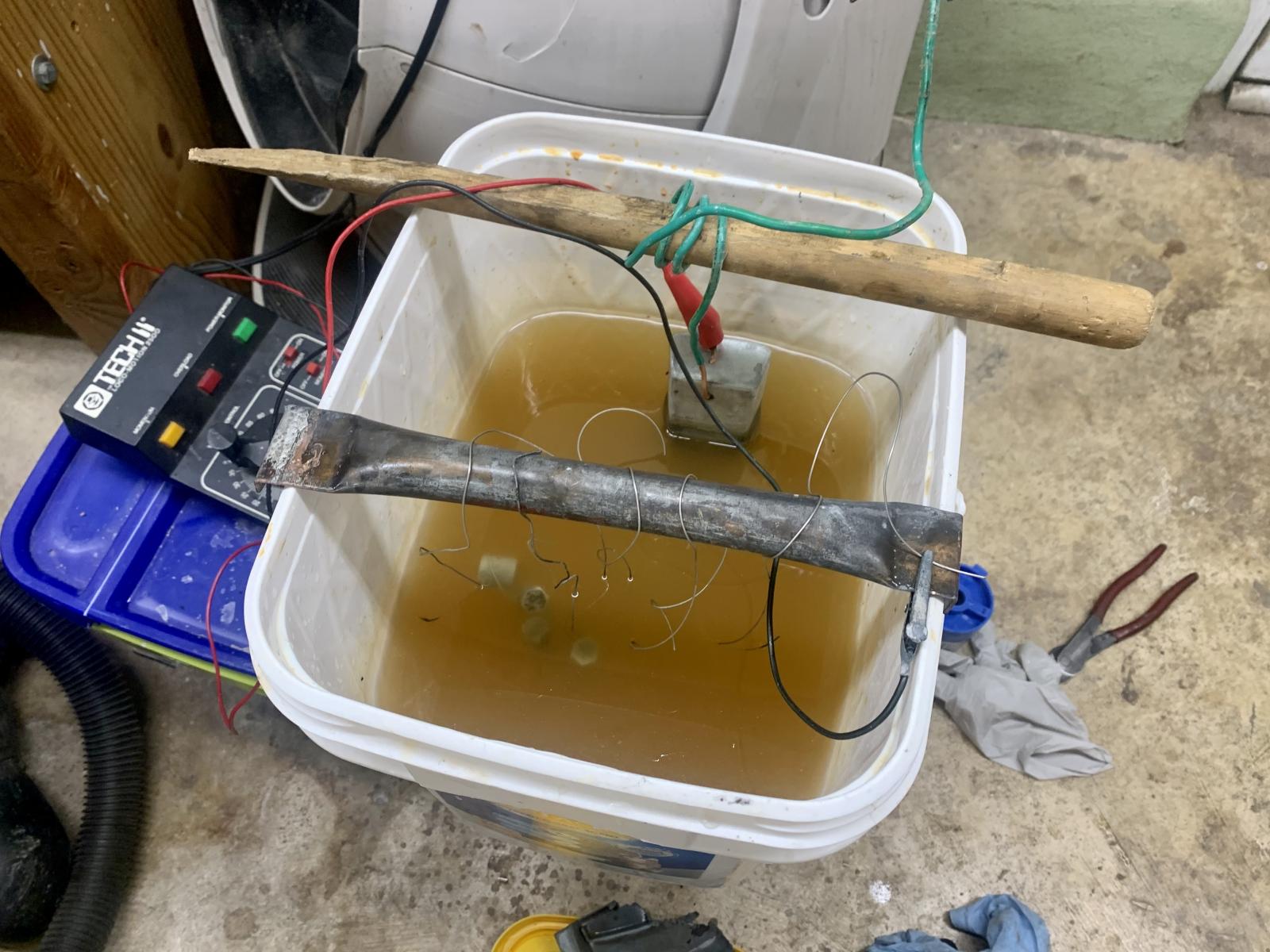

Your issue was due to “shading”. The plating only occurs from a direct line of sight from your anode.
I dropped multiple anodes in & rotated the parts occasionally while dipped. I would remove the parts, buff them with a brass bristled brush, & dip them again.
TDCTDI wrote:
TDCTDI wrote:
Well, I have gotten completely sidetracked trying to source all of the supplies necessary to do this. Bins, digital scale, vinegar, Karo syrup, salt… it’s more like I was trying to make pickles or brine a Turkey instead of trying to plate metal parts. Shocked
I also got muriatic acid & some drain crystals to clean & etch the parts, the only thing that I’m missing is the zinc anodes. I tried the usual suspects, hardware store for zinc flashing, nope. I even went to a local boat store, but since most of the nearby bodies of water are fresh, they only stocked magnesium anodes.
So I tossed a few pennies into the blast cabinet & blew the copper coating off.
And tossed them into the brine to get a bit of zinc into solution until the anodes show up.
With all of the charging adapters that are laying around, I figured that I could scrounge a power supply somewhere without too much hassle… huh, that cheap digital scale just came with one.

i had a set up with a motorized hanger system that woudl rotate and rock the parts while they are int eh solution. the obvious advice i give to new platers is to make sure your parts are totally clean and that youre going slow and long not fast and hot, unless its with a silver plated bond model, then by all means....
