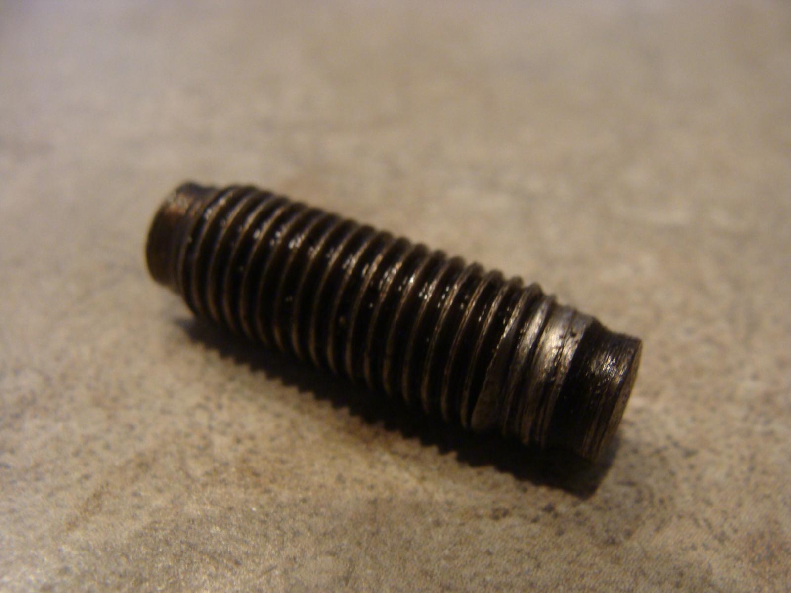

I rebuilt my 1600cc engine in 2017.
A few months later I noticed this. My adjuster and the adjuster nut were found in the valve cover.
I ordered a new adjuster and a new locknut from an Ebay supplier, and the engine has been fine since, don't know how this happened. That was a factory 1971 engine I rebuilt, and the vehicle has been mine since 1976, so I cannot blame any previous owner.
