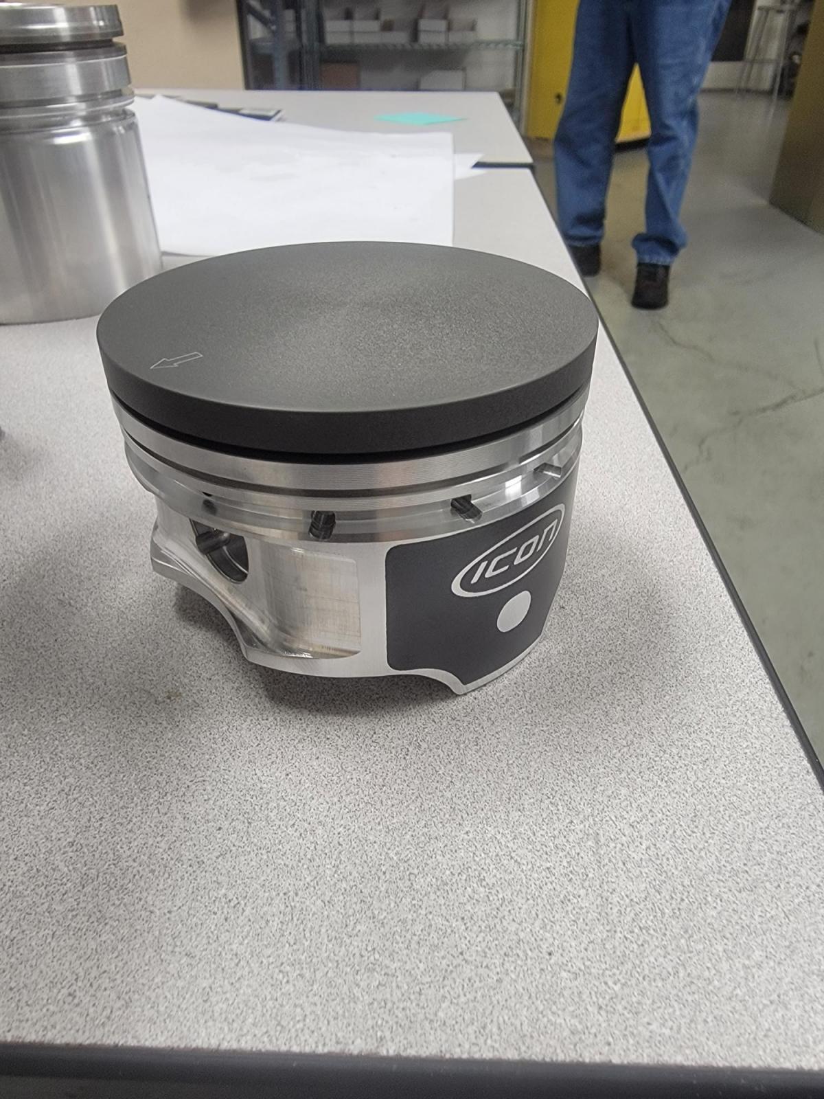

Hi guys,
I've been working on this for a while , but I am happy to finally announce that we now have some new options for performance VW pistons. I work for United Engine and Machine who makes ICON, KB, Silvo-lite and Dualoy pistons and I am pretty passionate about our hobby and have found myself in a unique spot to try and offer a Forged Piston to others that I would use myself.
IC10069 - 94mm "A" Comp height
IC10070 - 94mm "B" Comp height
IC10071 - 92mm "A" Comp height
IC10072 - 92mm "B" Comp height
quick glance features
-Forged 4032 Alloy, Higher silicon content allows tighter piston to wall clearance than a 2618 forging. piston slap is greatly reduced on cold startups.
-Anodized Crown and first ring groove to prevent ring micro welding and abrasion protection with an added benefit of acting like a thermal barrier
-1.5, 1.5, 4.0mm ring pack. We wanted to use a ring pack that would stand up to boosted applications but also be easily sourced should the customer want to go with a total seal ring down the line.
- Full round design provides strength where it counts giving rigidity to the skirt where it is needed.
-Double broach and forced pin oilers, keeping that pin lubricated is critical in a floating pin application.
-M42 skirt coating protects against dry starts giving abrasion protection on engine start.
If you have any questions please feel free to ask. Thanks guys.

I like the width in-between the bosses, but that top land is awfully thick and the piston looks heavy. The latter hurts more than it helps. We need more ~350g bare pistons to help reduce crank flex.
"A petrol engine can start readily, run smoothly and give every appearance of being in good order, without necessarily being in good tune." - Colin Campbell, "The Sportscar Engine"
modok
Joined: October 30, 2009
Posts: 27645
Location: Colorado Springs
modok is offline
PostPosted: Tue Jan 10, 2023 8:50 pm    Post subject: Re: ICON VW pistons Reply with quote
If it's too thick you can trim some off, far easier than welding it back on. Razz
The pin looks short, that will help save weight. Can't please everybody.
Looks like a cummins B piston back there too

A cheaper piston isn’t going to have .010” ramping to remove material. It increases machine time by multiples. You can’t get a cheap piston made correctly that’s got everything done. . I imagine they are made from an existing forging or I’d never consider having new tooling made just for vws. I’d never consider it. Be happy someone is. The amount of time and money it takes to produce a new forged, machined part isn’t cheap.

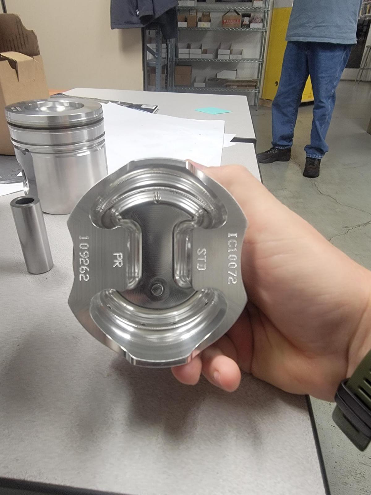

Are the pins offset? Seeing the arrow on top makes me think yes they are offset. How much they weigh would be nice to know also. Great to see someone is doing a 4032 piston. I am interested in a set for the Berg GBF crank carrillo rod 2387cc engine I am collecting parts for. Already have crank, rods and 94mm revmaster long cylinders.

Pin is 2.500 long , .160 wall thickness. weighs 113 grams . if someone really wanted to be a weight weanie (joking) Laughing you can find 2.5" chamfered end pins with a .120 wall closer to 90 gram mark. If I remember right Trend has one that is right around 85 grams. Yeah that cummins 5.9 piston is 7198D from our Dualoy line.... Fun fact, the Alfin bonded ring was Pioneered by United Engine and Machine...We did it first and for many years were THE standard for Heavy Duty Iron first groove pistons. Wink
Ebel You sir are correct. The head mill process does add more time to the machining ... but in this case we are talking maybe 3 minutes per piston not enough to drastically alter the cost of the piston. In the future we are looking at changing the core to the forging die to hopefully eliminate that process.

Dan , the 94B's are right around the 385 gram mark with a pin weight of 113. they are offset pin for quieter operation like the factory piston. Shoot me a line I would be happy to quote ya. 1-800-648-7970 extension 114
