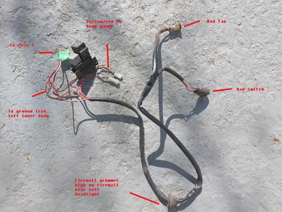

I just pulled the radiator harness from an '85 yesterday. Super simple stand-alone harness, as Markswagen stated.
(Note this harness has the 'early' 'tall 43' relay that pegs the temp gauge on top of flashing the oil light when you are low on coolant)
Nightmare to route this with the dash in, gravy job with the dash out.
I'd consider scraping up a harness and just installing it complete - maybe a 10 minute job tops ONCE the dash is out.
