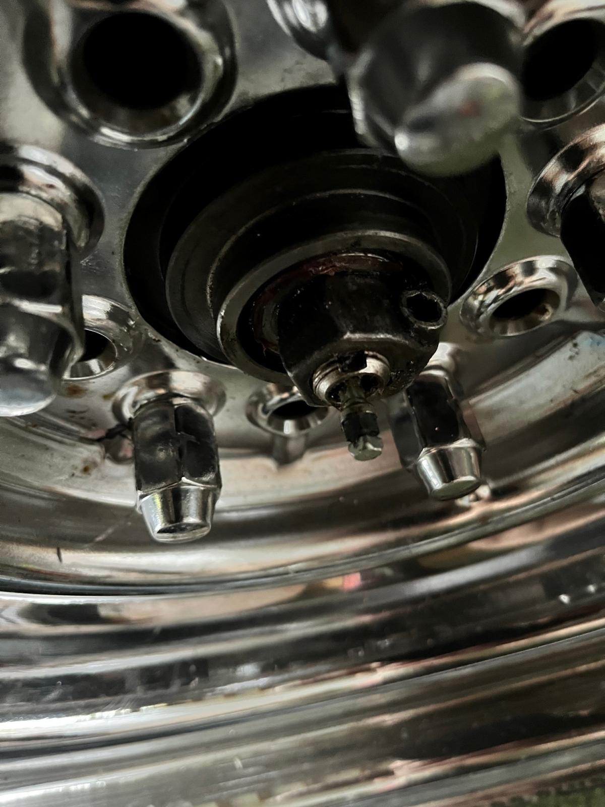

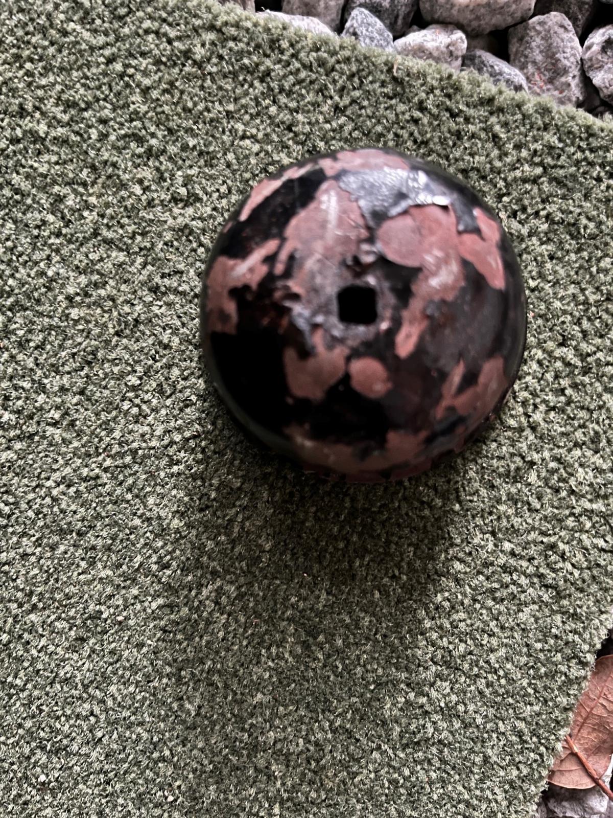

Took hubcap off drivers side front wheel and saw the bearing cap with the speedo hole in it.
Protruding from it was the end of the speedo cable. But, there did not seem to be anything holding the cable from coming out further into the cap or pulling back behind the disk brakes. Is there supposed to be some type of clamp to hold the speedo cable in the correct position? If so, where do I find this clamp and what is it called?

Just a C-clip over the end of the cable, the slot right at the "square" at the end.

The cable tends to stay in place without the C-clip. But, I would get one on there for good measure.

Yes, from the Gallery (not the best pic):
For reference, I believe it's a 4mm E-clip, not a "C" clip.

Over the years I remember seeing one with a cotter pin through end to keep cable in cap...

On my buggy I had an issue with the sheath or the outside pulling out of the spindle so i drilled and tapped a little set screw to hold it snug worked great
