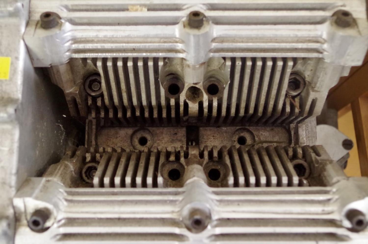

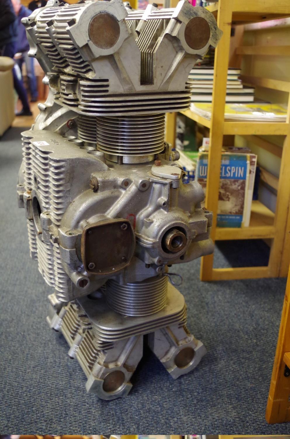

I can't hold myself... Must show you guys... Laughing
I just bought a REALLY strange engine and what you see is what I know, because that's all I've seen to! Rolling Eyes I bought it as is and have to wait to getting it home (1100 miles) so I can see what's in it! NOT a clue... Shocked
But you can see that the case is from 24.9.46 on the last picture. 🤔
It is 16 valve and 4 cam... and it's not finnished!
Maybe someone tryed to make an aircraft engine, but then it should have double sparks.
We'll see...

Nice engine ...it does look to be an airplane engine ..its been shown that 4 valve heads don't work vary well in an aircooled engine there's always problems with the exhaust valves on 4 valve air cooled engines ... I can't wait till you open it up to See what's in it ...i hope you can show pics when you do 👍 ...how much you buy this engine for ?? And what country???

Wow! Are those Aluminum Cylinders? Can't wait to see how the cams are chained to the crank! What were you thinking of running it in?

German-made Vogelsang VW-based engine for German WW2 navy landing craft? The aluminum parts actually look almost too good/uncorroded to be that old.

The heads look to be billet too... I doubt they were doing billet aluminum in that time and the alan wrench bolts on the cam covers seems new age to me to ..i think someone got a 46 case and build it ..heads were build maybe20/30 years ago but who knows i could be 100 % wrong it's my guessing ..

We'll see if we can find out more about the machine!
I got a winning bid at an auction in UK, England... But I'm from Sweden...
It was an ordinary irl auction with Internet function and this lot was the only engine part together with books, paintings and other shit stuff! So I got it quite sheep... MAYBE... 🤔
I'm not sure what I'm going to do with it... 😂 Need to check it up first before I make a plan...
But I'm working on a -65 panel bus with a quick change system for swapping the complete powertrain! 😁 Maybe parts of this can be something for that... 🤔
I can't agree more with you both... But it's still a mystery...
Who the fuck did all that and WHY...??? Am I going to find a total failure inside? Why killing a case from 1946 in "modern time"? Is it totaly billet or lots of casting?
I try to get in contact with the seller (thrue the auction company) and see if that's ANY history available!
Is it somebodys father with technic skills and his own work shop? And he just passed away...??? OR WHAT? 🤔

I know the heads are not finished ,or have many pics of it yet .. but what I was thinking is how would the oil for the cams enter the top intake cams and also how would the oil drain from the top to the bottom. the porsche 4 cam has a tube from the intake cam to the exhaust cams for the oil to drain to 🤔🤔 maybe the person didn't think of it but I can't wait till you open it up and show us what's in it ...im a big big fan of stuff like this I love how people come up with new ideas that no one has seen ..it gives me more confident to make stuff like this do to the fact if they can build stuff like this in there time for sure we can do it with all the technology we have compare to them and they did it come on folks use your brain and start making cool heads for our vw 25hp,36hp,40hp engines 🤔👍👍👏👏

🤘😂 I also had my thoughts on the oil, but I wait... 🤔
I like when people are using their brains for fun tech... And my personel problem is to much thinking, to many thoughts, to many projects and to less time... 🤔

Perhaps Subaru cams will bolt right in .

Propobly not! Different CC between the cylinders...
But maybee Porsche 356 Carrera... Sounds sheap! Not... 🤔

That must be one of the coolest engines I have ever seen!!! You can be really lucky.
It was like a trend in the 50's to modify especially 25hp aluminium engines to 4 cam engine. I heard people were also using Lloyd Alexander heads. I find it interesting to see casted parts for a unique engine, always have to think about the effort, time and money to build these parts in a small number of units.
Regarding the issue of missing oil in the heads... looks like the oil cooler was placed somewhere else, so tubes could also supply the heads with lubrication?
Can't wait to see more pics and how it looks inside!!

is anyone else thinking the cam covers look to be different to the heads/timing chain covers?
not only the alloy a different colour, but some of the details and there looks to be more grot in the fins of the heads.
possibly a later attempt to finish the project off??
i like how you can see the layout markings in the first picture.
