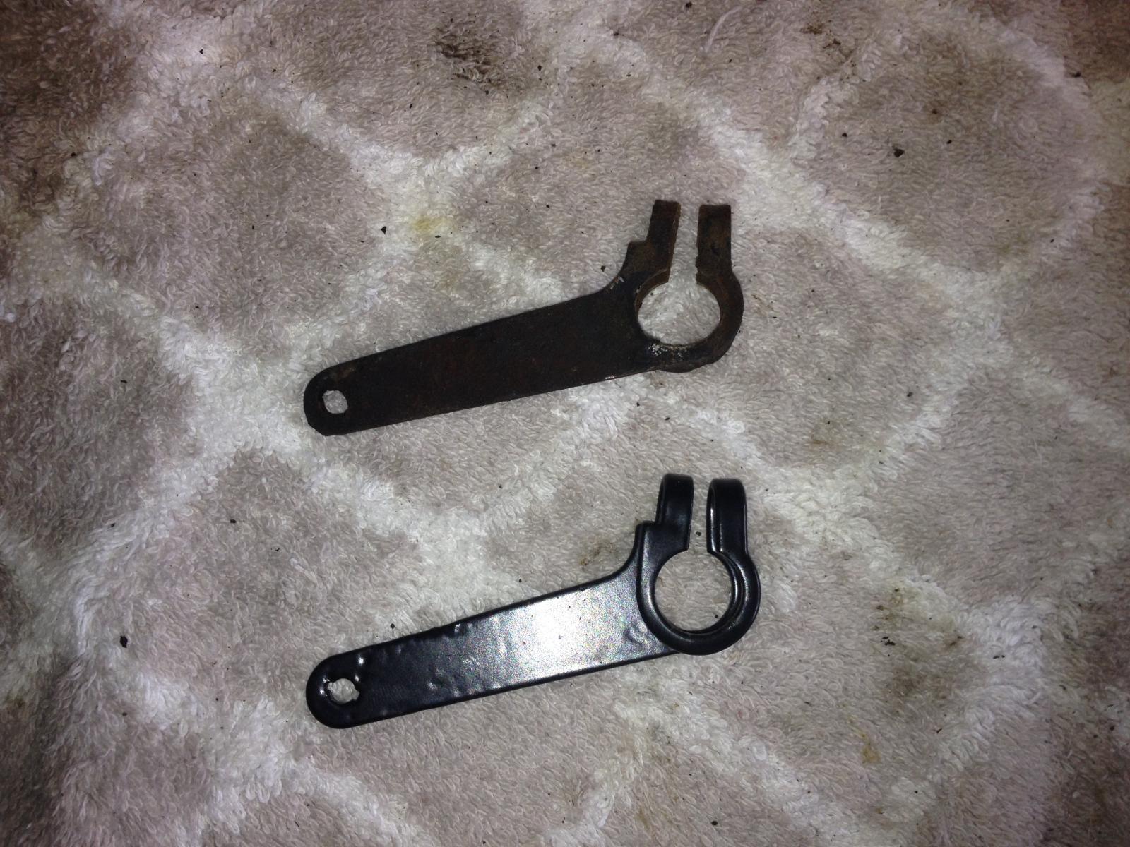

i'd like to update my previously incorrect statements above. i did some measurements between 36hp and 40hp thermostat parts, and here's what i've found:
for future reference:
Comparing 36hp to 40hp stale air thermostat parts.
Most parts are not interchangeable due to dimensional differences.
36hp on the top, 40hp on the bottom.
Aside from the thermostat throttle ring and its mounting hardware, and the thermostat bellows (for the most part), these are the pieces that are interchangeable between 36hp and 40hp:
Tension spring, mounting hardware for pivot piece, "C" clip that holds the throttle ring pivot piece to the stud, 15mm long bolt and flat washer for the thermostat bellows.
At a quick glance, the pivot piece looks the same. However, the arm is offset differently between 36hp and 40hp.
Theoretically you can use a 36hp arm on a 40hp, but not the other way around (it will hit the engine tin).

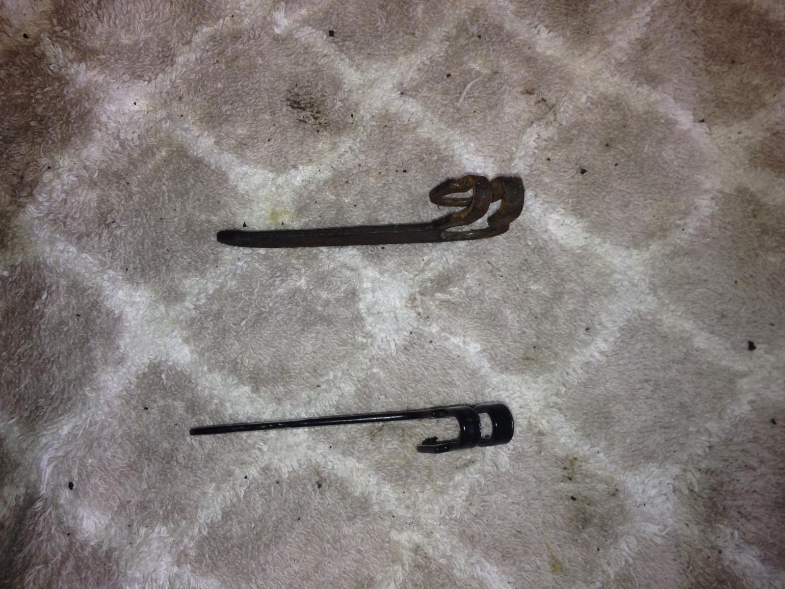

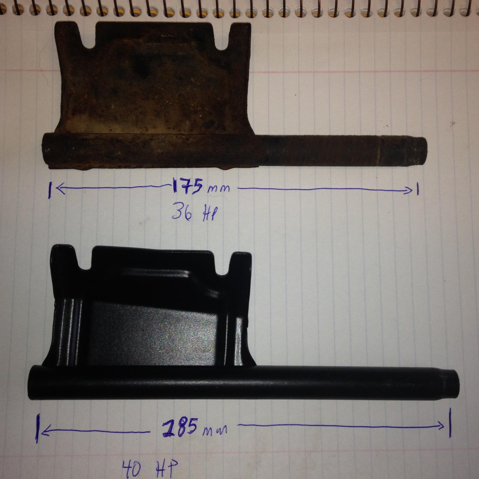

Dimensionally, the thermostat throttle ring pivot piece is longer on a 40hp.
Overall length of the throttle ring pivot stud is longer on a 40hp. Threaded part is nominally longer, but the non threaded portion is longer.
36hp is shorter, and the rod is fairly straight. It also has a shorter bend at the bottom.
40hp is longer, and incorporates more bends in it.
36hp on LEFT, 40hp on RIGHT.
