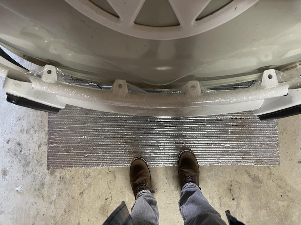

I found a great way to add lights to the front bumper. If you go to an industrial hardware store, in the prefab metal tabs for welding. Pick part 181, one per light.
Layout where you want the lights.
Remove the four bolts that hold the overrider. Just a bit of grinding and off to the welder, from there off to the powder coater.
Wait for call, go pick up.
When you get home, take Dremel and expose a quarter sized patch on the bottom of the tab to insure a good ground.
Re-install the override with the same 4 bolts and mount your lights.
img]https://www.thesamba.com/vw/gallery/pix/2371637.jpg[/img]
This can be done even cheaper if you can do your own welding and simply paint the overrider.
The welding tabs are great for what they do. Lots of sizes and shapes.That's what I did.

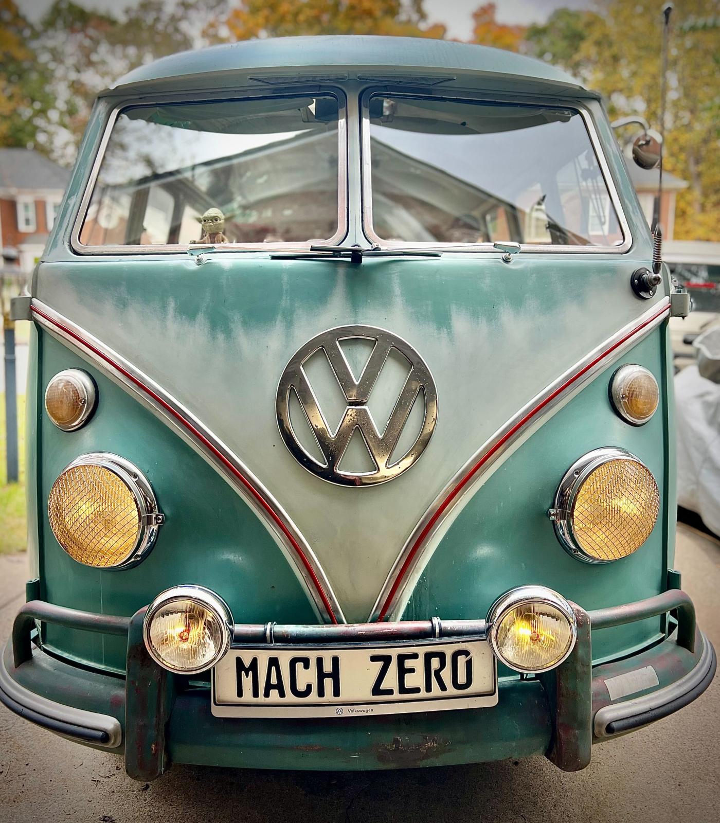

Here are my LED head lights and the "mount" for my driving and fog lights

Some random dude: Wow, why do have so many lights on the front?
Me: yes.
