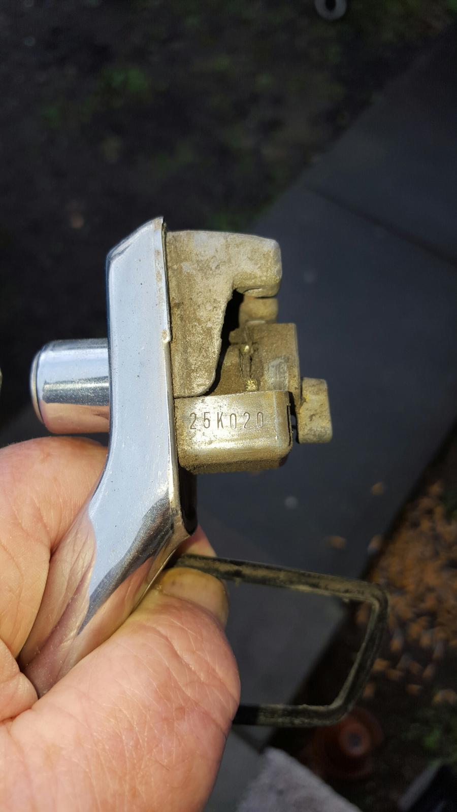

PostPosted: Sat Feb 18, 2023 12:47 pm    Post subject: Re: Lost Keys Reply with quote
Search is you friend
Remove your door handles. The code is stamped on the mechanism.
https://www.thesamba.com/vw/forum/viewtopic.php?t=255124&highlight=key+code
Pic from 67Rustavenger's gallery
For getting keys cut, some locksmiths can cut from the code
Some vendors on here do too. Check seller feedback before ordering
