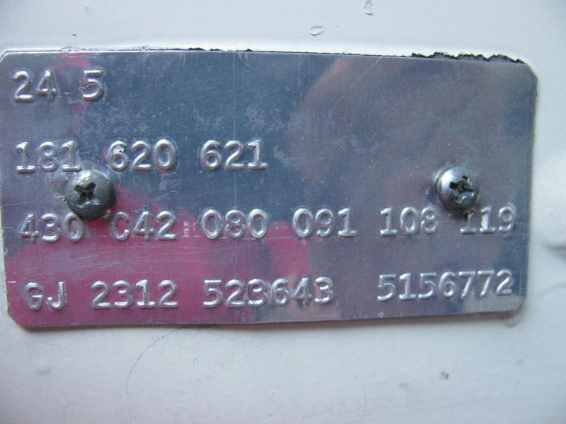

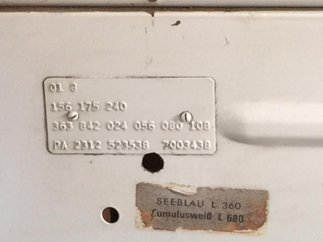

Paint Codes:
All SO42 converted at the factory came with a paint code that starts with 523. You can find more info about Westy paint codes here.

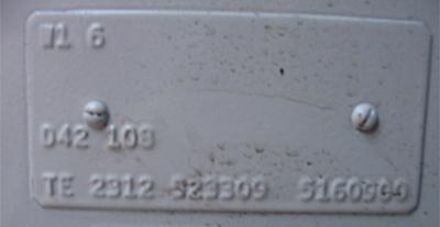

Fabrik Number: Each kit was assigned a fabrik number. The oldest kit known is fabrik 14 which was built on Tuesday January 19th, 1965.
The youngest known fabrik number is 12792 and it was built on June 19, 1967
If you have an earlier than 14 fabrik number or later than 12792 fabrik number, please post it in this thread

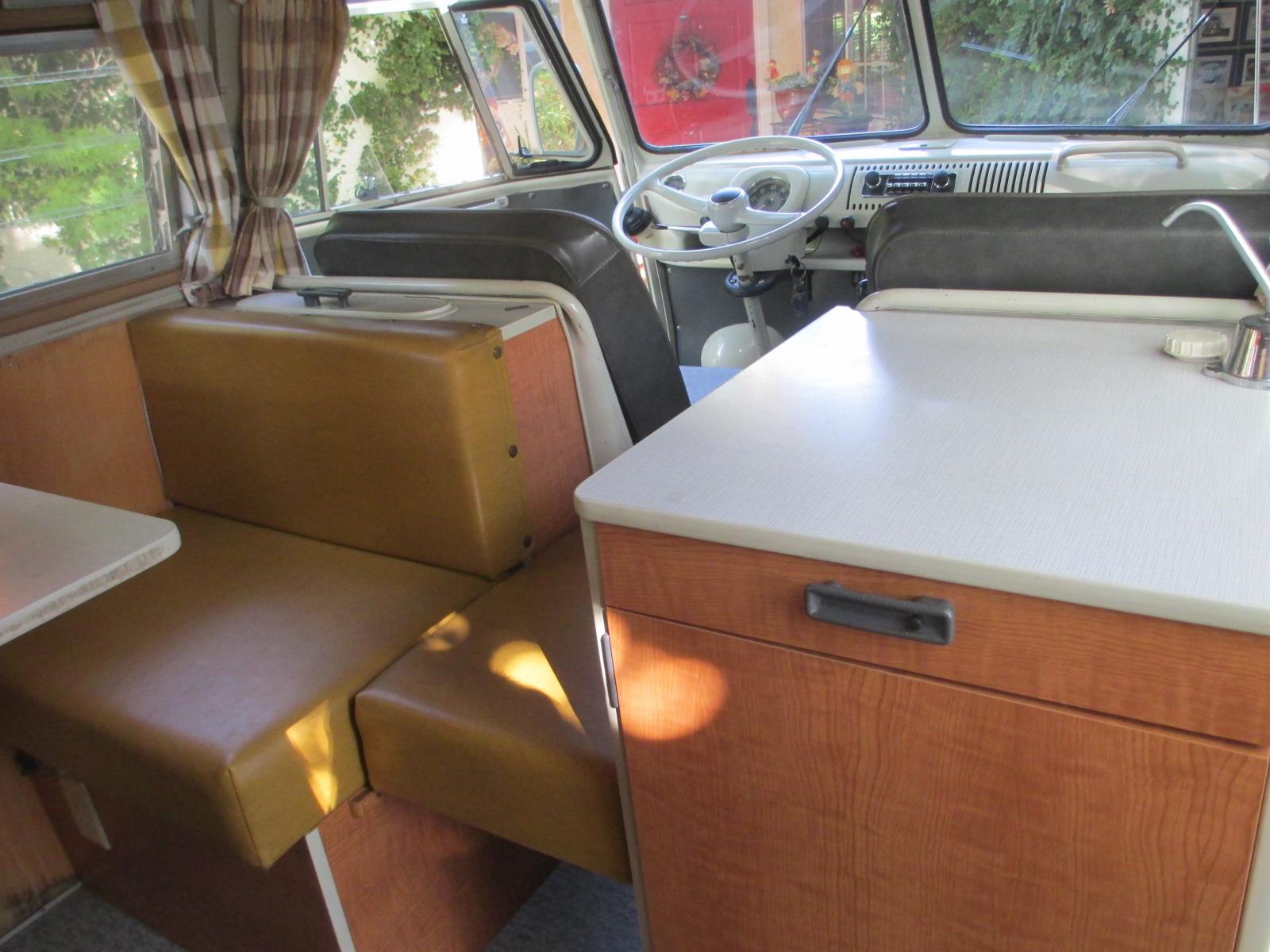

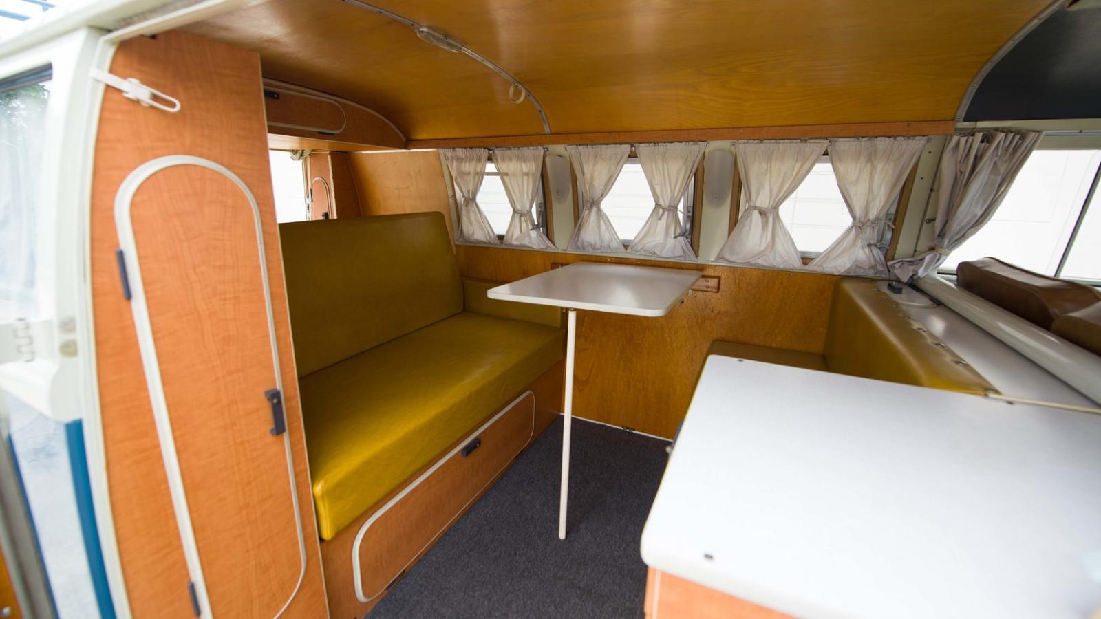

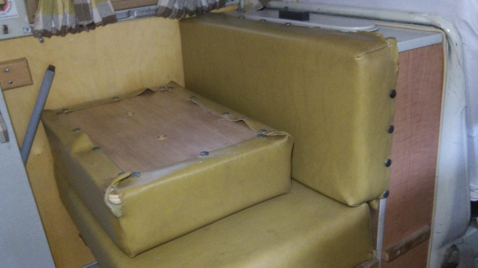

Differences between the walk thru kit and the bench seat kit:
Walk thru have a smaller rear facing seat as well as a jump seat between the rear facing seat and ice box. The ice box on a walk thru latches to the back of the passenger walk thru bulkhead.
Walk thru:
Walk thru jump seat:
Walk thru kit does not have a corner cabinet in the rear left hand corner or molding as the spare tire is located there with a tire cover.
Walk thru spare tire with cover

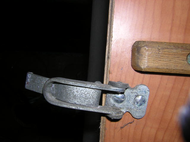

Walk thru fridge latch:

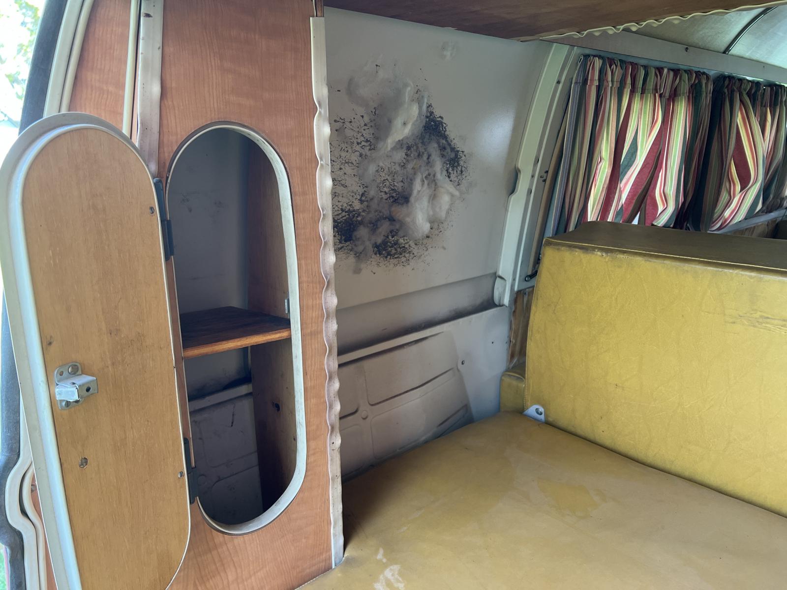

Bench seat models have a larger rear facing seat than a walk thru and they do not have a jump seat.
Bench seats have a small closet in the left hand rear corner near the rear hatch. It also has a molding with a striker plate and hole for a rear hatch latch.
Bench seat ice box pictured on the right with the cut out for the spare tire well on the bulkhead. The ice box on the left is a Bay window
Bench seat:
Bench rear facing seat:
Rear cabinet bench seat:

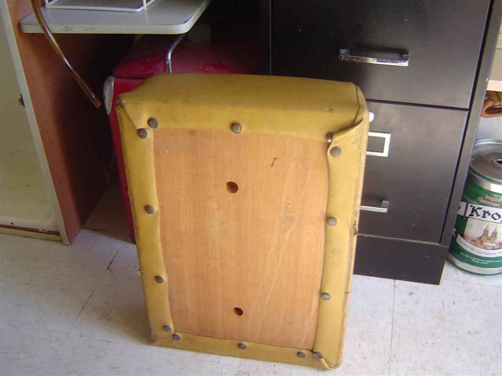

Rear facing seat:
The early kits had rear facing seats that were slanted on the seat stand. We do not know when they changed to a straight seat bottom.
Below is fabrik 350 which has a slanted rear facing seat.
Anyone have a fabrik number later than 350 with a slanted rear facing seat? By 405 it was no longer slanted (see pics on page 3 of kit 405).
walk thru rear facing seat: The early walk thrus had extra wood support for the jump seat. Does anyone know when this ended?
walk-thru rear facing seat with extra wood support for the jump seat

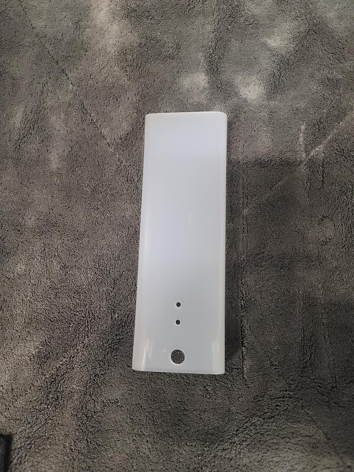

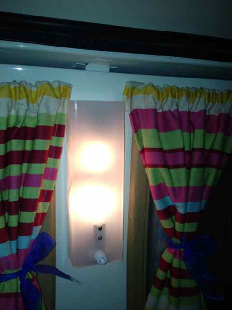

Interior Wall Lamp:
There were three different types of interior lights along the long wall; early clam shell that ended at Fabrik 1049, later style that started at fabrik 1050, and European style
Clam shell seen on fabrik 82
Later style that started at fabrik 1050
European style:

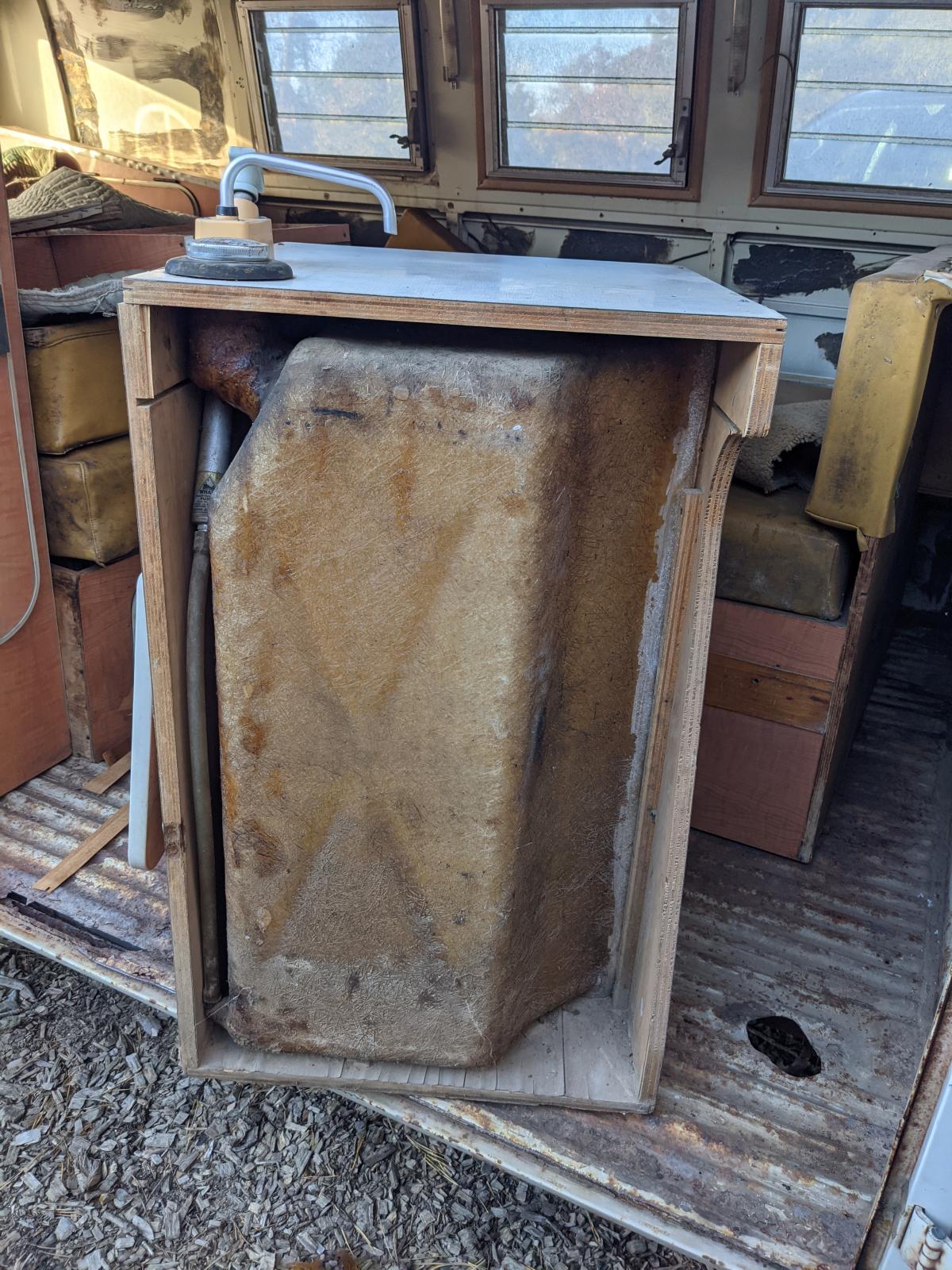

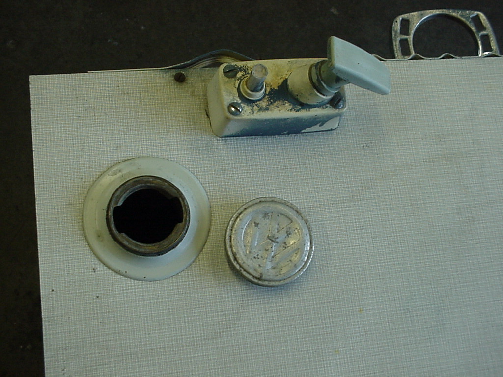

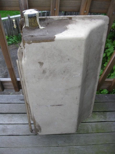

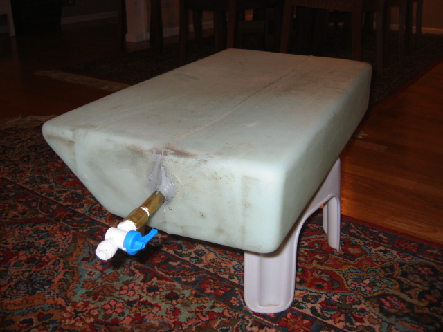

Ice Box/ Fridge:
There are two different types of ice box; walk thru and bulkhead style and several style water tanks. There are different types of water tank, neck filler locations, water pumps, water tank drain plugs, and ice trays.
Fabrik 1-850 have the filler neck come from the side and has the gas tank style cap. It is 58mm from the right side edge of the ice box.
Early style filler location
Early tank
Fabrik 851-5399 has the filler coming from the top with the gas tank style cap. from 4350-5037 the third style is sprinkled in. This particular style has the filler hole 112mm from the right side edge of the ice box
filler location
water tank
Third style is 5400-End of SO-42. This has a smaller cap and has a different drain plug.
filler cap and size
later style water tank

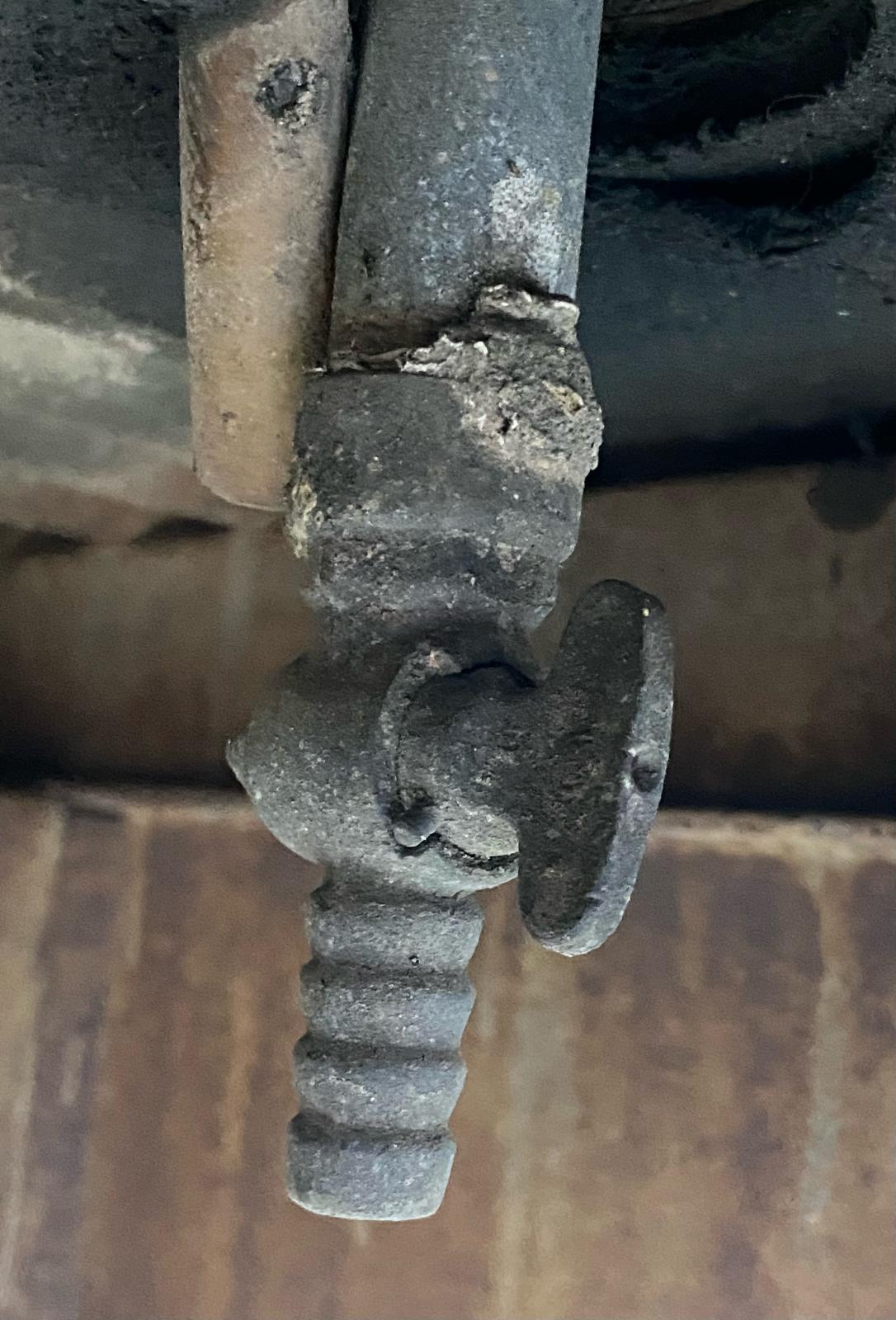

The water tank drain plug for fabrik 1-5399 “early style”
Later style water tank drain plug on the right
Water Pump: There were two different water pumps. Early style made by Whale is until fabrik 5399
Later style from fabrik 5400 until end of SO42

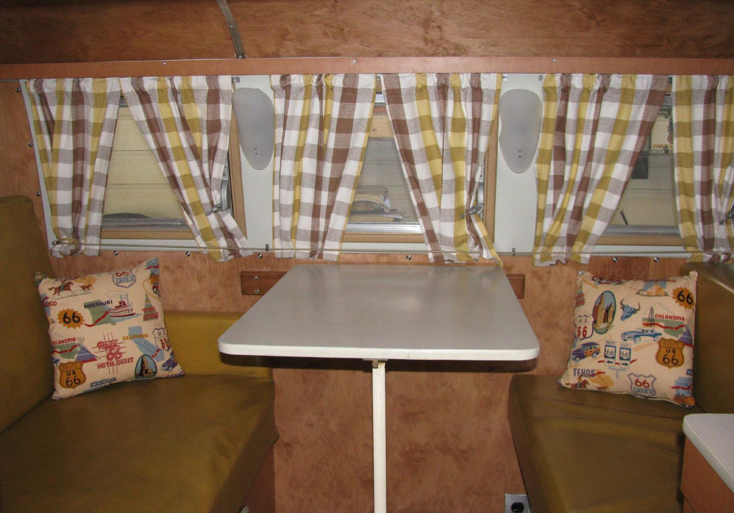

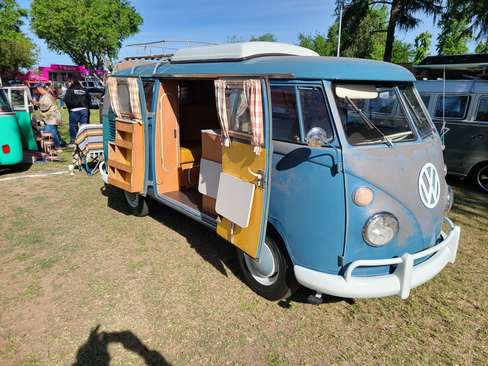

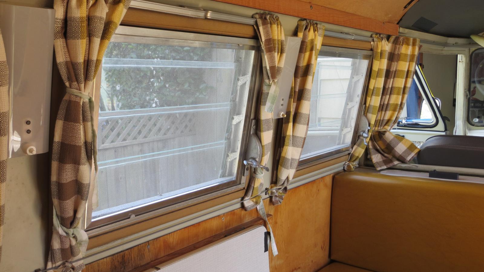

Curtains:
The first 667 kits came with the early style curtains, which are seen below on number 665.
At 668, they switched to the style most commonly associated with the SO42
Mugatu wrote:

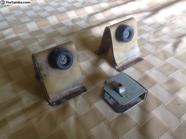

Bed Bracket Bump stops:
This information is not exact but so far we have seen bump stops on an Nov 65 with fabrik 2858 until Feb 66 with Fabrik 4164. By April they were no longer present. Any Fabrik before 2858 or after 4164 please chime in if you have bump stops on your bed bracket.
Childs Cot:

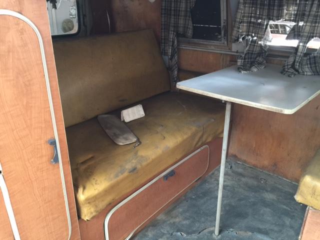

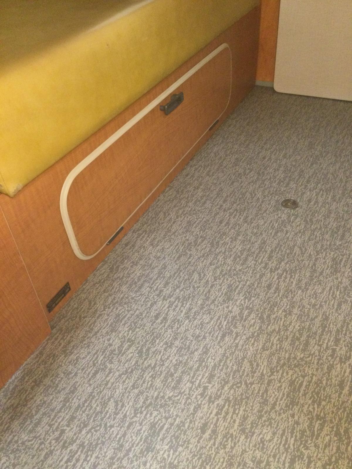

Flooring: There were several different linoleum flooring options used.
White and grey:
Checkered:
Darker:
The youngest SO-42 with the dark linoleum that I have found was built on August 1, 1966. Fabrik 6732

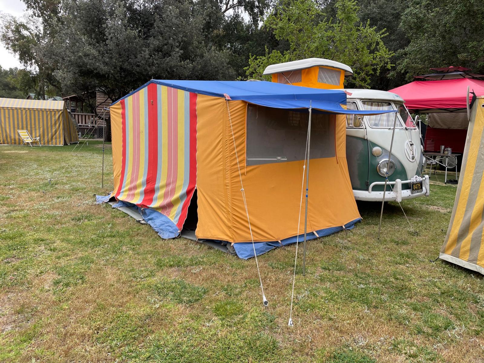

Big Top Tent: TUS spec buses that came with tents came with a the big top tent/ circus tent. They came in three color schemes
Yellow with orange, red, and blue strips:
Yellow with blue stripe:
Yellow with red and blue stripes:
Tent tag:
Tent bag:

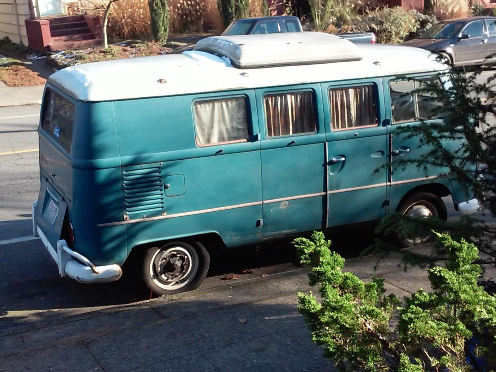

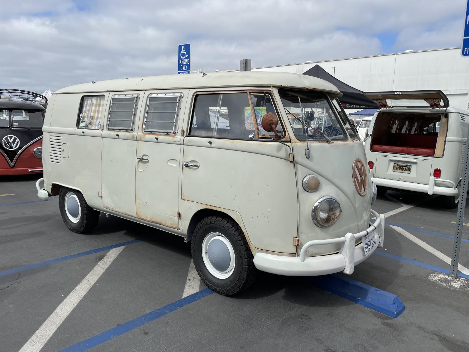

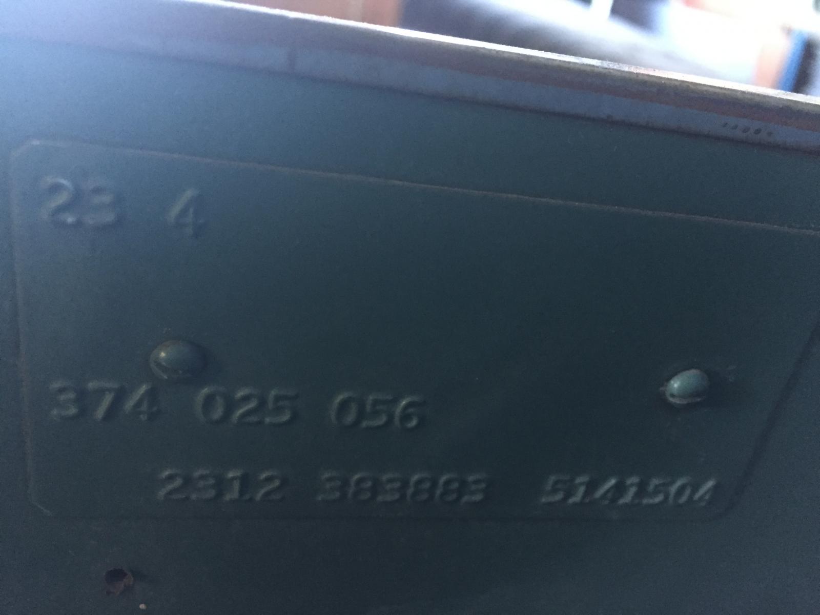

No Port Code SO42: We have seen no port code SO42s that were destined for North America. They typically have no SO42 version on the m-code plate, locking ignition, solid windows instead of louvered windows, and 523 paint codes.
Here is an example of one with a typical no port code mcode plate

SO33 Campers Built After the Start of SO42 Production:
I know of four SO33 that were built after the start of production of the SO42:
AS35Driver’s:
Recently for sale:
Yanmori
The fourth SO33 I know about that was built after the start of SO42 production was built on 2.4.65. However, like AS35Driver’s it has no destination code or Westy paint code.

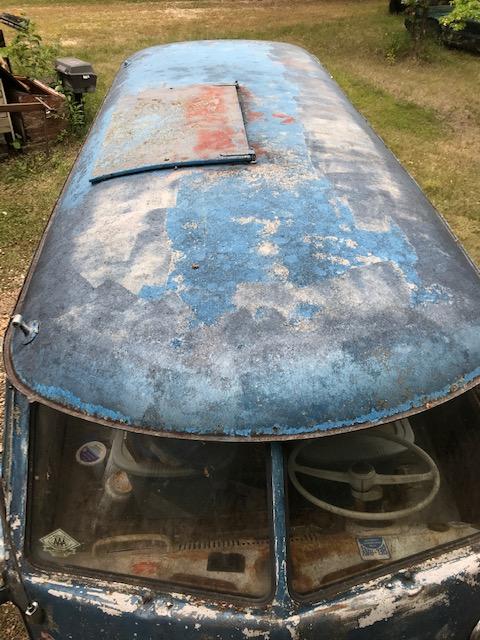

Great detail Johnny, thanks for consolidating all this stuff. A few more details:
There was a very early clamshell version with no front switch and the left edge scalloped to allow you to reach around to pull the switch on/off:
There were also some SO42's delivered with early tent mounts. Usually either German delivered and/or no port code/westy code:
Great info Todd! I didn't know that until now. Do we have a rough estimate of when it changed by? Can you tell if #82 has this super early style?
Mugatu wrote:
srfndoc
Joined: August 21, 2010
Posts: 3386
Location: SoCal
srfndoc is offline
PostPosted: Wed Mar 15, 2023 6:21 pm    Post subject: Re: Official SO42 Detail and Changes Reply with quote
von_hansel wrote:
Fabrik 82 does:
Fabrick 189 has the second style so the change happened sometime between those two.

PostPosted: Wed Mar 15, 2023 6:32 pm    Post subject: Re: Official SO42 Detail and Changes Reply with quote
Most SO42's were delivered with mustard yellow vinyl but some early/German delivered SO42's were built with similar cloth material to earlier SO33 Westy's:
Susan's 66 Dormy:
Mark's sunroof so42:
