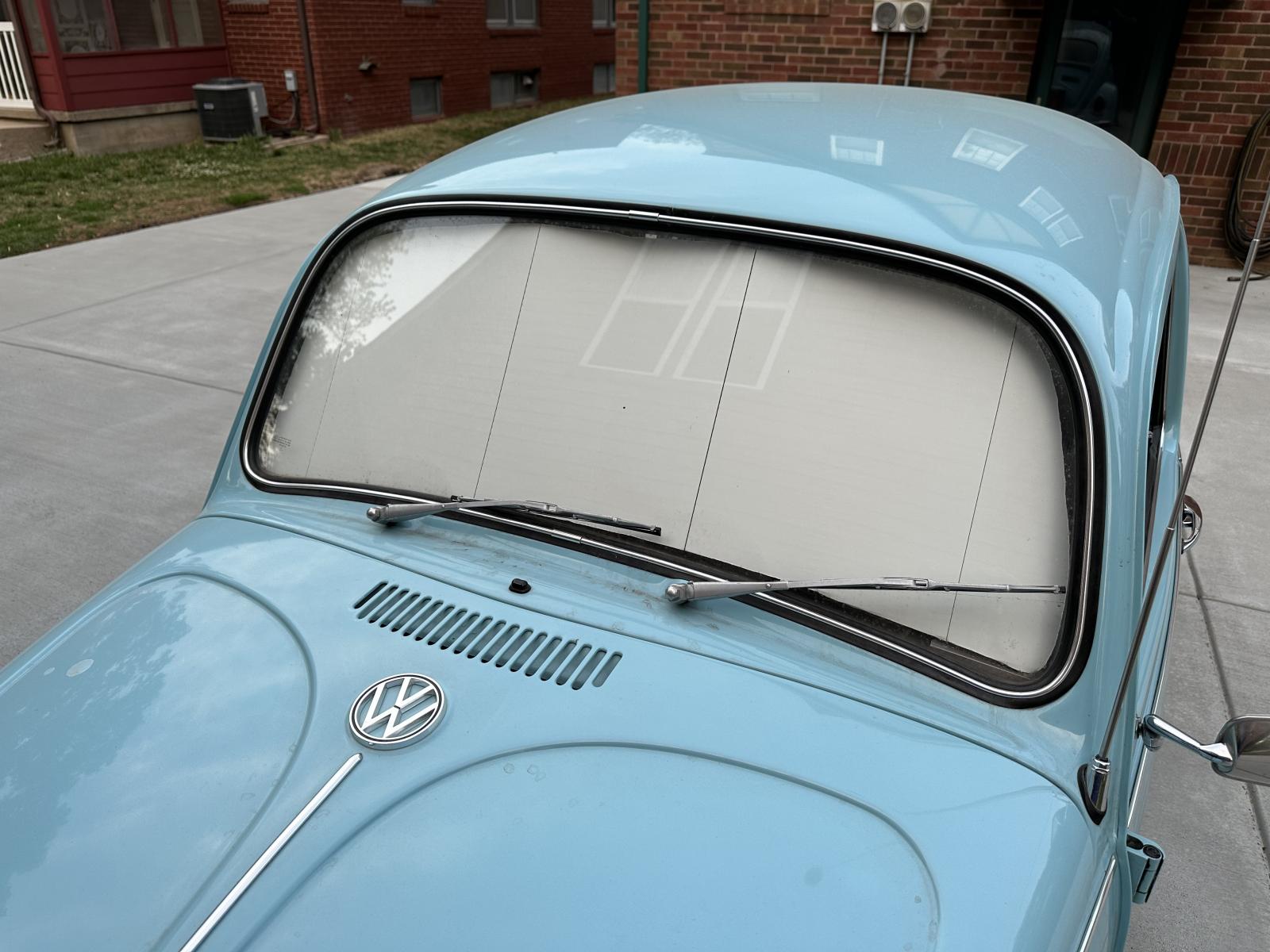

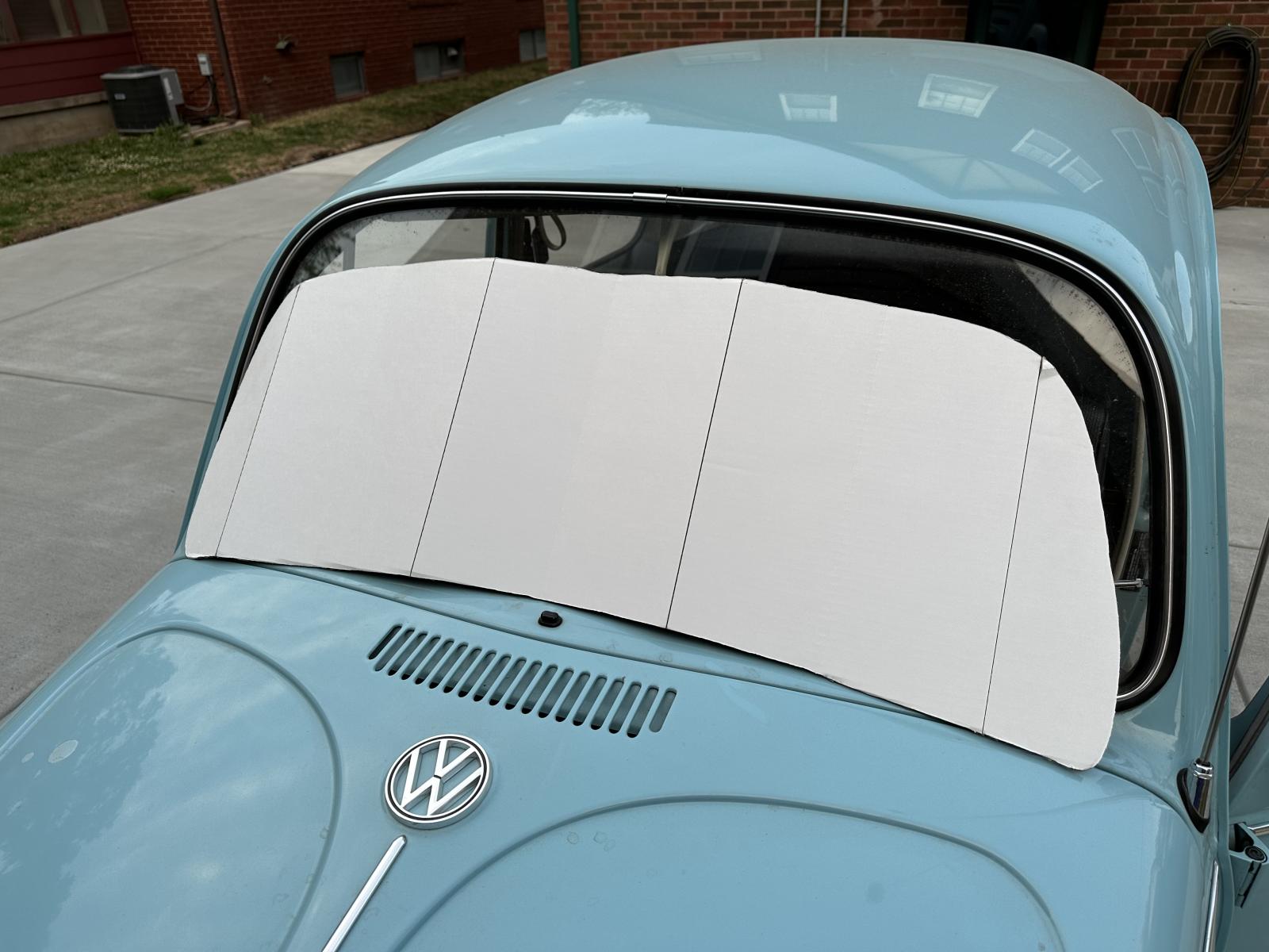

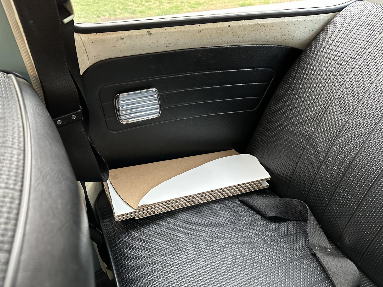

baldessariclan wrote:
I went looking for something similar a few years back, but didn't have luck finding anything appropriate. Eventually decided to just make my own.
Went to Hobby Lobby and bought one of their 48" wide white cardboard "display boards", which are pre-slitted to fold into 3 sections. Next took a couple large sheets of paper, taped to outside of windshield, and traced windshield edge onto the paper. Then used that paper as a template to transfer edge pattern to the carboard, and trimmed cardboard to fit windshield opening. Finally, carefully cut a few more shallow slits (i.e. through one face sheet only) in the cardboard, such that I could fold it up "accordion-style" for storage.
I'll try to take and post some pictures of it later tonight. Have been using for several years now -- works great! Smile

Thanks for taking time to post these photos. That's a great low cost solution!
