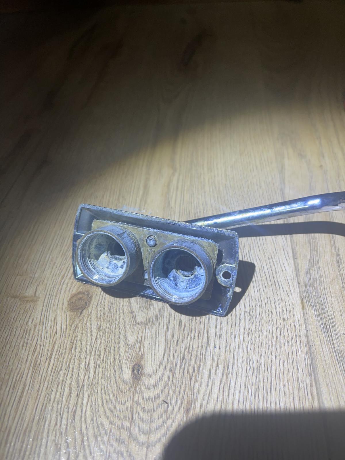

Thanks for the info. Going to try to tackle mine this evening. Any leads on where to get the washers. Both to seal the spigot and handle shaft as well as the valve seal inside the city water valve?
While I've got it apart, here's a photo of the disassembled unit. Hopefully, it'll help someone else in the same predicament.
