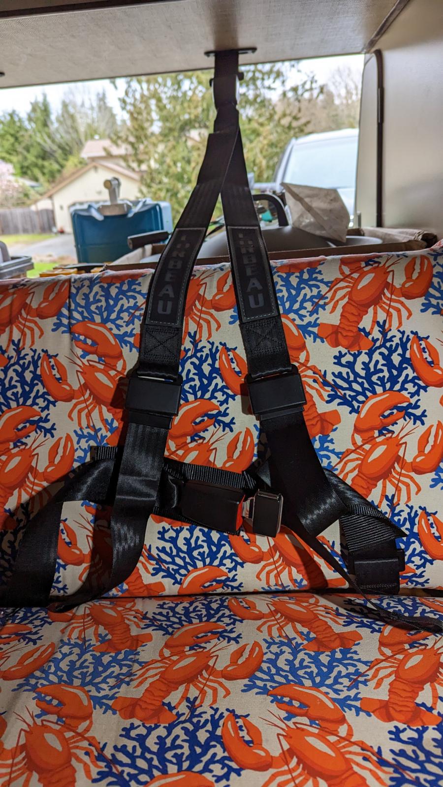

Anyone ever installed something like this? Couldn't find in search.
https://www.extremeterrain.com/productphotos?webid...mp;index=0
My kids are still in 5 point car seats in the van, but boosters elsewhere. I don't mind the 3 point shoulder on the passenger side, but really don't want to go through the cabinet. Less about the drilling and more about the pain for storage and in the way during camping.
I have both top tethers installed on the rear hatch frame for the car seats. I was thinking of using them with this harness and then disconnecting and tucking under the seat while camping.
Thoughts/experience?

PostPosted: Thu Apr 13, 2023 7:51 am    Post subject: Re: Harness Style rear seatbelt? Reply with quote
If you use climbing carabiners on the top connector, the whole thing could be tucked away when not needed. How did you get a serious connection to the top frame? Is it bolted from the outside with reinforcing to the inside? No head banger?

PostPosted: Fri Apr 21, 2023 6:00 am    Post subject: Re: Harness Style rear seatbelt? Reply with quote
Installed, looks/works great. Just ordered another for the passenger. No more carseats! Gamechanger for the camp changeover or daytrips while camping. The connection just below the deck of the rear AC cabinet is a standard seat belt connection. So you can just disconnect that, the male end doesn't quite fit through the cabinet slit, so it just stops/stores there and you can tuck the remainder into the bench seat.
Although the connection I'm sure wouldn't meet the strength required by DOT, that's designed for a 500 lb person. This is more than sufficient for a 50 lb kid and doesn't rely on the capacity of the rear seat back hinge.
If the connection was a concern, you could easily reinforce the backside of the connection through the hatch frame connection and/or beef up that plate.
The belts are really nicely made as well.

PostPosted: Fri Apr 21, 2023 6:31 am    Post subject: Re: Harness Style rear seatbelt? Reply with quote
Finally this topic becomes clear. And I can see that when not in use there is room to wrap the excess webbing and clips around the back and stow them in the space where the retract mechanism lives. Will that block off the A/C blower intake?
Thanks for the pics.

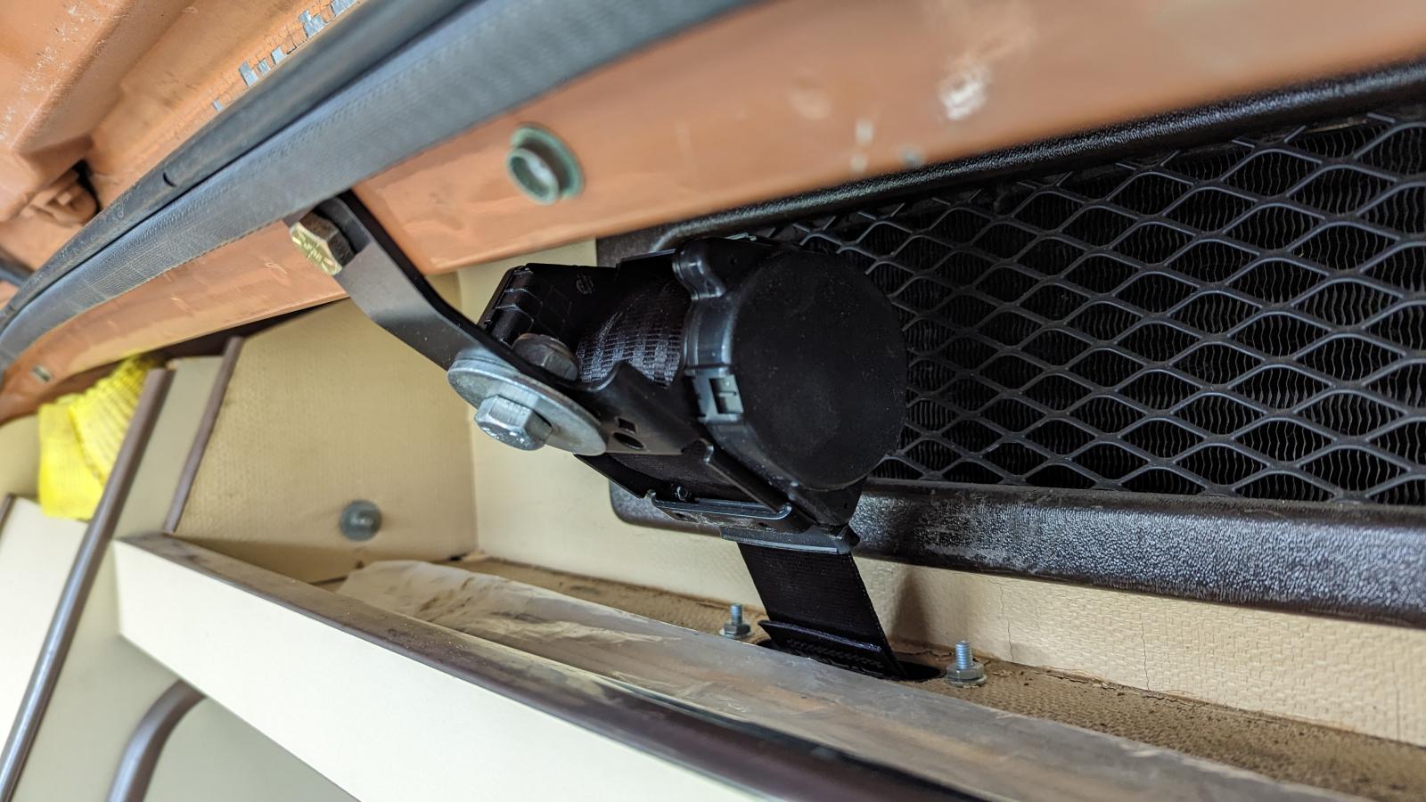

Not enough to matter. Maybe if you had 20 installed in there. Only the retract lives there. You disconnect just below the deck and the shoulder along with lap goes beneath the bench.
I was originally thinking the retractable wouldn't fit in there and it'd have to be below (hence my cable/carabiner comment). Stoked it fits above and that the male end doesn't pull back into the cabinet when detached.

jwa9681 wrote:
The retract/lock mechanism works well at that angle too?
1986 Canadian Syncro Westy TDI - 1989 Syncro Single Cab - 2001 Audi S4 - 1981 VW Caddy ABA - 1980 VW Caddy EV - 1973 VW T-181
jwa9681
Joined: June 30, 2011
Posts: 22
Location: Bellingham, WA
jwa9681 is offline
PostPosted: Fri May 05, 2023 11:09 am    Post subject: Re: Harness Style rear seatbelt? Reply with quote
hans j wrote:
It's good. A little bit of an optical illusion in the photo. It's pretty well lined up actually.
