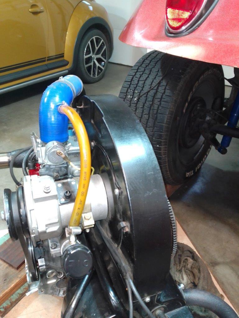

Observed a considerable amount of white sludge in our VW buggy engine. Installed an Empi aluminum oil filler w/ vent hose to the intake just before the carb a few yrs ago & now find the vent hose and oil filler neck partially plugged w/ a soft white oil sludge. Observed some oil weeping out f/ behind the lower belt pulley when motor running a few months before we parked it for the winter & after some research found that the cause may be insufficient crankcase venting. The big bore 1200 motor was rebuilt by a VW shop in 2020 & runs very well w/ about 6k miles on the rebuild. Never needed to add oil between oil changes. Been using regular 20/50 motor oil changed every 1500 miles. Buggy always parked in a dry garage. What causes this white sludge? Incorrect crankcase venting? Wrong type motor oil?

you needed a vented 710 cap.

The oil neck extension fitting for a vent is wayyyy to small diameter (less that stock). You don't need huge breather boxes and hoses all over the place. Even stock would be good enough. So yes better venting but don't go overboard for a street engine you are not gonna wring the guts out of all the time.

I would not vent the case to the carb... good way to make a mess.
BTW.. nice red cap.

Thanks for all the advice on white sludge in our VW dune buggy engine. Cleaned out the breather and fill pipe thoroughly of sludge. Ran the motor until warm replaced the oil w/ 15W/40. Posted the buggy on FB marketplace & sold it to a local buyer.
