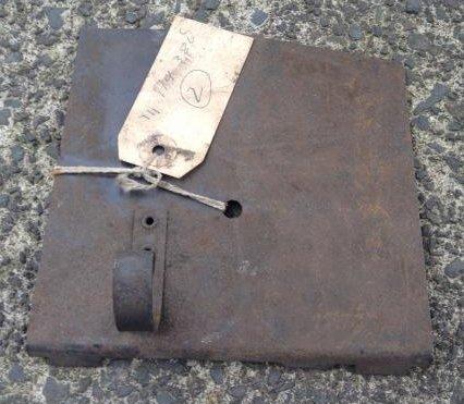

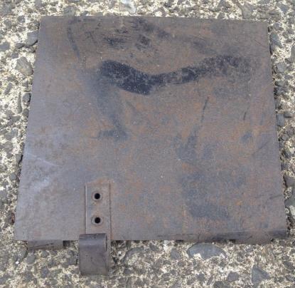

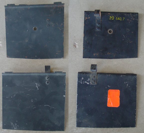

I found someone selling both styles in the classifieds so here are some reference photos.
You can see how the later ones have the connecting arm in a different spot on the flap, probably sure to the fact that the connecting arm is longer but maybe this is better/longer lasting/more efficient somehow as well?
111119385B
111119386B
111119385C
111119386C

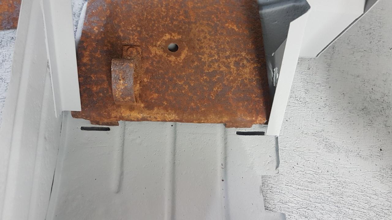

I dug out some heater flaps off a 58 to use on my 54. The tabs are in a different spot. I didn't know there was a difference on the tabs. Other than that they look like 111119385C. I will replace the tabs as the are in bad shape anyway.
Edit: I just noticed they have solid revits and about 8mm narrower.

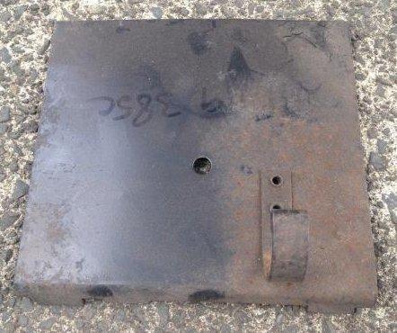

PostPosted: Sat Mar 12, 2022 6:27 pm    Post subject: Re: 36hp Heater Box / Shoebox flaps Reply with quote
I see there is some info above too.
Another pic I posted in the past, this shows they are different widths too, although that is easy to miss unless it's mentioned:

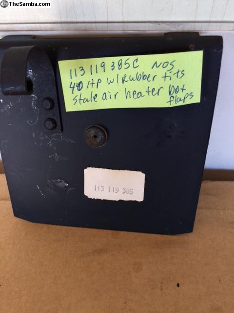

I bought a set of these from Virtanen and they fit right up. A happy surprise. First thing I bought from him that did not require hours and hours of fettling to get it to fit.
https://www.thesamba.com/vw/classifieds/detail.php?id=1430653
