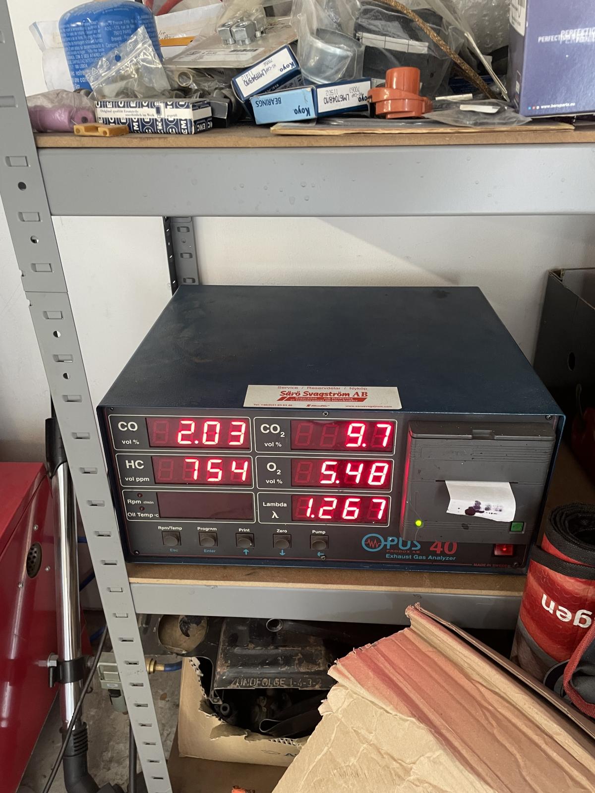

So, car was running reasonably well but one carb had an air leak at the base that was standing in the way of tuning in really well, so I took my carbs (Solex pdsit 32-34) off and reinstalled them with new base gaskets. I went for a drive to warm it up, sync the airflow and then come back to set the CO (all per the ultimate guide here on the forum).
However already when driving around I felt a pretty apparent hesitation when cruising, stumbling when acceleration at lower speeds (not so much stumbling under acceleration at higher speeds) and a pretty rough idle.
When I came back I synced the carbs but it really wasn’t running well, hooked up the 4-gas meter and got the results as per first photo attached.

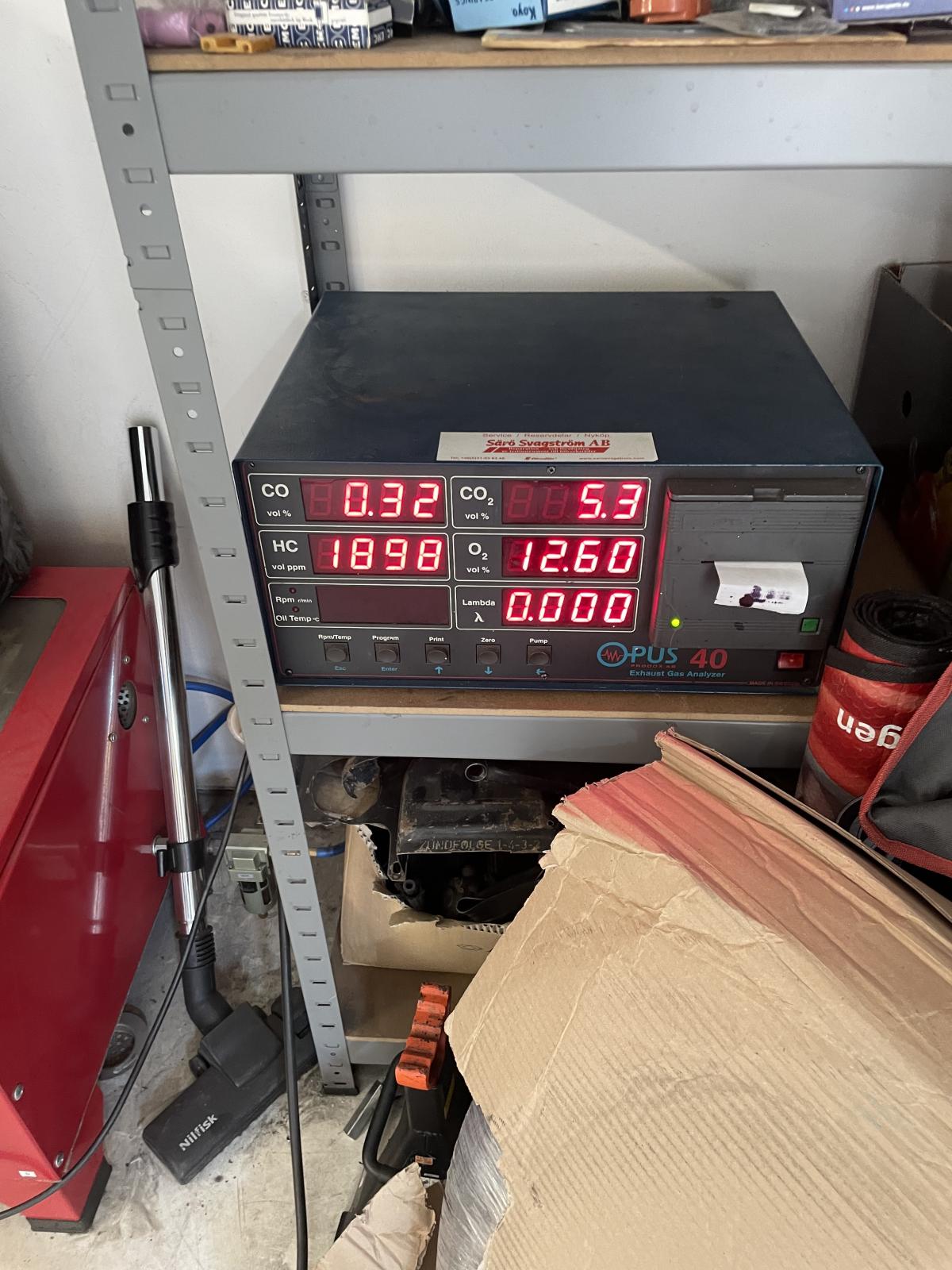

Then I unhooked the retards and the central idling solenoid to set the CO at the carb bases, which I reset both to 3 turns out. It turned out the right side was 6 turns out Shocked
When I then started it and checked the difference between the two sides the right was almost not contributing: taking the power to the left solenoid killed the engine, taking the power from the right side only lowered it a tad. Second photo is the gas analysis in that end state.

That second pic is way too lean, is that with the CIS disabled?

Yes, that's with the CIS disabled. But both have way to high HC values which points to unburned fuel.
At the same time I'm wondering if the hesitation at cruise and the bad idle could be caused by a clogged idle jet? But why would a clogged idle jet lead to high levels of unburned fuel? d'oh!

HC's can also be caused by a lean miss, that's why it's higher on pic #2.
An idle jet isn't going to have much effect on cruise, what's the float level like in that carb?
Right, I took the right carb off and flattened the mating surface to the manifold, blew compressed air through the idle jet (solenoid) and the hole it sits in, and now remounted I do get a much better contribution from the right side (HCs down to 50, CO up to ~3%).

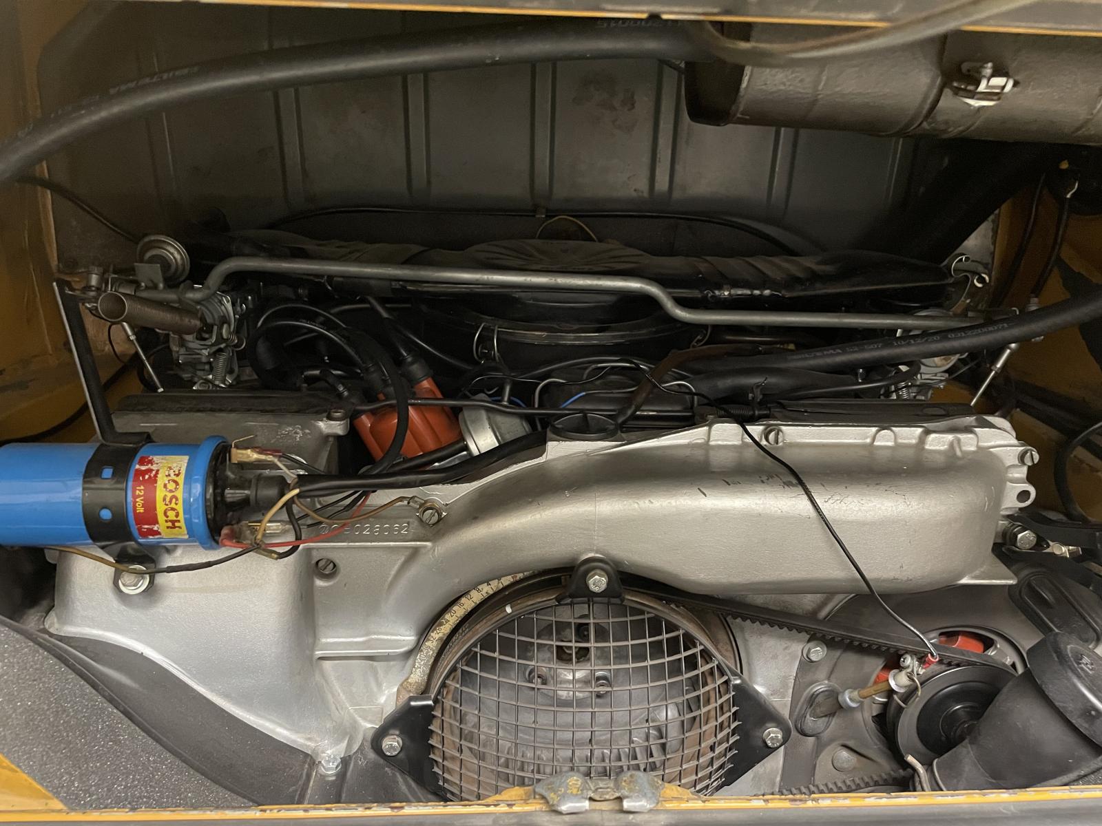

Picture of the engine so you can see it doesn’t look too weird Smile
