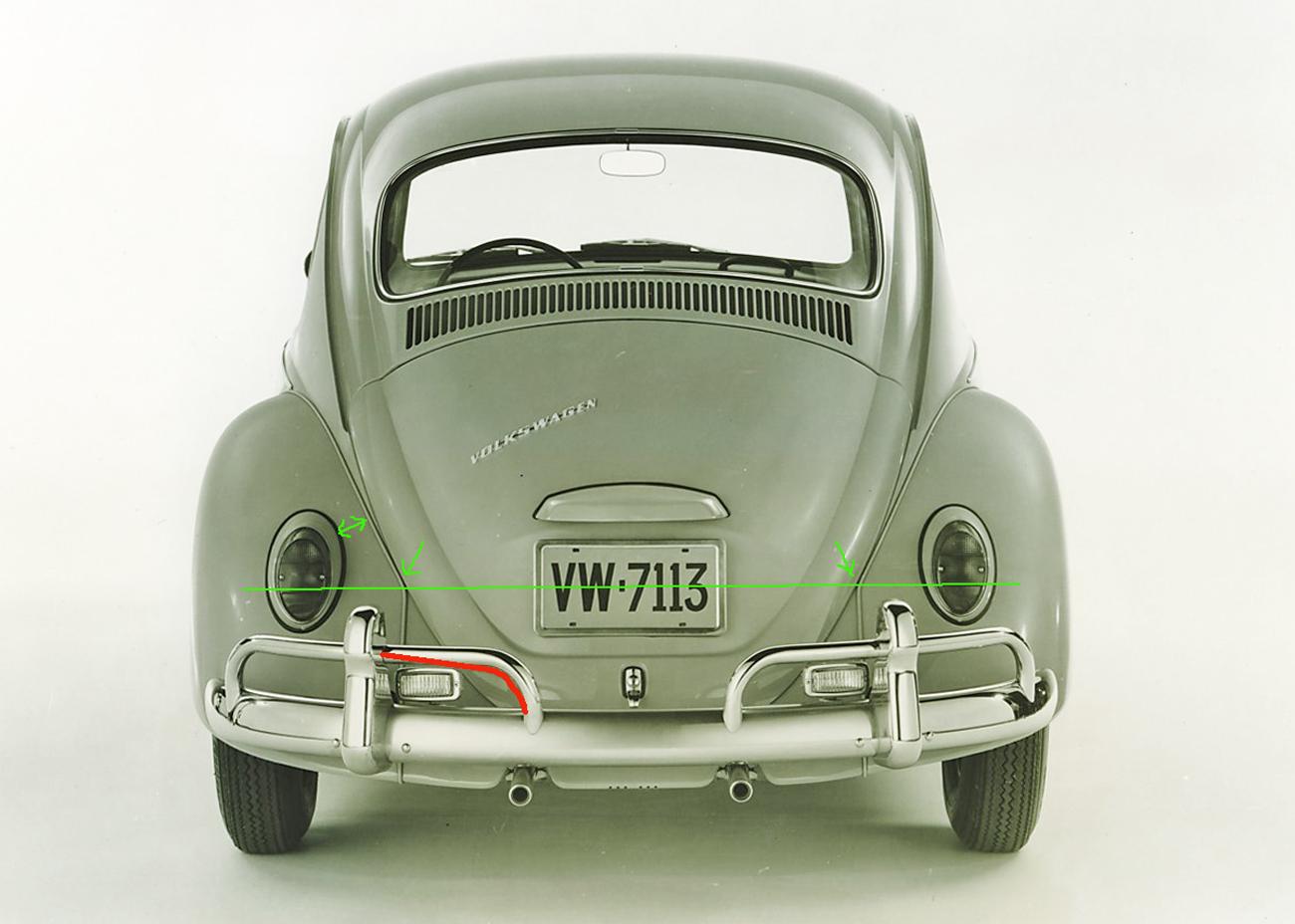

Will you try to relocate the taillamps further down to the correct height? They are now also unfortunately at a mismatched height with the left one being slightly higher than the right one, and both appear to be slightly too far outboard. You can see the deviations if you use the outward kink of the fenders as reference point, then draw a horizontal line through the kinks*.
For comparison, here are the factory-correct locations on a '60 (Stock Steve gallery) taken at a similar view angle to your car. A '60 would have the taillamps in the same position and height as on your car.
You might be able to move the housings down and inward closer to where they should be, with the housings still covering up the original holes. That would save you from closing up the original exposed holes and painting them or the entire fenders.
*Here's the horizontal reference line shown on a US-spec '67. The two kinks did not change position on the body. The taillamps are of course at exactly the same height.

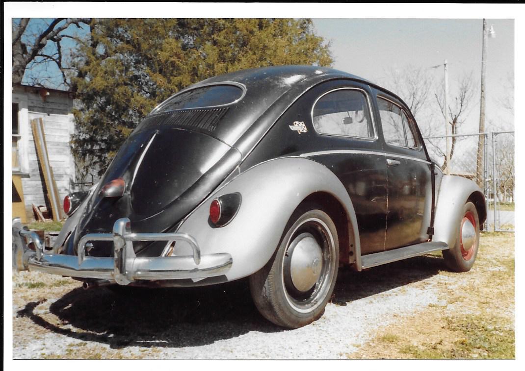

I have these photos of the car just before it was sold and shipped the Europe.
I was wondering if there is a way to get more history via the VIN or licenseplate? Wink
I think that the licenseplate is from California. But shouldn’t it be a black and yellow plate?

PostPosted: Thu Oct 12, 2023 6:12 am    Post subject: Re: 1957 Coral red oval from Callook to original/oldspeed Reply with quote
The blue plate pictured was issued in 1980 or 81, when California first went to 7-character plates.
