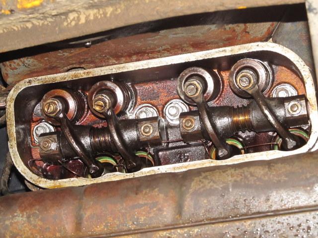

Its been a long time, but from memory the Type 4 cars really fried their oil when SD and SF oils were what was available, just as bad if not worse than a bus did. I acquired this 1974 1800 engine from a 412 almost 20 years ago and have good reason to believe it had been off the road for 10+ years at that time.
It is a a baked mess with wear that just isn't seen all that much with today's oils. It had 0.015" of taper to the cylinders, whereas the high mileage rebuilt 1800 in my bus (also originally from a 412) had zero taper at 250K miles.
My personal belief is that the cooling duct may make things worse and not better. It would be interesting to do Ray's intake air temperature tests. The ignition coil and distributor get quite hot on a Type 4 car with the duct in place when compared to a bus. The "meat" thermometer you can get from Harbor Freight for 10ish bucks and then extend to the front with some doorbell wire would be a cheap way to do the test.
