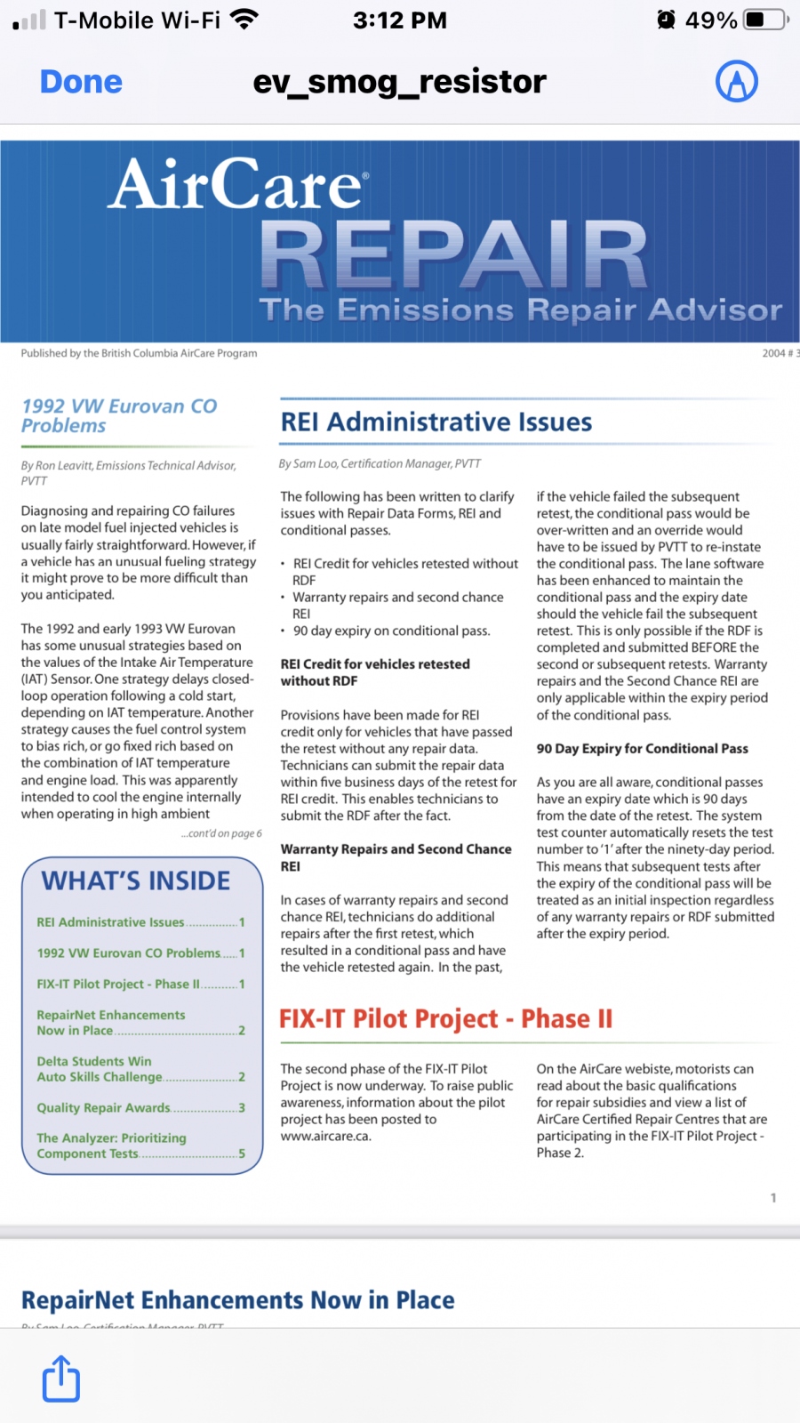

Here is something you can try to help with the CO. I’ve been running ngk and have had good luck with the plugs. I know here in California depending on the smog tech if he sees a replacement part it must have a CARB number. I had to replace mine for a second time.

PostPosted: Tue Aug 15, 2023 6:17 am    Post subject: Re: Emissions failure questions Reply with quote
Interesting, thanks! Where is that screenshot from? It looks like a nice resource.

PostPosted: Tue Aug 15, 2023 3:53 pm    Post subject: Re: Emissions failure questions Reply with quote
Here is the other screen shot. It was something done by the Canadian air resource board to solve the issue with the van emissions on the early models
