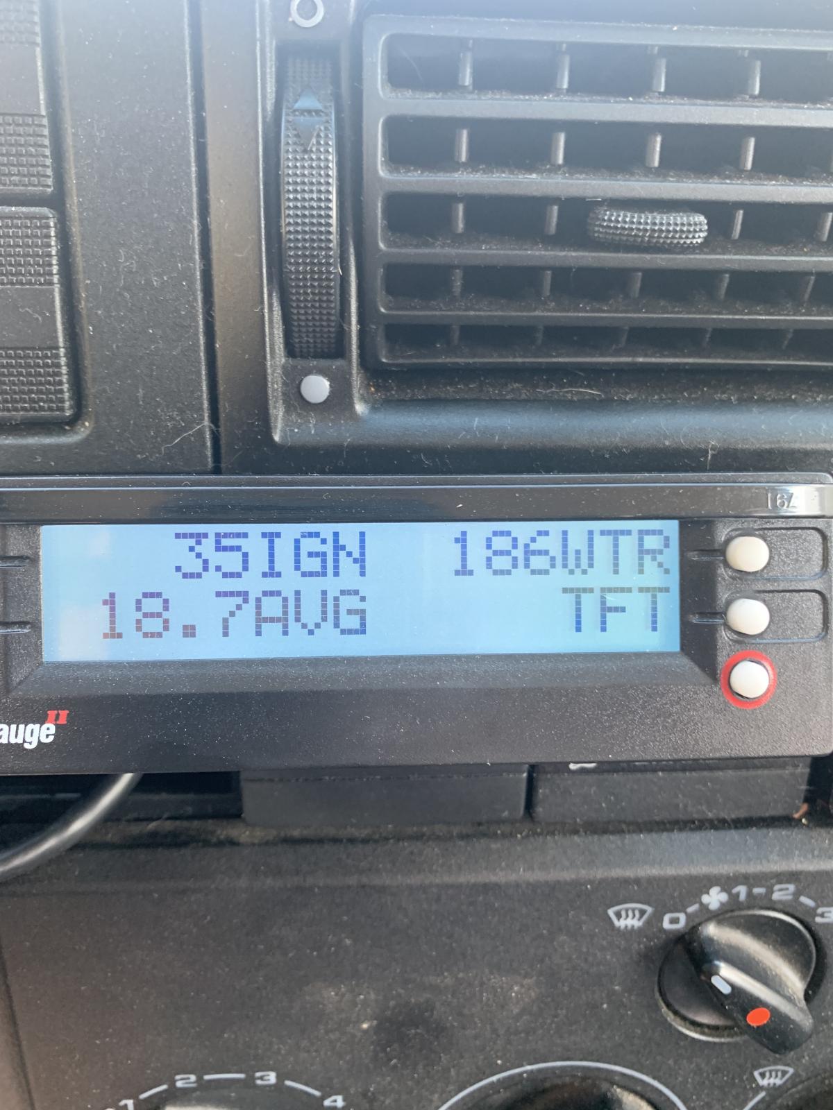

I have a 1997 VW Eurovan (US) Model. I have been having this issue on and off for the past year. The frequency is had to determine: I took a 600-mile trip and it happened; it might happen ever 50 drives? it is not my daily driver so tough to determine. The issue is the Dark area around the "D" gear indicator on the dash will flash and the van will have lack of power (limp mode?). When I shut the van off and restart it runs with no issues. The transmission was rebuilt about 2 years ago and has about 6000 miles on the rebuild. I have checked the wiring connector on the transmission. I am not getting any codes and VW mechanic that I took it into is not seeing any codes. You can see by the attached photo that sometimes the TFT on my Scan Gauge will be blank when this happens. This particular time it had 2 quick flashes the break and then 2 quick flashes. Any constructive suggestions would be appreciated. Thank you in advance.

You said you checked the connecter at the transmission. Which one?
There's the round one that goes into the top of the valve body towards the front. The other one is rectangular shaped on the driver's side of the trans for the multi-function switch.
TFT comes from the round connector, "D" signal comes from the rectangular connector.
You may have a faulty connection at both. Also, the multi-function switch may be going bad.

I had my mechanic look at the connectors while it was hooked up to his scanner. He moved the plugs (Square and Oval) around and had no errors TCM or otherwise. Where do the wires that go the square and oval feed from? (TCM?ECU?) What next steps would you take? Should I send my TCM out to Module Masters and have them run a diagnostic to check for any issues? Test the harness leading to the Transmission? Thank you.

Both of those go to the TCU.
The missing temperature data could be a failed circuit strip that connects the solenoids to the external harness. The sensor is built into the strip.
The "D" issue is most likely from an intermittent multifunction switch.

I wanted to post an update on the issue. I was able to source a TCM for my van. I replaced with the new unit and have not had any issues with the intermittent "limp mode" selector flash. Great feeling to have the issue resolved. Thank you for the support.
