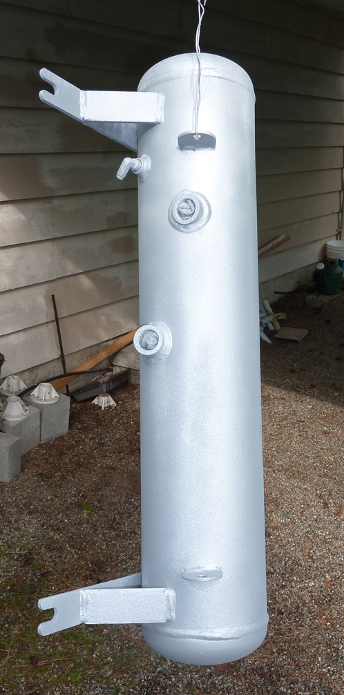

There are some good threads here that cover refreshing the propane tank and they helped me figure out how to do mine. Here is the path I went down.
-New U.S. made Rego valves from my local propane distributor
-New regulator from GoWesty
-1 Spray can of Rust-Oleum Galvanized Paint
-3/4 Spray can of Rest-Oleum Truck bed line
-1 Spray can of 99 cent white paint
-1 Spray can of Bondo rubberized under coating
-Used a loaner flaring tool from O’Reilly auto parts, you pay for the tool and they refund your money if you return it in 48 hours.
Pulling the tank off was pretty easy. Sanding it was a pain and getting the valves off was tough but nothing a 24” pipe wrench couldn’t overcome. My tank was rustier than I thought so I am sure I’ll see some rust again and will replace it with a new tank next time. I am hoping Manchester or somebody will come up with a bigger tank that doesn’t take away ground clearance. There is room for a longer tank and I’d love to find one I could fit in there.
After sanding it down I put on 3 coats of galvanized paint then put two light coats of truck bed liner on the bottom side of the tank and skid plate. I am expecting to see a little rusty to eventually show back up so I just did a light top coat with cheap white paint. I am expecting the galvanized paint and truck bed liner to protect the tank, the white was just to change the color and not really for protection.
After pulling the tank down I noticed I was losing some undercoating on the van chassis so I cleaned things up and sprayed on a new coat. Mounted the tank back up, filled with propane and used soapy water to check for leaks. No leaks and all the propane accessories work great, stove, frig and propex Very Happy
Ready for paint or as ready I was going to get it.
Galvanized paint is on
Truck bed liner on the bottom side
Lost some under coating
New Under coating
Ready to camp
Lessons learned
1. Sanding the tank took a longer than I thought
2. Point the outlet for the bleeder to the side or down. Mine is pointed up and the first fill blasted off the undercoating right above it.
3. My propex heater is mounted under the rear seat so the propane line runs from the front of the propane tank back. The new regulator on the propane tanks is longer so I needed a couple more inches of propane line to make up the difference from the connection point being further forward. I was able to tweak the routing of the propane line however I sure wished I had given myself a little extra propane line when I installed my propex.

Was this tank fitted with the OEM AutoFill type fill valve? If so, did you replace it with a manual fill valve? If so, what is the PN of manual valve please?
Yes it had the OEM AutoFill get stuck and lose your propane valve on it. Here is the valve combination that I went with.
Fill Valve 7647SC
Service Valve 9106CO
Bleeder 3165C has a small knob on top and is the one I went with
Bleeder TSS3169 is stainless and has a tee handle which may be easier to turn than the small knob on the 3169c. I've never used it so I can only say it LOOKS easier to deal with
I should also note that with the valves, regulator, paint, shipping and taxes made it about $125 to do the job. The valves and regulator could probably be found for less however the suppliers I used helped me out so I don't mind paying for the help.
