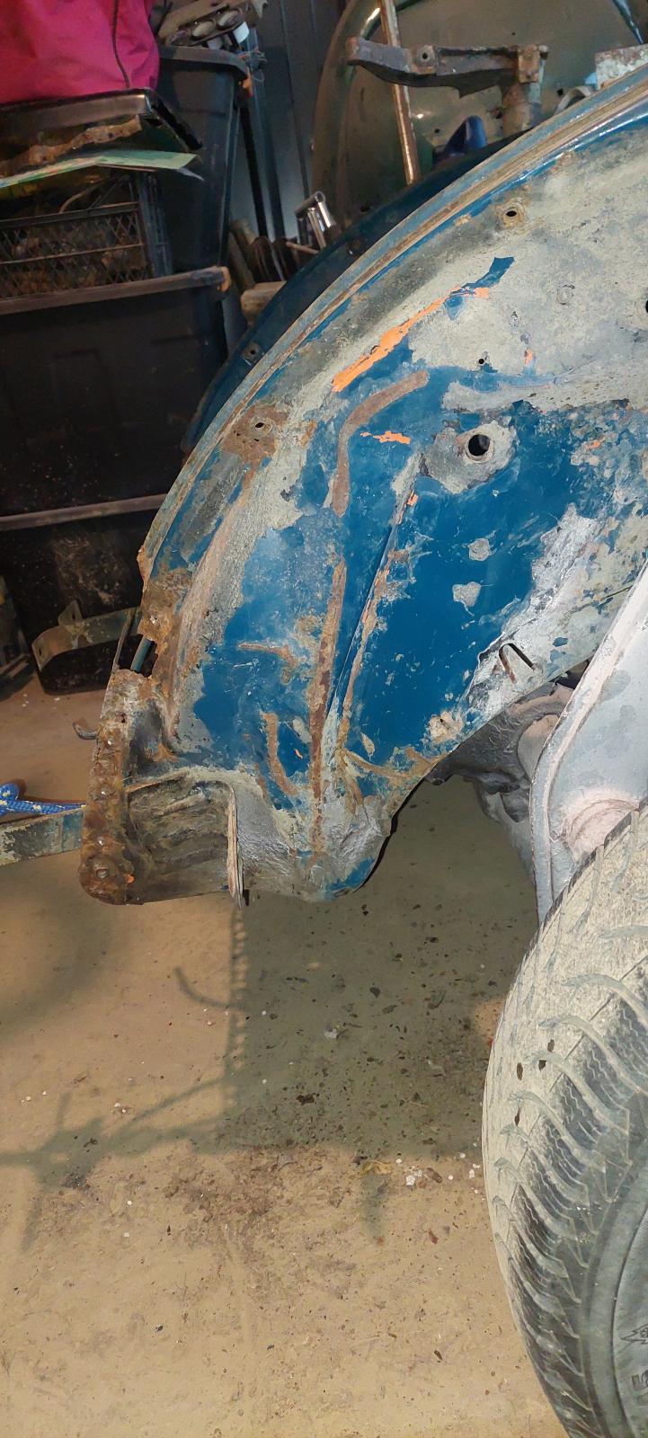

Spring is in the air (no, not the suspension spring!) so I'm back at working on the car. First activity: rear end botched repairs correction. There was some sheet metal on top of original metal which was rusted underneath. I tried to remove as little original metal as possible. Good fit and rear valance sits properly. I still have to weld back the side engine trays. They are in place, but I have to align them with the valance channel and weld them in place.

Thank you for your kind words. It will not be a concours restoration. I will not spend so much time grinding the welds perfectly flat, because on the wheel arches I will spray a thick, textured, rubbery paint as new cars have. I did it on the 1303 and it seems very good at absorbing stone hits, also not chipping. In the end, I have the cars for driving them as much as possible, I don't want to cry at every small issue that may happen on the road.

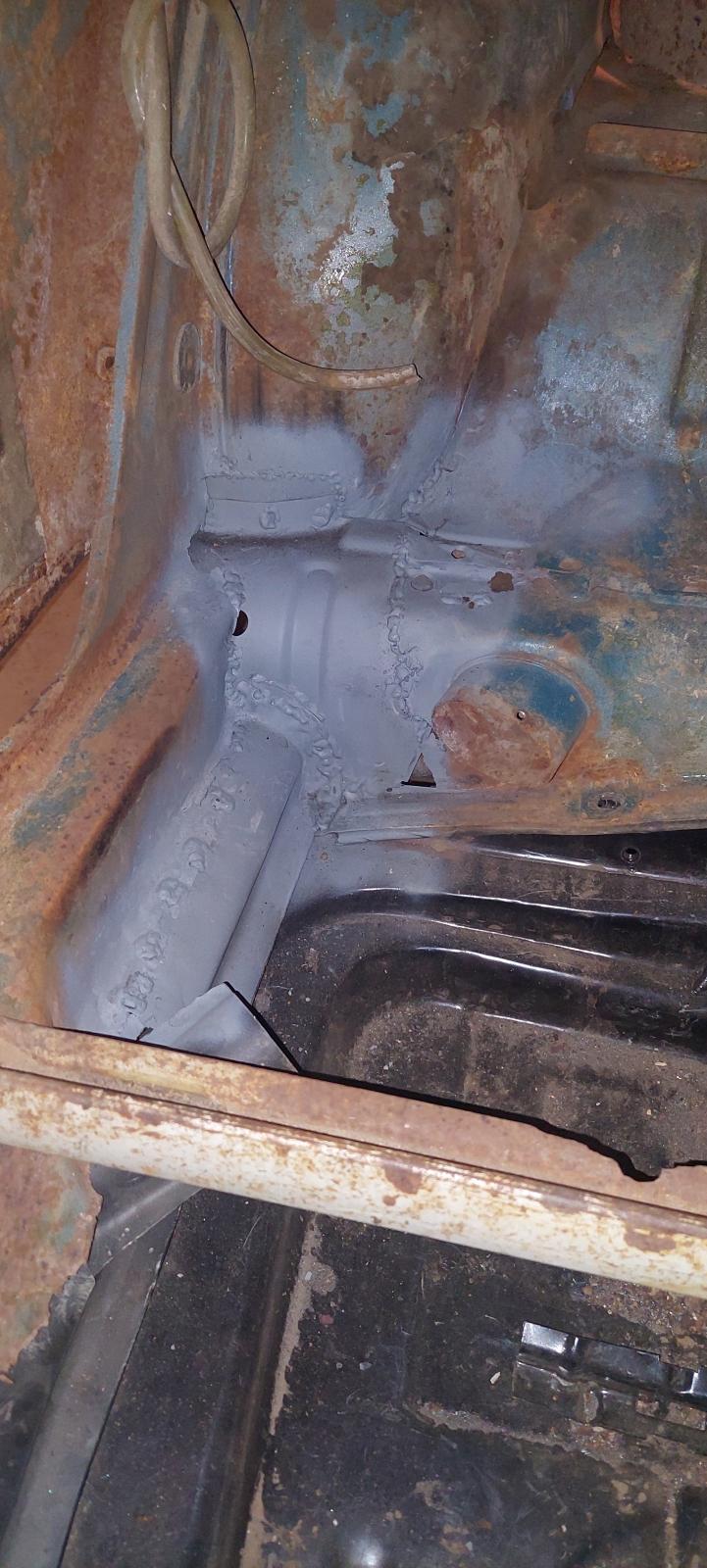

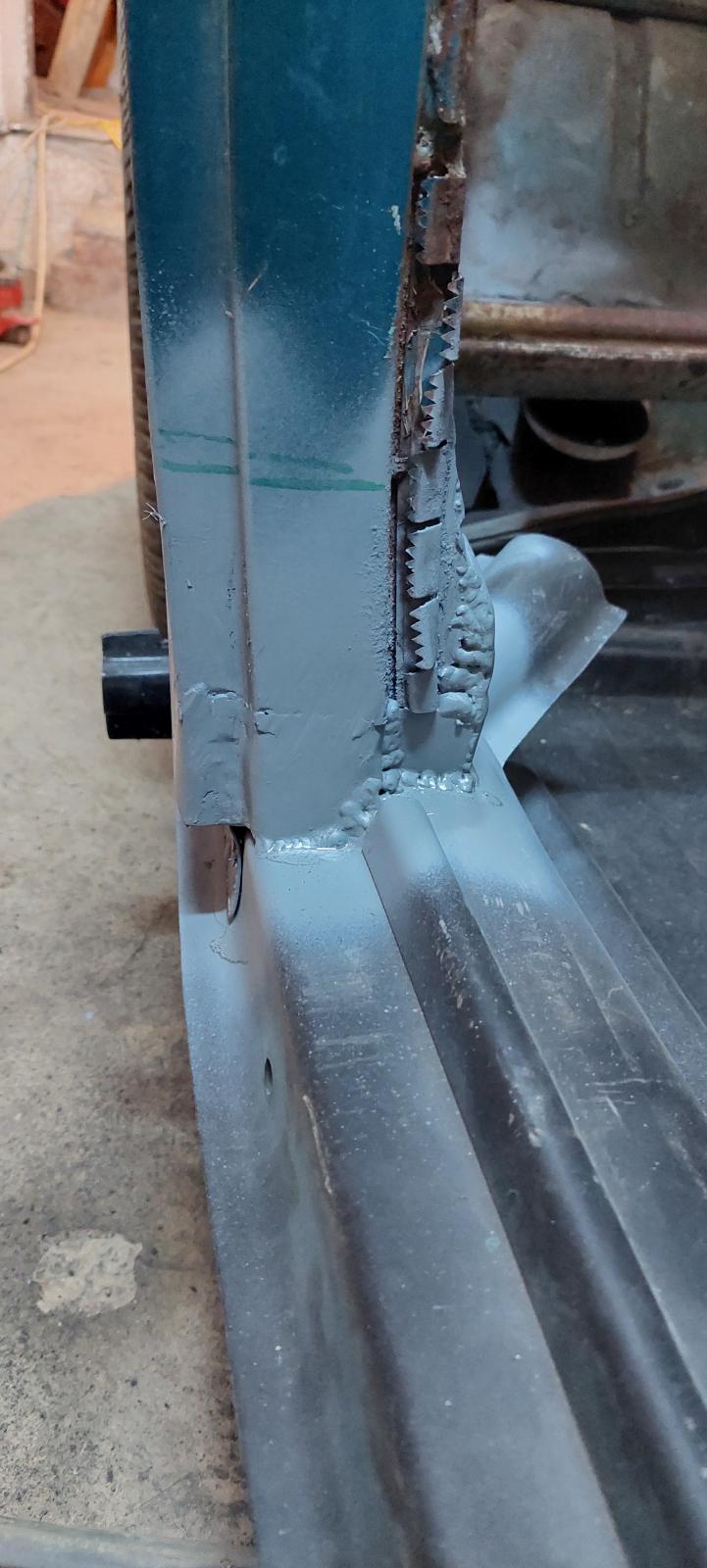

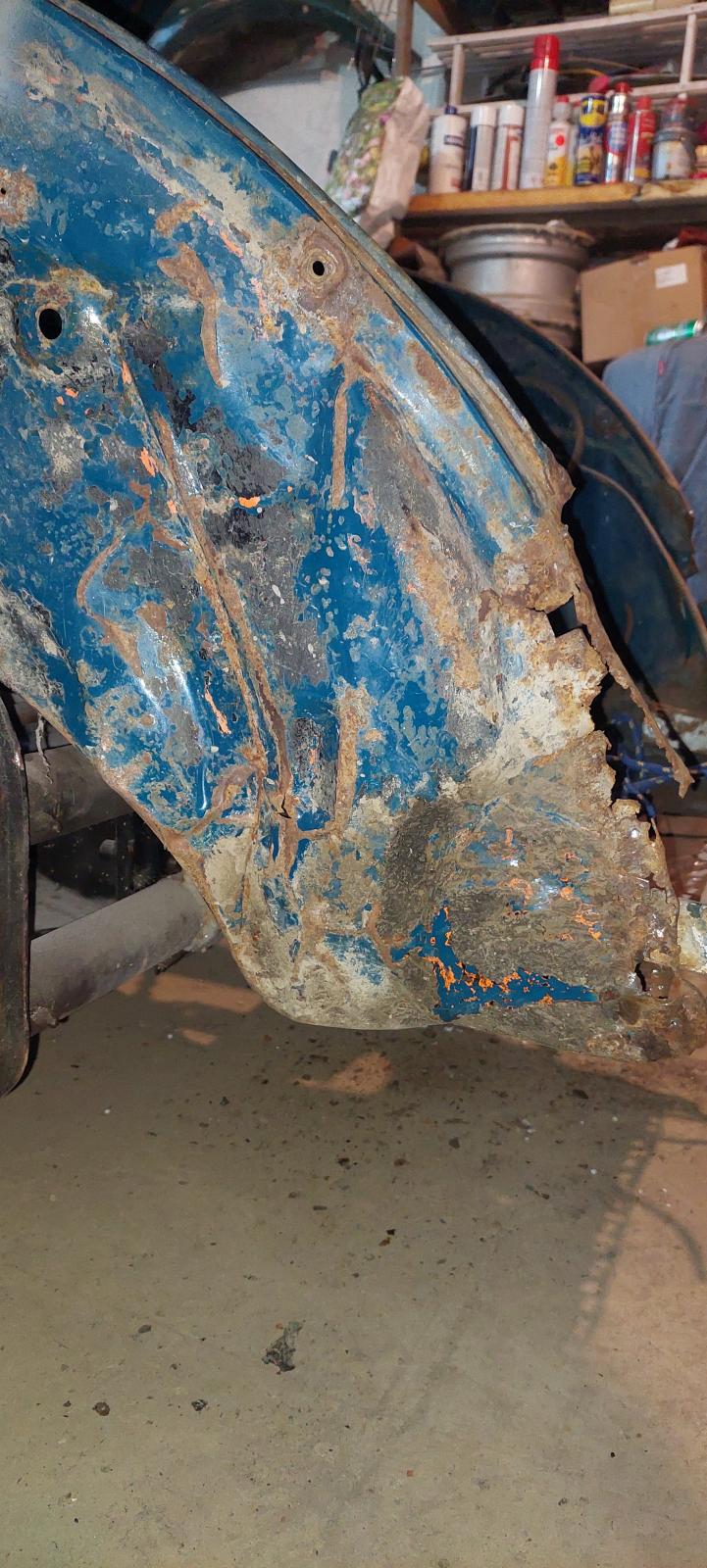

Lazy, lazy. No work until this weekend. I replaced the right A pillar bottom with a clip from the old 1303 front end I kept. Good think I kept quite a lot of junk metal (but in perfect shape), just in case. That "case" is now.
I also welded the heater channel in. But yesterday I realized it was not in the right position at rear, it was higher by ~1cm. That is due to the jack bracket which is welded wrong or has bad design. Cut, bent, welded back, it all fits right. Door gap is good, door closes perfect.
Yesterday I prepared the rear right quarter panel to be changed (no pics).

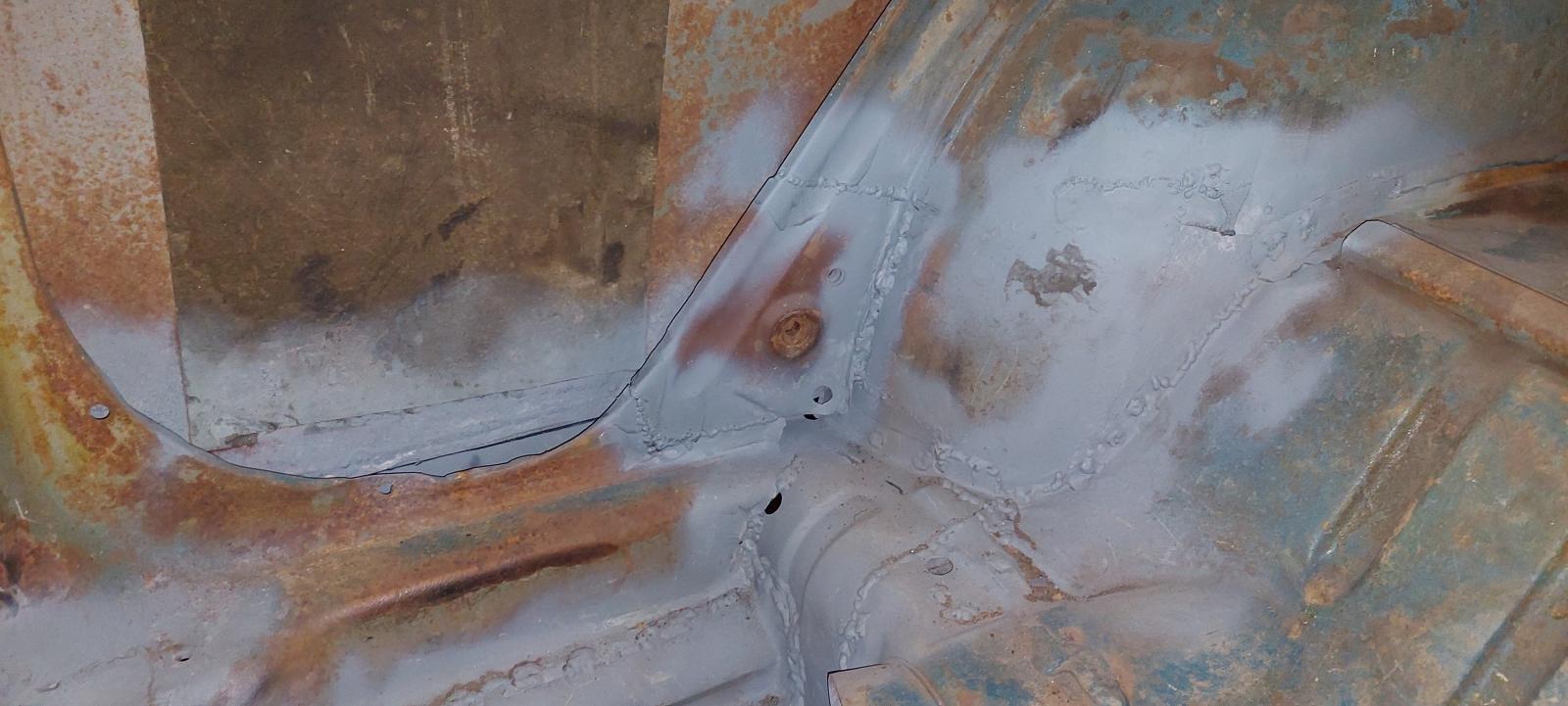

And today some more progress: rear right quarter panel welded in, and first "tuning": I added a lower B pillar plate for seat belt (again re-ise from the old body of my 1303... Junk is good). It had only upper B pillar nut and tunnel nut. When was the 3rd point added? I thought lap belts were from lower B to tunnel.
Disclamer: I am not a pro welder, this is hobby for me and I kind of hate bodywork. So some welds look very nice, some are ugly. I don't build a show car, and I'm not afraid of a little bondo (of course, I try to keep it at a minimum). For example, I never mastered the technique of welding on long lines without metal distortion, even if I weld spots, then fill in on small distances, cool with a wet rag and weld far away next... But for me, it's ok, most important is to have solid welds I can rely on.

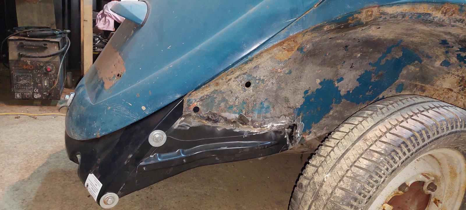

Lower front right panel is in. And some fender nuts welded. Unfortunately I did not find a way to press them in as per factory, and I had to put some spot welds to keep them in place. Right side is almost finished.

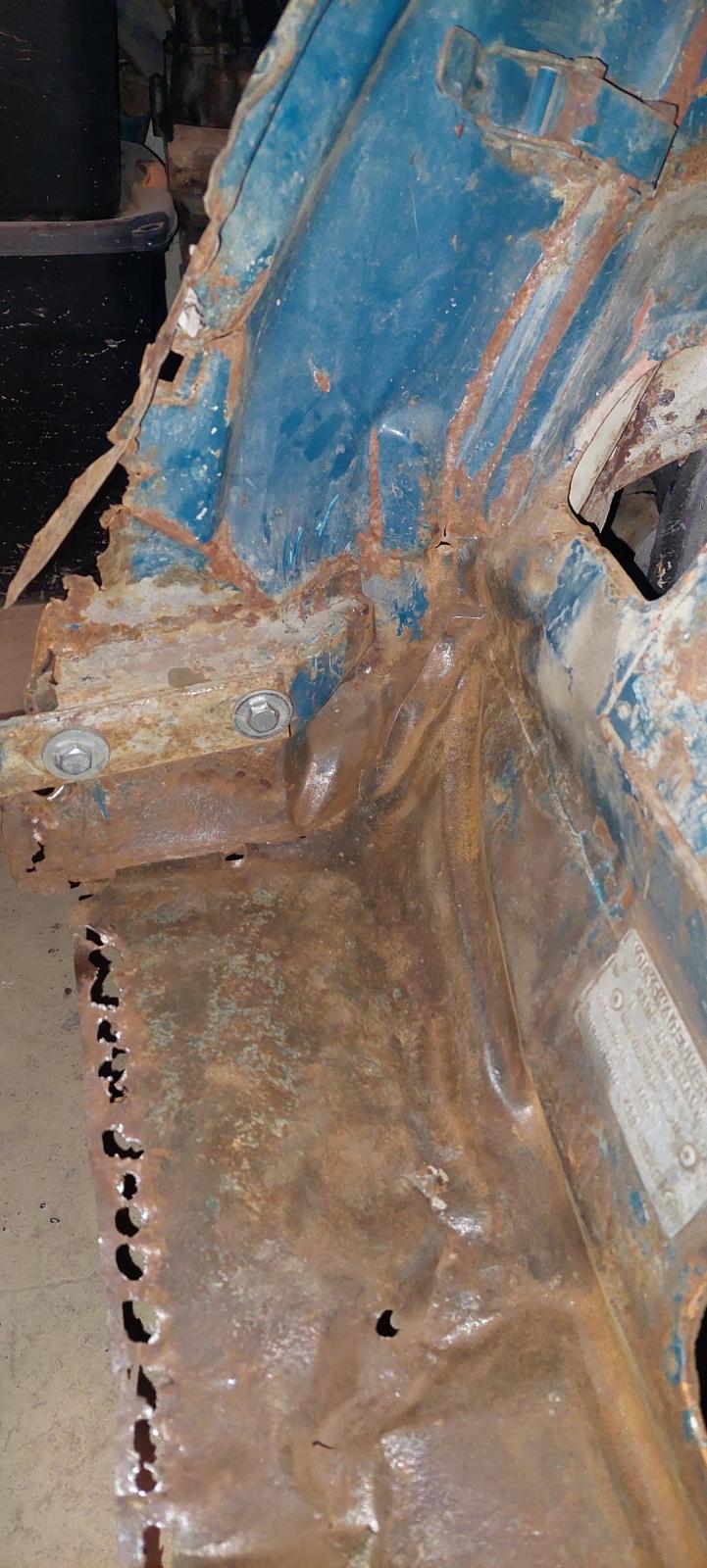

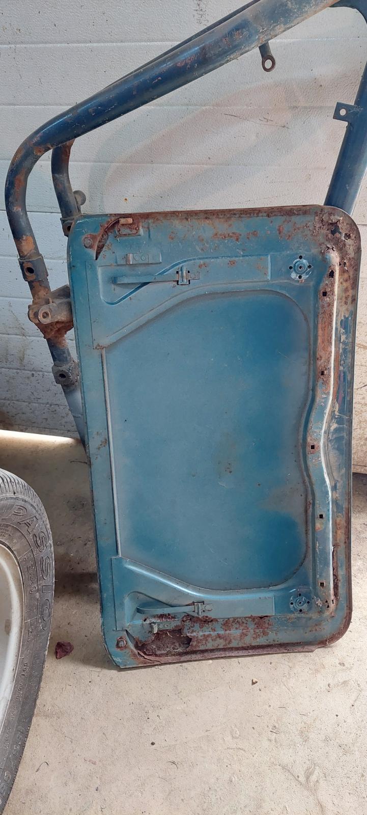

Weekend's work: right side completed, left rotten heater channel out, new heater channel in (but not welded yet), left door down. Heater channel fits very well, same tins to be changed, lower A Pillar I may save, door hinges have huge play... No pics.

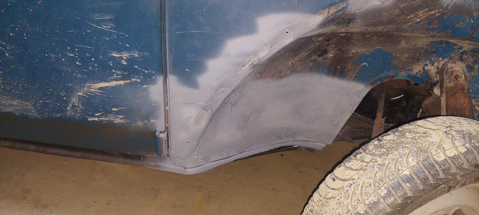

Small progress, I welded the left side rear quarter panel. I trimmed it to a minimum that needed to be cut. Also filled the holes in the rear trunk.

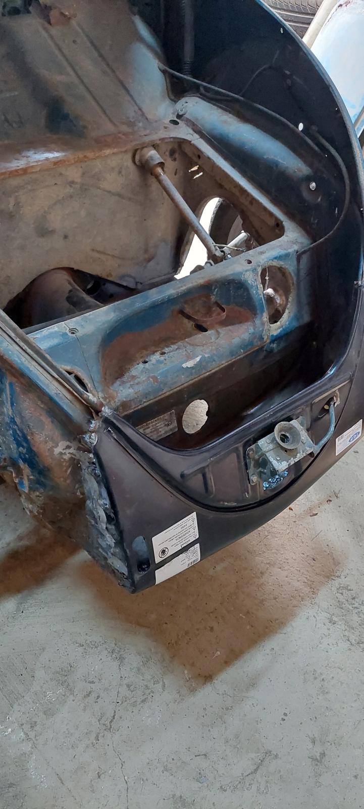

Some more work. Front valance off, and the front was bent on both sides, more on the right side. Fortunately, only the bumper area was affected. So this is my pulling setup: tie the bumper bracket to a solid pillar and push the car back as hard as possible. Then use the BFH while under tension to straighten the steel. Looks pretty good to me, and the measurements are ok from first to last fender nut.

The tin is pretty soft, it was quite easy to pull it back to shape. The rope need to be non-stretching, and quite long to get some momentum. After pushing back 2-3 times, I kept it stretched and used a big hammer to flatten back the tin, then all over again. Small steps so that I do not overstretch. I checked with the front valance at the end and it fit well.
Also a jack between tin and beam can help fine tune the area.
Now, this is not perfect looking, but I am not looking for a show car. I'm satisfied with the result.

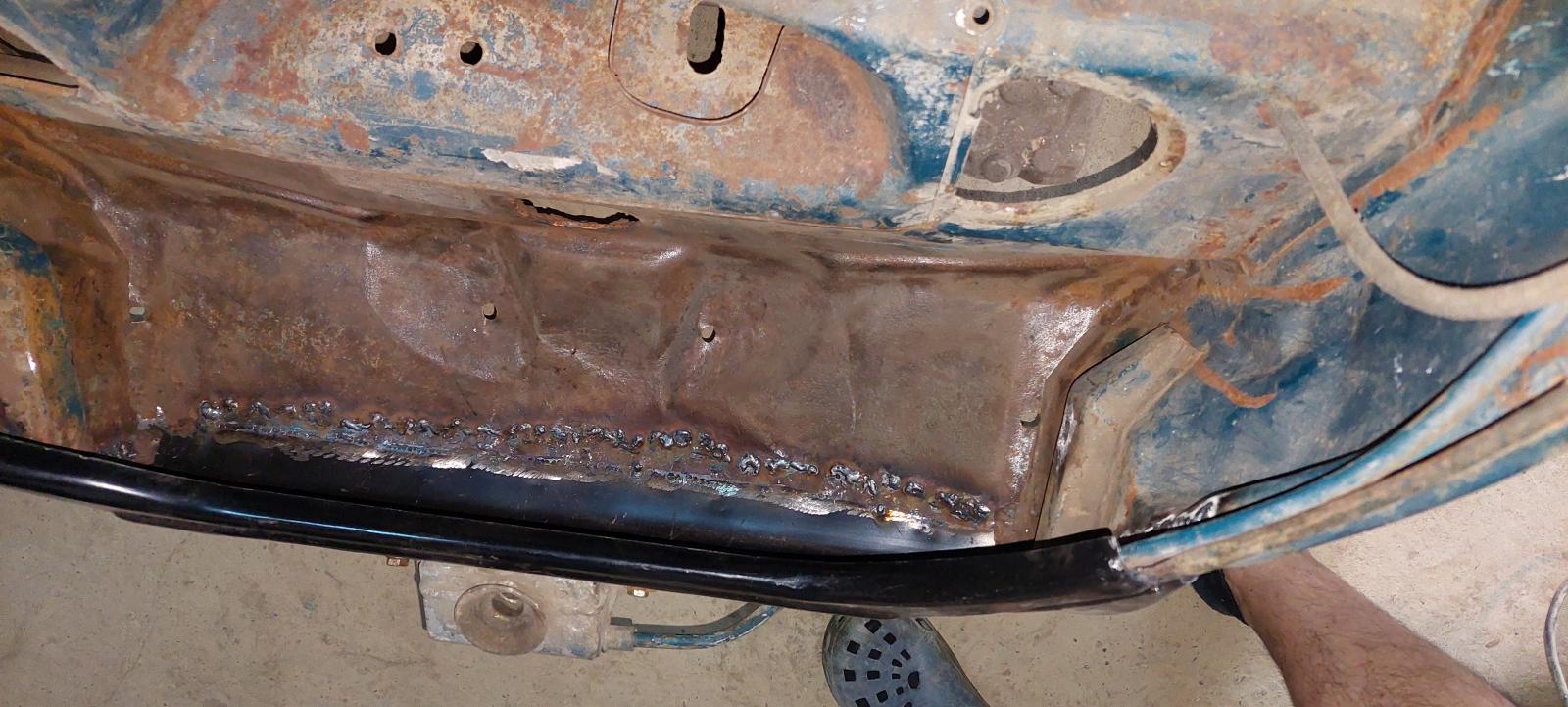

Some more progress in the past week: left side heater channel welded in, lower B pillar seatbelt point installed (still need to smoothen out the area), and I also installed rear 3rd point seatbelt. Again, good that I kept some old junk I could re-use. I did not grind the welds yet, I was too lazy...
