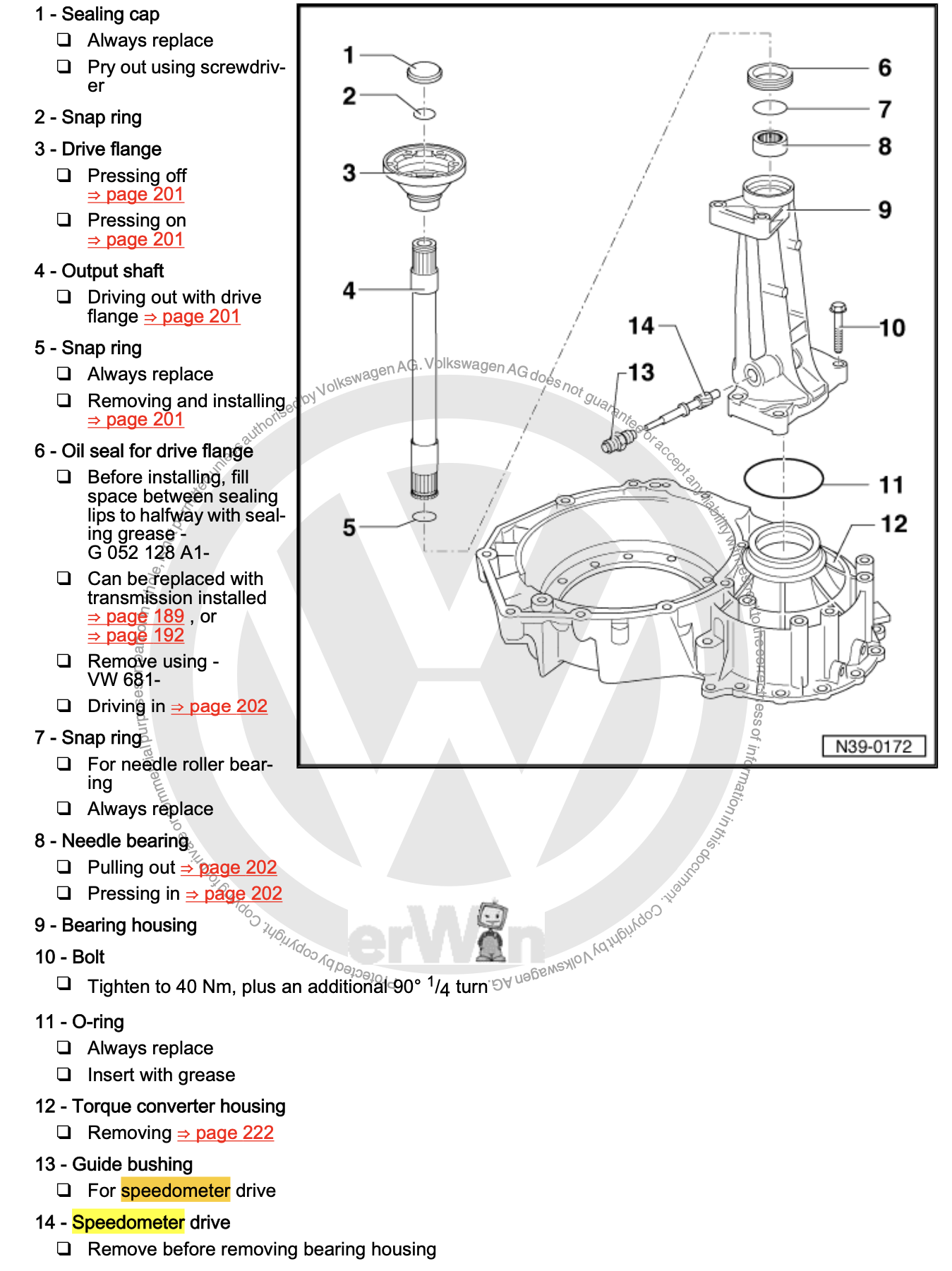

Is this the area you're working on? (see below)
What I've posted below is what Erwin (the only real repair doc for the 01-03 vans) has available.
Kourt

jjvincent: yes, there is a fill plug on the diff (and no drain plug as you indicate). However, on the passenger side of the diff is a “housing” that the speedometer ring and pinion gears reside in. What I’m not sure about is if this housing (and the ring/pinion gears) require lubricant. If so, what kind/how much? Perhaps it is lubricated through the diff?
Kourt: the nomenclature is correct for a 24v VR6 EV. However, the diagram reflects the older style passenger intermediate axle shaft housing. So im not sure if Erwin is providing relevant info.

I was probably on the wrong page. There are several diagrams of different years in Erwin. It's pretty dense and not easy to be confident you have the correct information. If I find something better, I'll post it.
