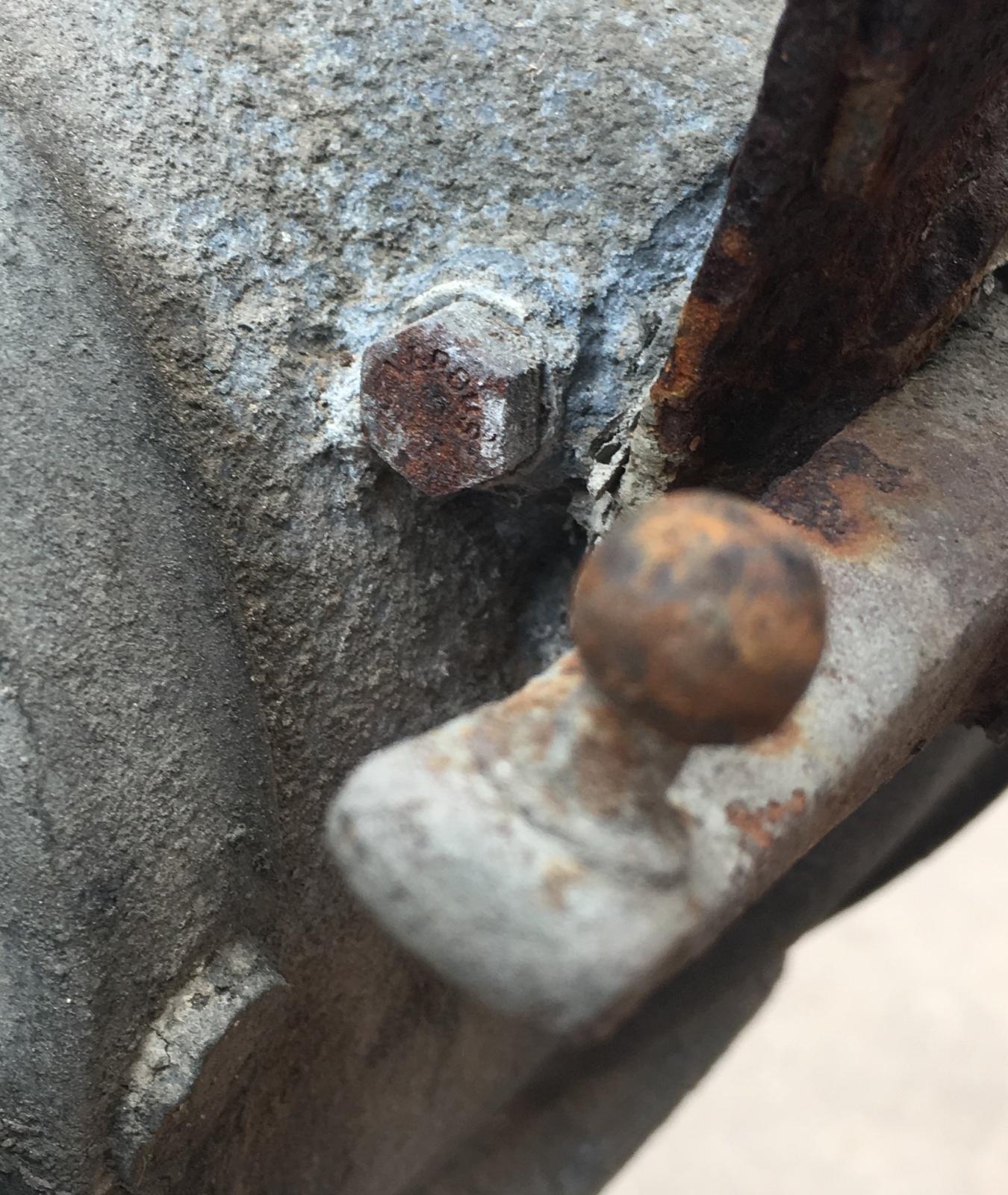

There's actually a greasing hole somewhere behind the lever plugged by a screw. I have found that putting grease inside the hole then screwing it in is a good way to grease just a little but not too much. Picture:
Aha! Yes! That 11 mm head bolt with 1/2 of the threads erased. Nice. Thank you very much for that tip!! Was just wondering if a thin grease needle might get grease into the outer end bushing but I now recall that theres a rubber seal of sorts at each end of the hole in cross shaft hole in the clutch housing. The hole you point to accesses the middle of the inner thicker plastic bushing. At very least I could get some kind of thicker liquid grease in there (maybe chain lube?) which might work its way between the cross shaft and the 3 bushings.

Thanks again Gnarlodious. I removed that bolt and dripped in a mix of grease and chain lube then sprayed chain lube at outside end of thinner plastic bushing at cross shaft. The clutch pedal felt smoother, little to no "shudder" on last 1/2 of push though as I drove the van, I could feel a little bit of that starting again.
I'm pretty certain the noise issue is being created at cross shaft and bushings.
In spraying lube at outside end of the thinner bushing, I could then see play between the cross shaft and that bushing when I pushed up on the cross shaft. There really shouldn't be any play there AFAIK. NOT impressed. I guess new bushings aren't generally installed when a tranny is rebuilt. Rolling Eyes My thinking is that while pushing up on cross shaft, I might be able to push lube in there with a thin needle on grease gun.

IIRC, lubing the clutch operating lever shaft bushings helped. I'm nearly certain that the noise is due to those bushings being worn.
I haven't driven that van a lot lately but again IIRC, it seemed that higher ambient temps, e.g. summer time, and use (more than less), seemed to exacerbate the noise.
Gnarlious' tip about lubing those bushings through the 11 mm head bolt that holds the bushing in place is a good idea IMO.
Bottom line: I'm nearly certain I'll be replacing those bushings sooner than later but if the noise returns, I'll live with it and lube as needed til I drop tranny and replace those bushings.
