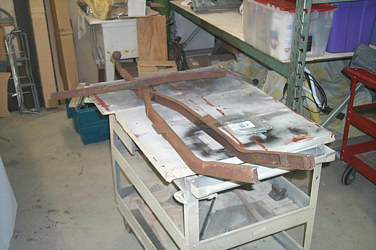

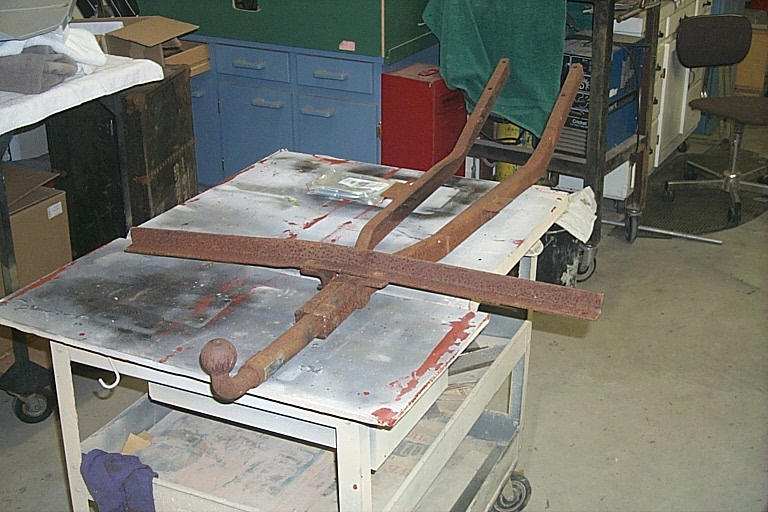

matthew henricks
Joined: January 02, 2002
Posts: 1375
Location: So. Cal
matthew henricks is offline
PostPosted: Sun Mar 26, 2006 4:39 pm    Post subject: Reply with quote
Here are 2 pictures of a Peka hitch i used to own. Does it look like this. ID tag can be seen on the side of one picture. Not sure if angle was original. Definatly was bent and i did not have the outriggers.

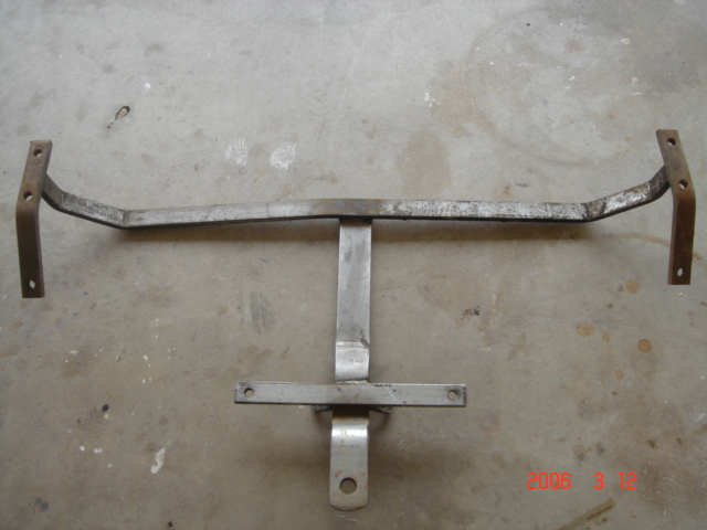

classictint is offline
PostPosted: Sun Mar 26, 2006 11:31 pm    Post subject: hitch.. Reply with quote
heres my hitch.. dont know if its original or not

classictint - I believe that is a VWOA hitch offered by the dealers.

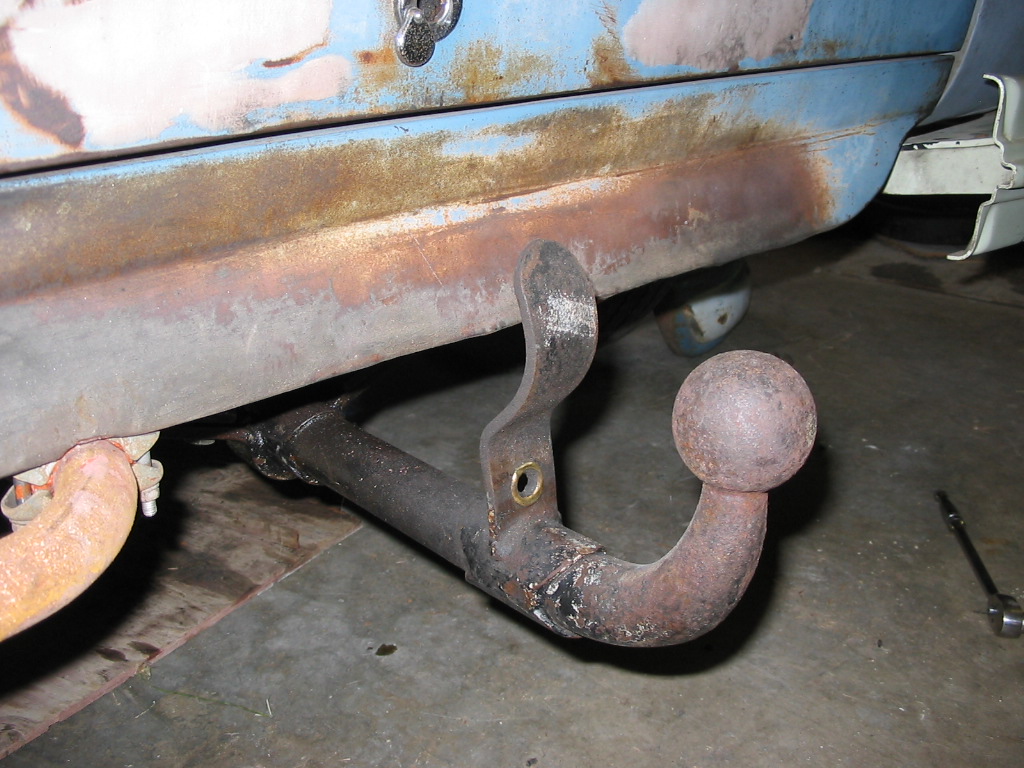

PostPosted: Mon Mar 27, 2006 1:18 pm    Post subject: Reply with quote
This is the one on Greg's post barndoor 55 westy. I posted other pics of it, that I took when the bus was on a lift. Search for "tow and hitch and 55"
