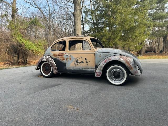

Stance after Dropped Spindles, too high?
63ragtopDud3
Joined: May 21, 2020
Posts: 28
Location: West Virginia
63ragtopDud3 is offline
PostPosted: Fri Mar 08, 2024 7:23 am    Post subject: Stance after Dropped Spindles, too high? Reply with quote
1963 Ragtop
drum brakes
stock beam
2.5" Drop Spindles
145/65-15 smoothies in front
165/80-15 smoothies in rear
1 or 2 outer clicks in rear (cant remember)
KYB 343144 Excel-G Gas Shock front and rear
The car is sitting too high in the front and I feel like the spindles didn't do anything. Not sure if its because I have smaller tires in the front and/or lowered the rear too much? I've been reading about people advising to not use gas shocks. Should I switch to crappy oil shocks? Keep in mind, there's no weight in the front right now (gas tank, seats, spare tire, etc) either, so I know I can close the gap by an inch after everything is said and done. But thats still too high.
I literally just put the body back on, would really hate to replace the beam at this point, but I feel like that's my solution. Not much for the tucked in look, so I'm thinking a 2" narrowed beam w/ adjusters is what I need to close the gap between the tire and fender.

PostPosted: Fri Mar 08, 2024 7:25 am    Post subject: Re: Stance after Dropped Spindles, too high? Reply with quote
Did you install them upside down?
Something is not right. Should look more like this...

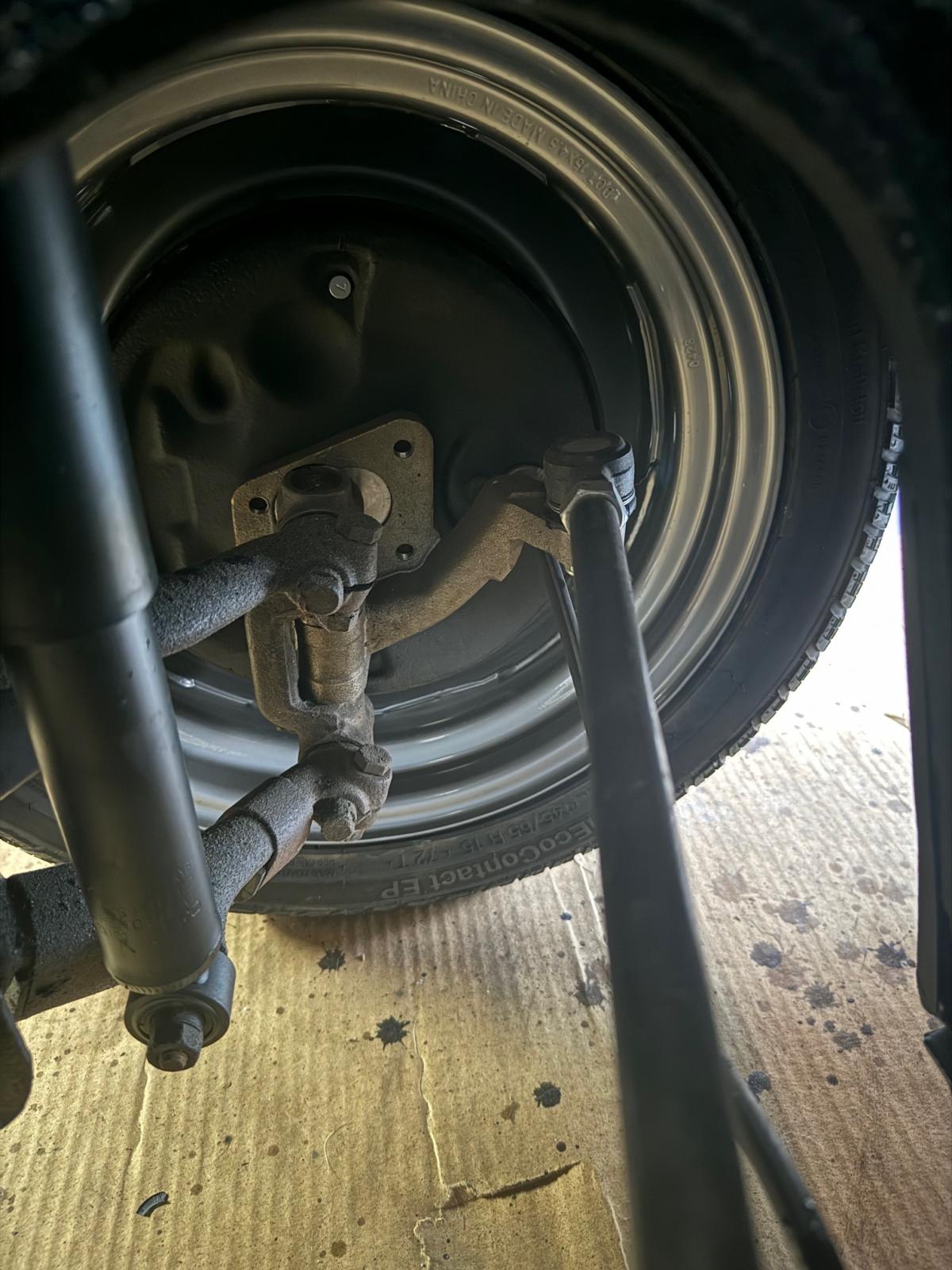

PostPosted: Fri Mar 08, 2024 7:42 am    Post subject: Re: Stance after Dropped Spindles, too high? Reply with quote
Referencing this screenshot from Jbug's installation video, I installed them like this...

Busstom is offline
PostPosted: Fri Mar 08, 2024 8:10 am    Post subject: Re: Stance after Dropped Spindles, too high? Reply with quote
63ragtopDud3 wrote:
Can you post a pic of your spindles for me, please?
Why don't you post pics of your spindles so we can see what's up?

Busstom is offline
PostPosted: Fri Mar 08, 2024 8:17 am    Post subject: Re: Stance after Dropped Spindles, too high? Reply with quote
Damn, they're on correctly...something else going on Confused
Hard to tell without being there, taking some measurements and looking all over. The rear end looks really low, but that doesn't change what's going on up front. Maybe take the shocks off and roll it around to settle it? Bounce on it and see if springs are stuck? But the torsion arms look pretty normal.
Edit: by the way, I just re-read your post and saw your comments on shocks; I think you'll be way more pleased with oil shocks, they're not crappy, and even gas shocks have oil in them, they just ride way harder than OE style shocks.
I don't think that's affecting the ride height much, not that much, but still take 'em off just to troubleshoot right now.

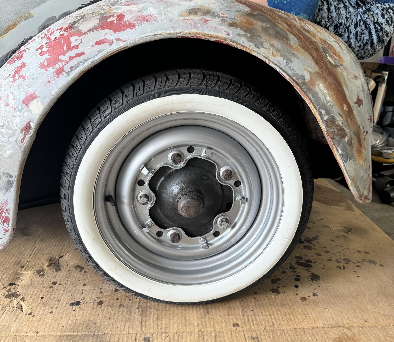

PostPosted: Fri Mar 08, 2024 8:53 am    Post subject: Re: Stance after Dropped Spindles, too high? Reply with quote
Removed the shocks, bounced on the front a good bit. Very springy. Not really any difference though. Still 4" gap between tire and fender.
No gap between the frame and napoleon hat. All body bolts are fastened.
Maybe I screwed something up when I took off the torsion arms off to replace the seal? But if I recall, there was really only one way to put them back on.

PostPosted: Fri Mar 08, 2024 11:01 am    Post subject: Re: Stance after Dropped Spindles, too high? Reply with quote
Yes, bumper stops are still in place. If I sit on the front of the car (my whole 175 pounds), the car drops a couple inches and the wheel also looks as though it is more center with the well.
Maybe you are right missing all that extra weight in the front.
